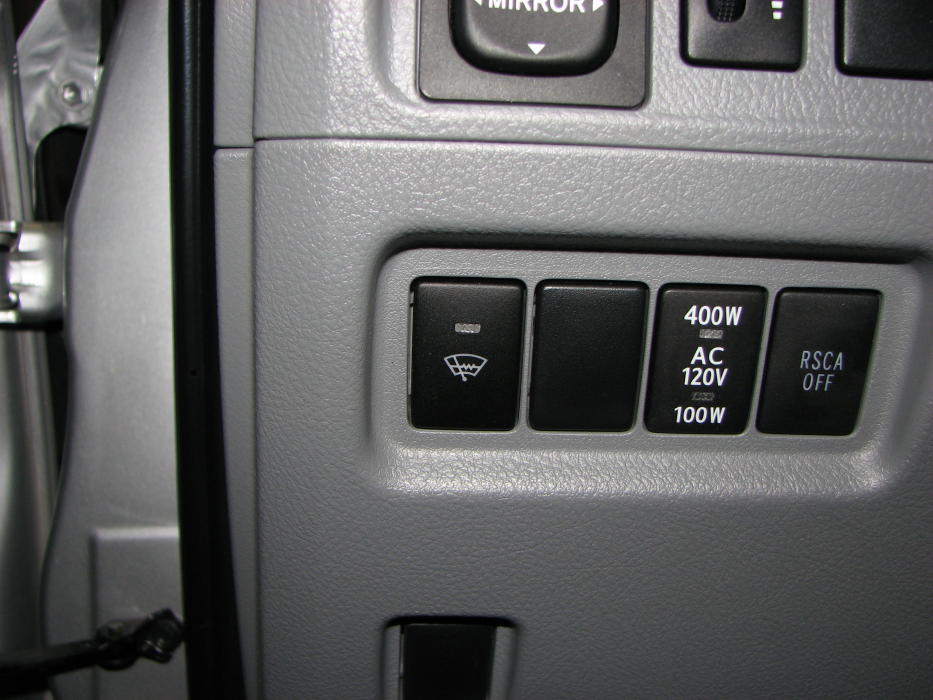

Hmm.. I am not sure. Mine is the TE with both KDSS and NAV. How do I know if I have the de-icer option?
I just checked the manual and my TE, it do have the windshield wiper de-icer.

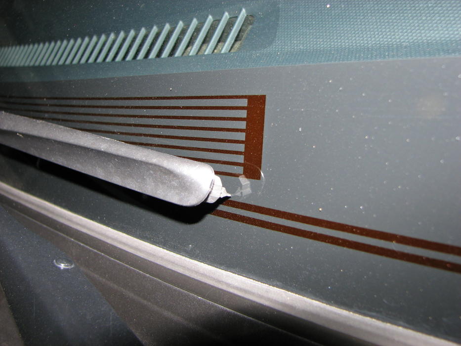

Yep, you're wrong.:)
...and I wouldn't trust the manual either.
Look for this on your windshield and lower left dash.
