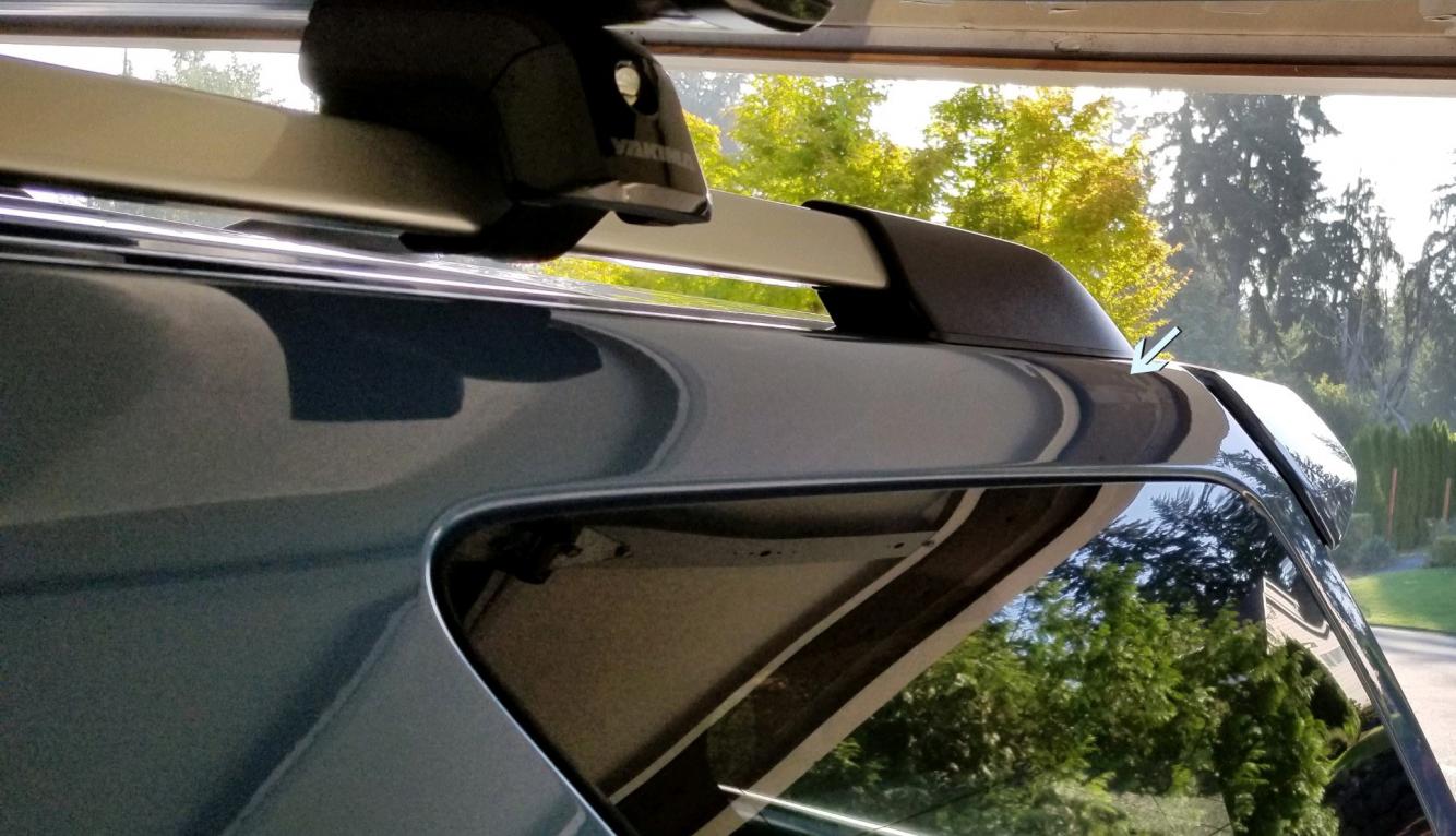

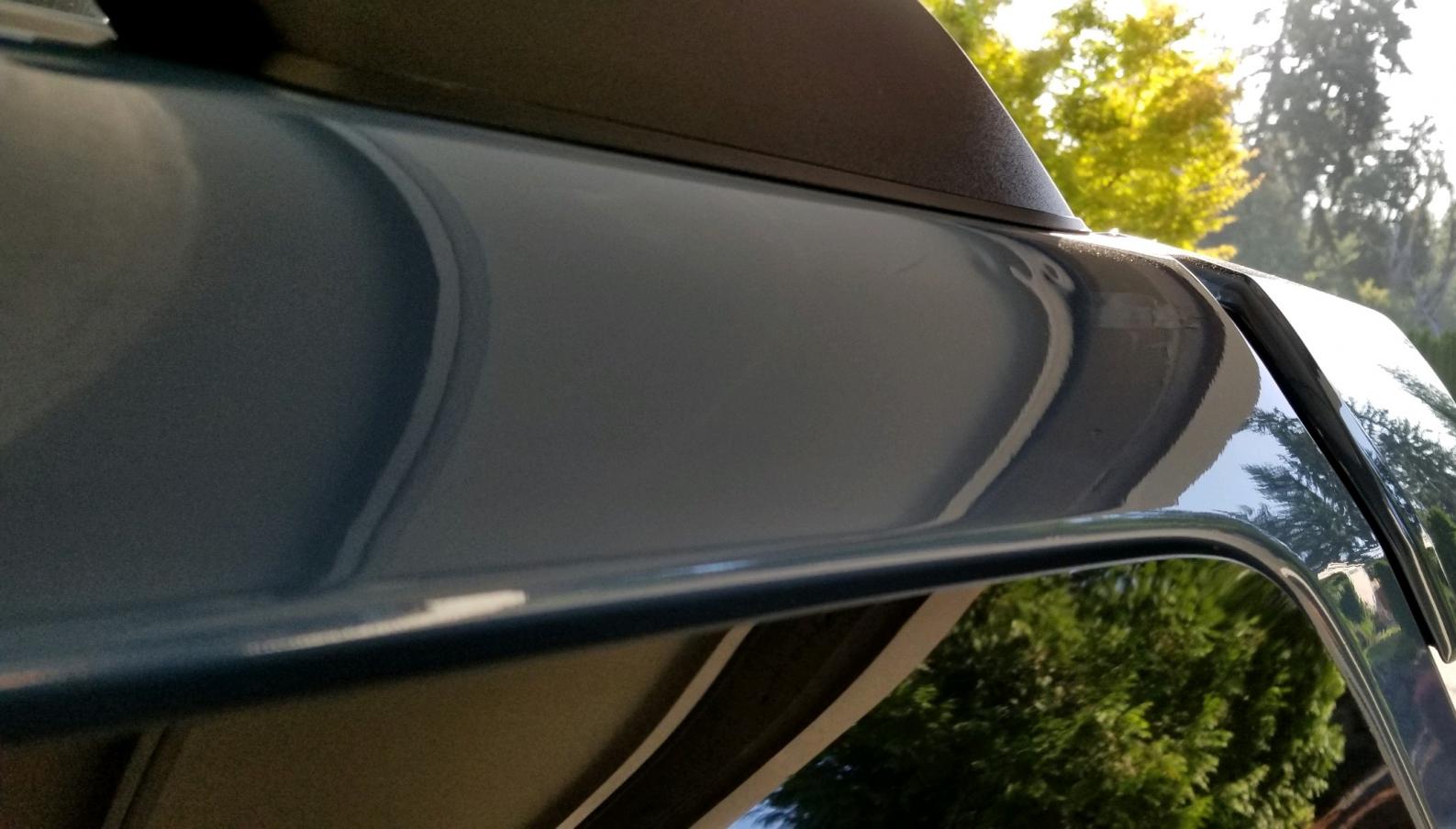

Noticed mystery dimples in body sheet metal underneath roof rack rear anchor point on both sides of rig in same spot. Pictures are best capture I could get because these are barely noticeable only at certain angle in certain light. I noticed them when detailing it this weekend but have no idea what they're from or how long they've been there. Weird thing is they aren't a single dent which could be caused by something tapping it but rather three dimples in a line and other side has two. Wonder if somehow this could be caused by torque stress grabbing onto rear of roof rack which I often do when climbing up to access the roof or clean it like this weekend. Anyone else see something like this?

Probably from prying up on the roof rail black plastic end caps when removing them.
Mystery solved. It's just been forever since I took those off to ditch the worthless OE crossbars totally forgot I did that. I'm sure you're right. Which brings me back to the flimsy sheet metal question. When I did that I used a plastic pry tool with a cloth underneath. Really, it's that prone to flexing?

Yeah, some guy on youtube removed his caps on his voodoo blue TRD Pro and bam, instantly dented his brand new 4runner lol should put something hard underneath the trim tool while removing the cap to protect the metal.

The sheet metal on these trucks is extremely thin and soft, especially along that roof line ridge. Removing the feet of the factory rack can create dents rather easily, saw it happen with my very eyes when installing my buddies Prinsu.
