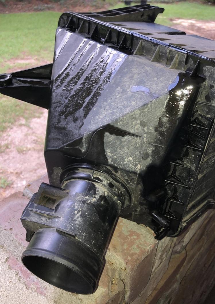

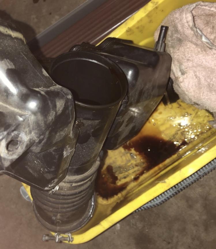

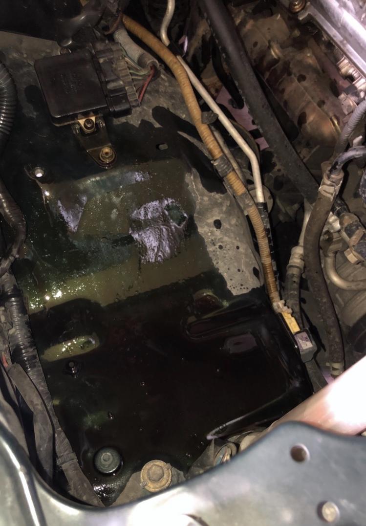

Found the problem but don't know how to fix it. Somehow all my oil ended up in my air intake?! Took it off and it was all over the mass flow sensor, and inside my intake hoses. Turned the intake upside down and at least half a quart drained out. Cleaned it all up, and took a look at the spark plugs to see if any oil was getting past the piston rings, luckily they were fine, ended up replacing them anyways. i'll probably change the pcv pipe as well, but i'm just going by process of elimination at this point i really am at a loss for words, any advice is greatly appriciated. Here's some pics of the intake attached.

As far as I know, about the only way oil gets from the crankcase into the intake is via the PCV system, which allows crankcase pressure (blowby from the piston rings) to vent out of the valve covers, into tubing, and into the intake system, so the engine can burn it. For a MASSIVE amount of oil to go through the system I think it means that (and there are plenty of other possibilities):
- there is a LOT of blow-by - so much that it is interfering with the oils ability to drain from the valve cover area back into the block, and it eventually starts flowing out of the vents into the intake. This is supposed to be a fairly modest amount of air going that way.
- there is something blocking up the drains in the head that allow oil (from the valve train lubrication) to drain back into the block, and it builds up until the covers are 'full' and oil goes directly into the intake, intead of crankcase fumes. Gunk, or sealer, or... who knows what?

You are somehow WAY overfilled on oil. The oil in the intake has been frothed by the crank and pushed out the crankcase ventilation system.
Don't drive the truck until you have this figured out. Drain the oil and see how much comes out... I think you will find you have a bunch of extra oil in there...

Like others said, the only way it can end up in your intake is through the PCV valve or the breather valve on the back of the driver's side valve cover. The only way it can come out of the PCV is if there's so much oil in there it filled up the cylinder heads with either froth or just straight oil. So you most definitely did not run out of oil, you would not have seen a drop in your intake.
Check to make sure the dipstick tube did not find a way out. It's only held in place with one 10mm bolt. If you shine a flashlight near the bottom of the engine block you'll see where the tube goes in, make sure the o-ring is seated completely.

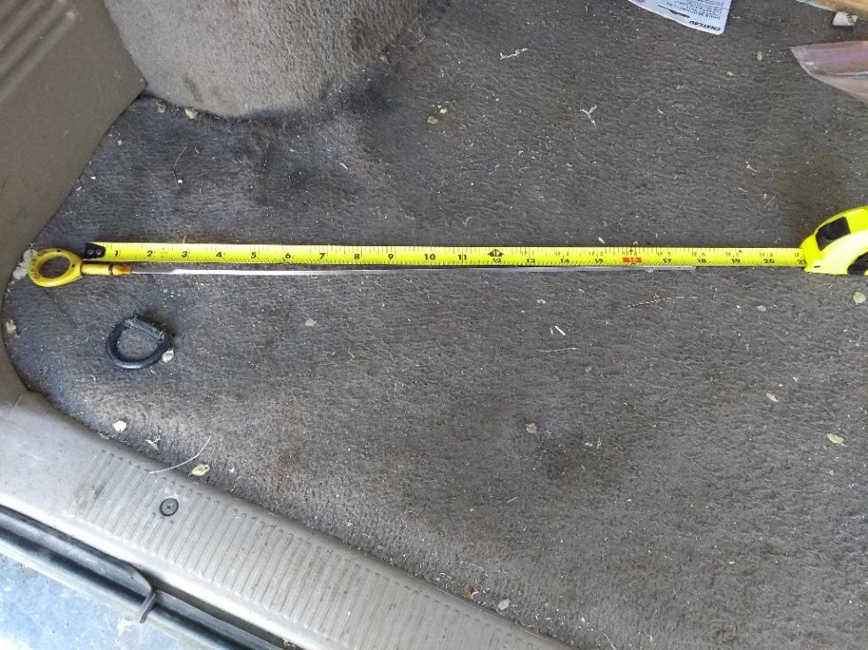

Did you have the oil changed somewhere? I wonder if it's possible that they inadvertently swapped dipsticks on you. Maybe try measuring the length from where it sits on the top of the tube to the 'full' line. I'm sure someone could measure a 'proper' one to see if that's the culprit.
Here you go. 17.75" from where it rests in the tube to the end.
The low mark is .5" from the end and the full mark is 1.25" from the end.
