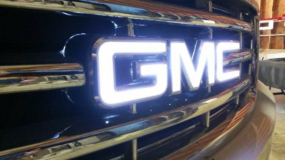

Has anyone thought about fabricating some sort of Glowing TOYOTA logo for the mesh grill using LED strips?
No, but I am considering trying some small round LED lights Walmart sells on the inside walls of my grill that would illuminate the Toyota logo the same way logo lights do on airliners. Logo lights are mounted on the wings or horizontal stabilizers and shine up onto the tail.
Led badge
Something like this but with the words TOYOTA would be pretty sweet.

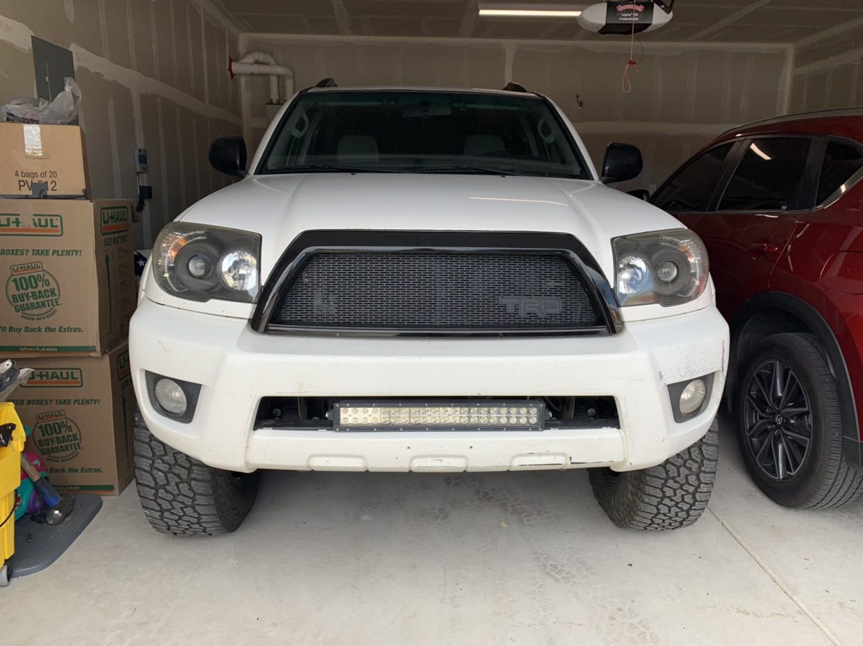

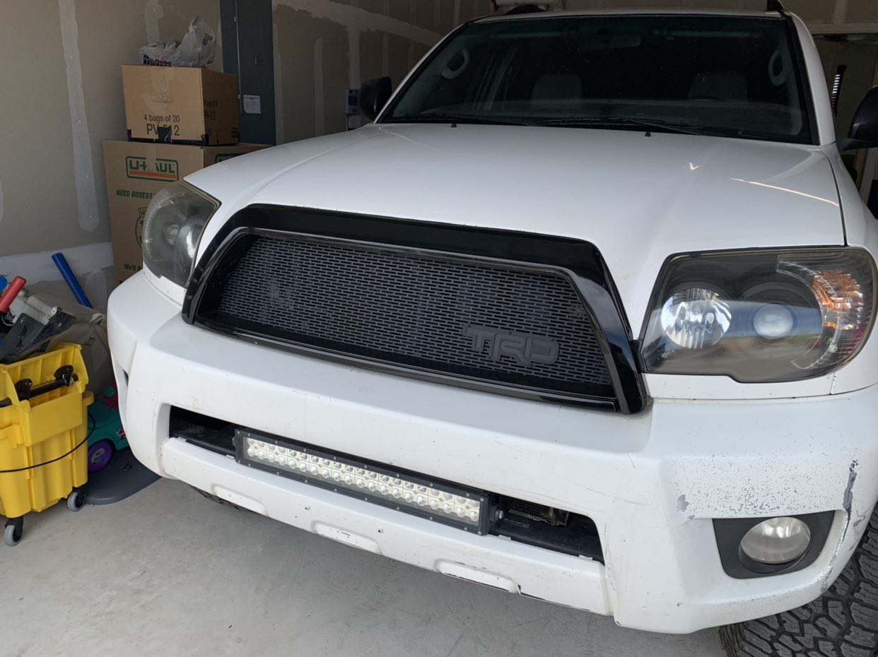

I almost got the raptor style lettering but decided to get the “TRD plate”. Thanks for the reference to customcargrills, made it very easy!IMG_1616.jpgIMG_1617.jpg
