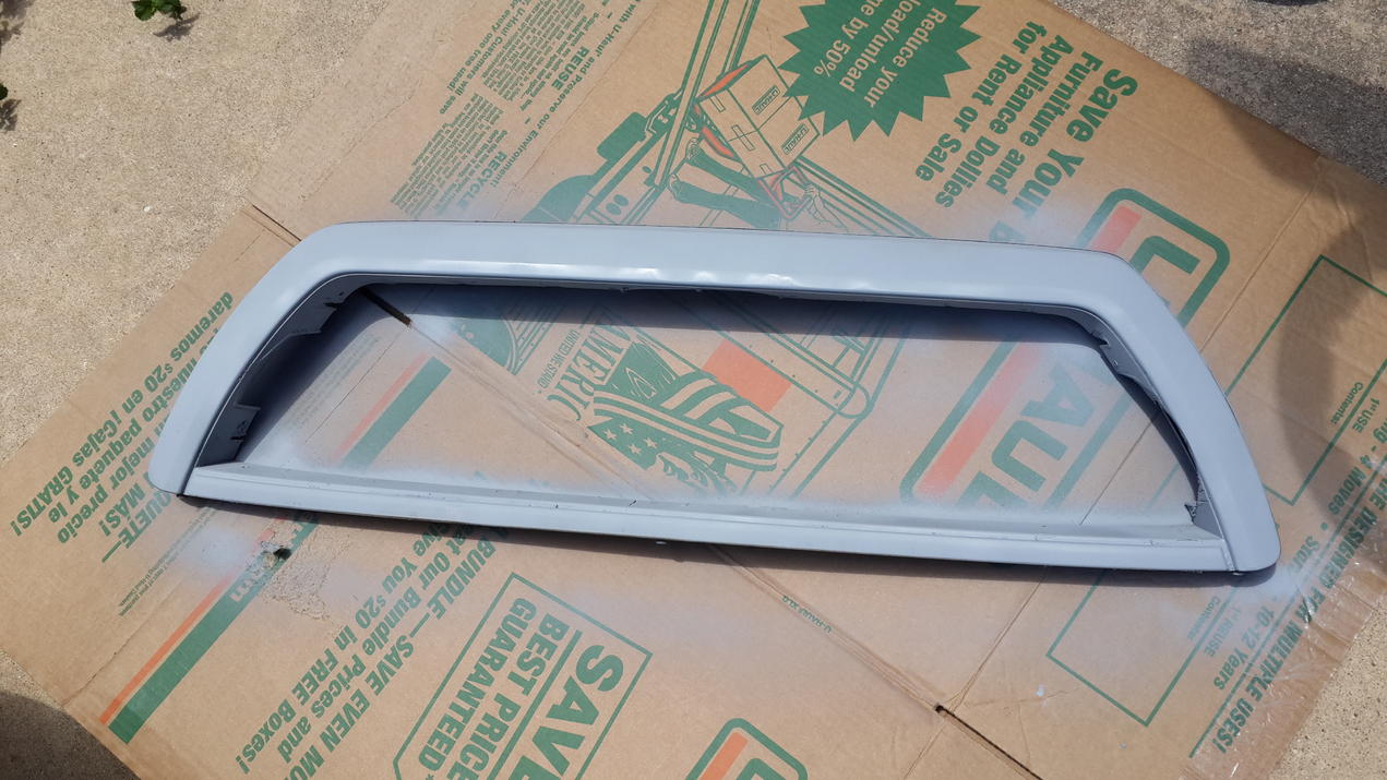

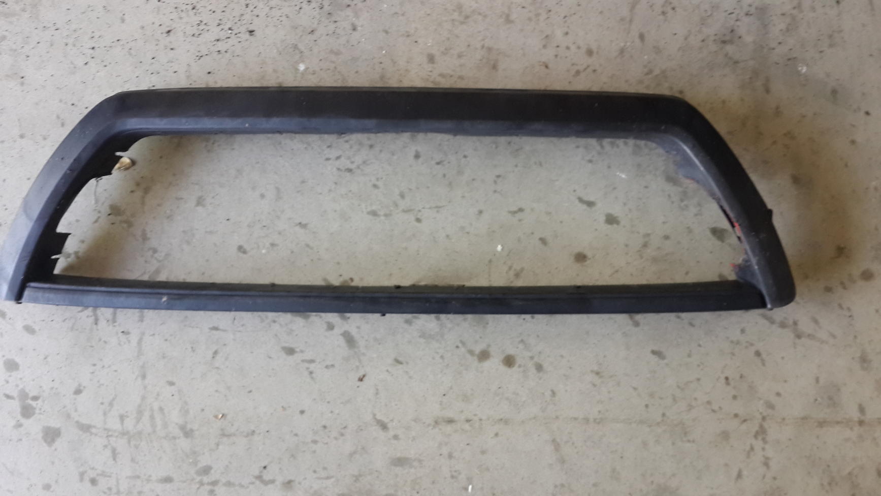

I have been looking at 4R's with satoshi mod and wanted to do it.
So here is my attempt. I know I can do better with finishes, but I think for the most part it came out fine.

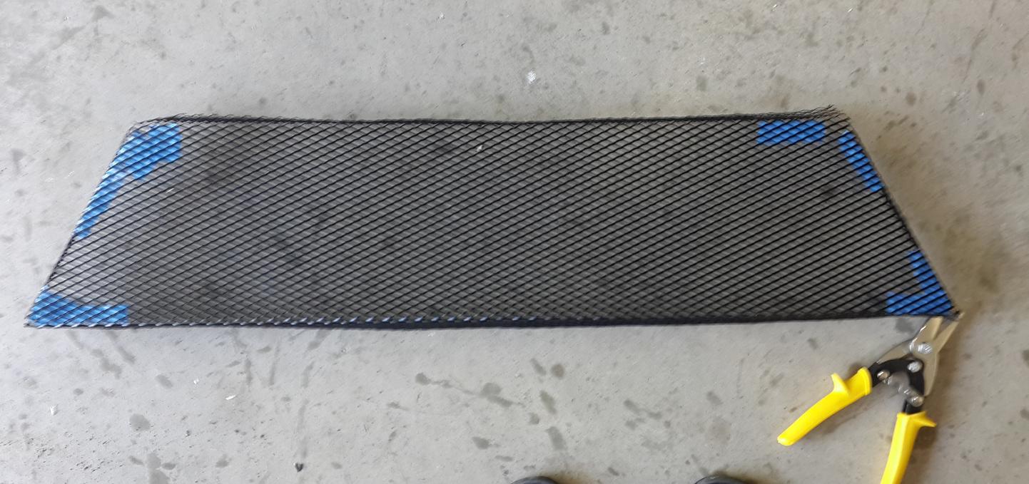

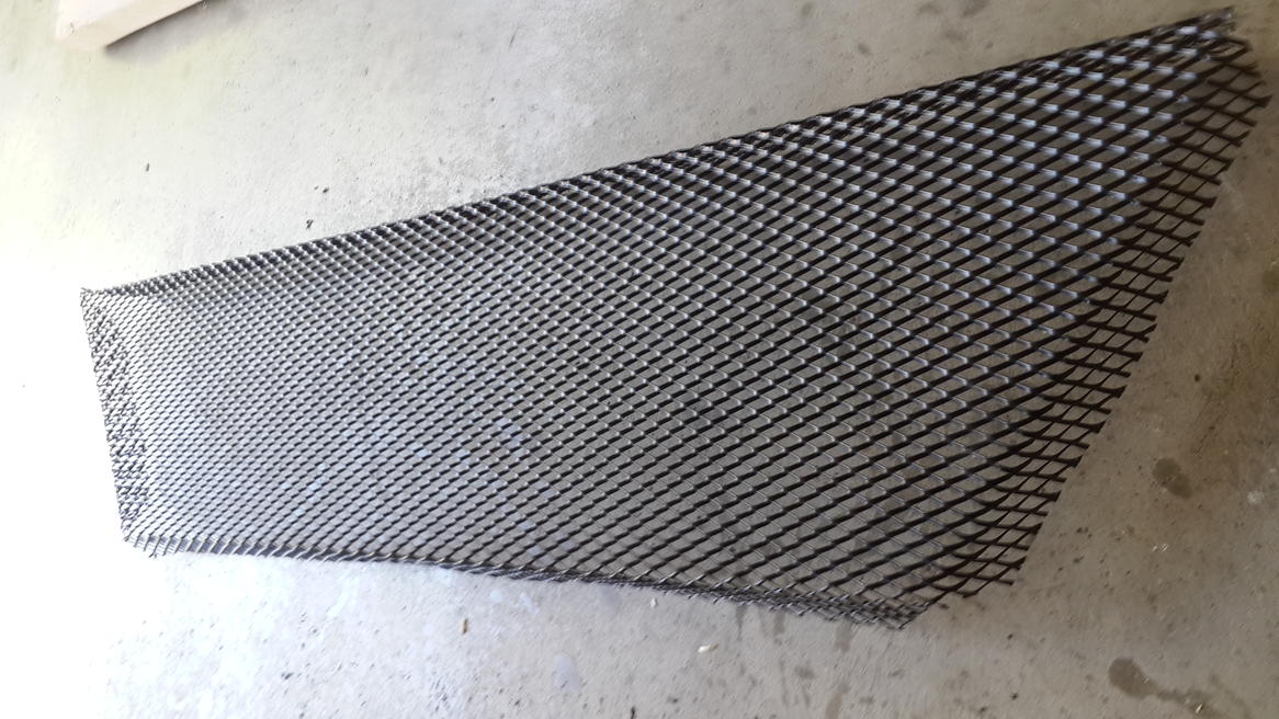

I got my Diamond Mesh Grill from ebay 12"x48" for $29
I started with taking off the grill
Center dremmelled out
Traced the grill opening by placing it over the mesh..a little wiggling is required account for the curve in the grill
Then cut the grill with tin snip and bend. I used 2x4 for bending

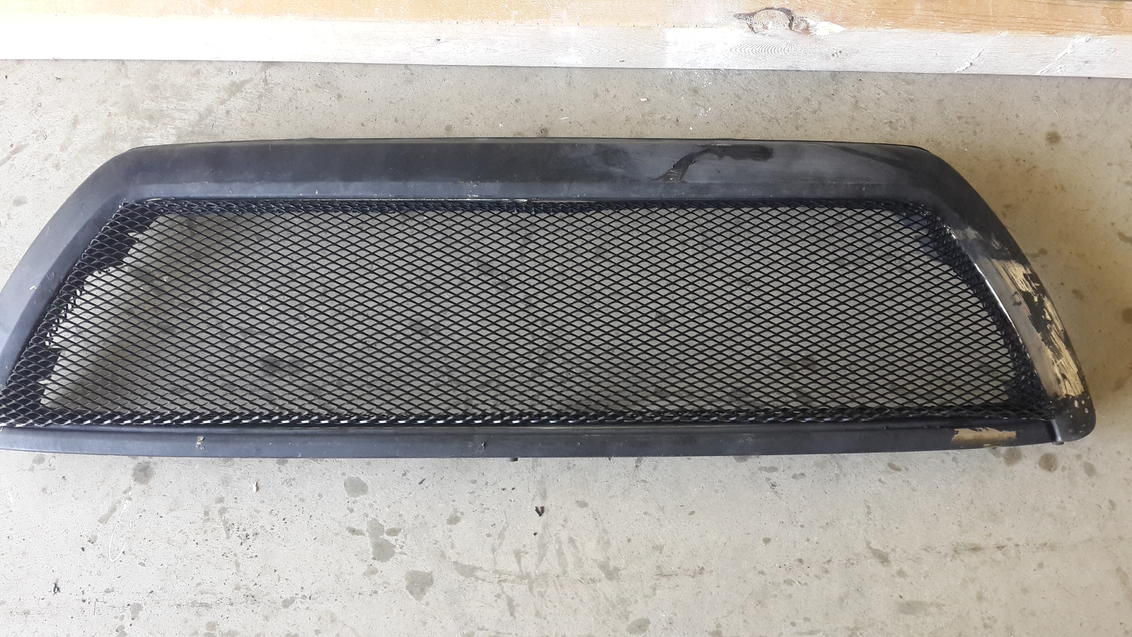

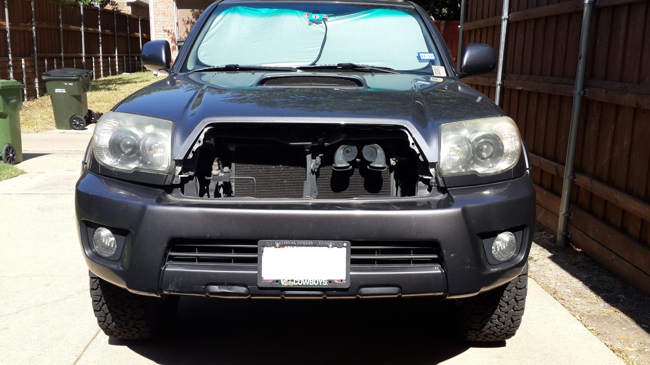

Dry fitting...I am trying remove plasti-dip starting from right side..it was pain-in-the-tush. I had to use sander with 150 grade sheet
All cleaned up and primered

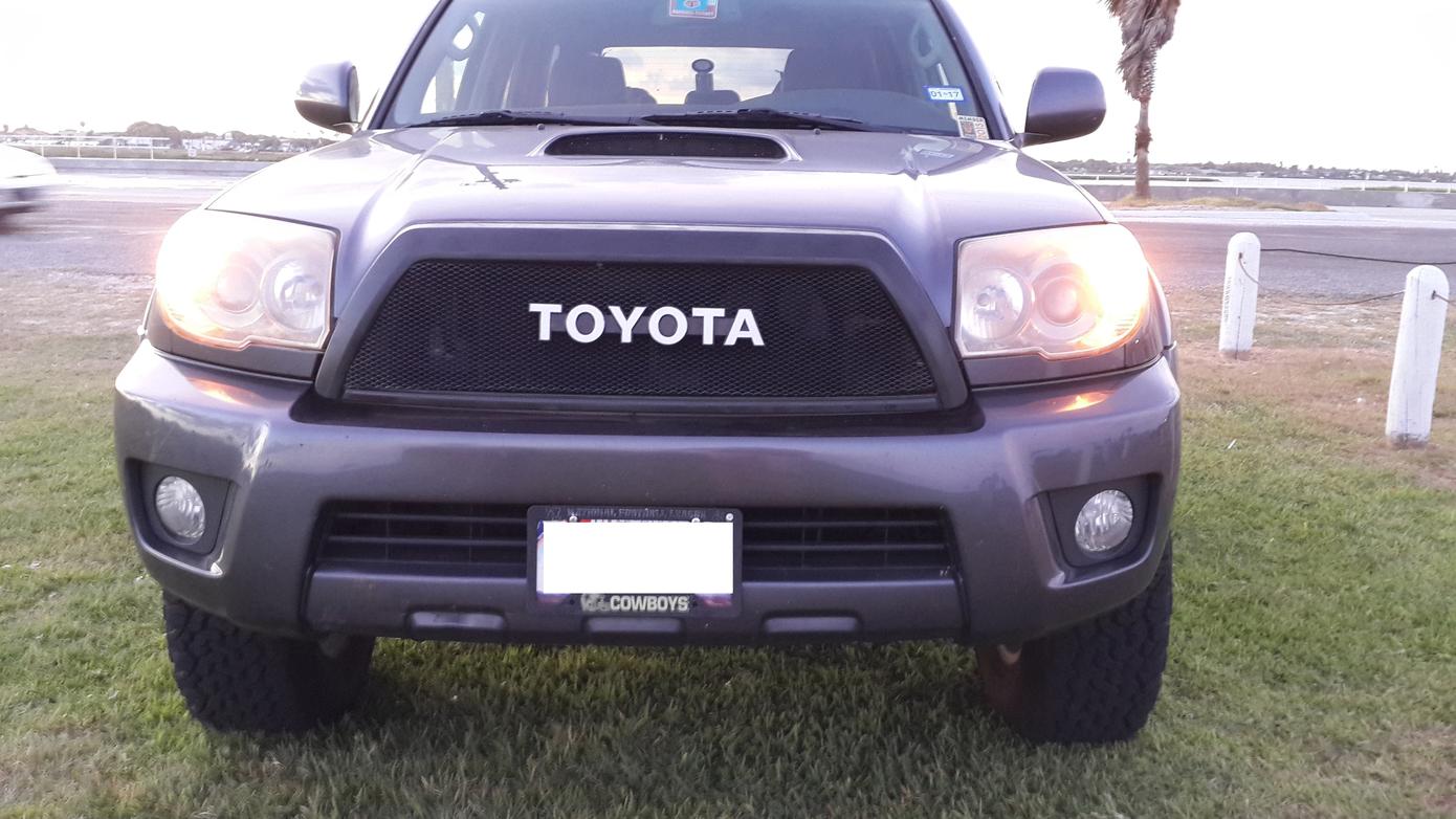

Another dry fit, needs some stretching and bending and TOYOTA logo

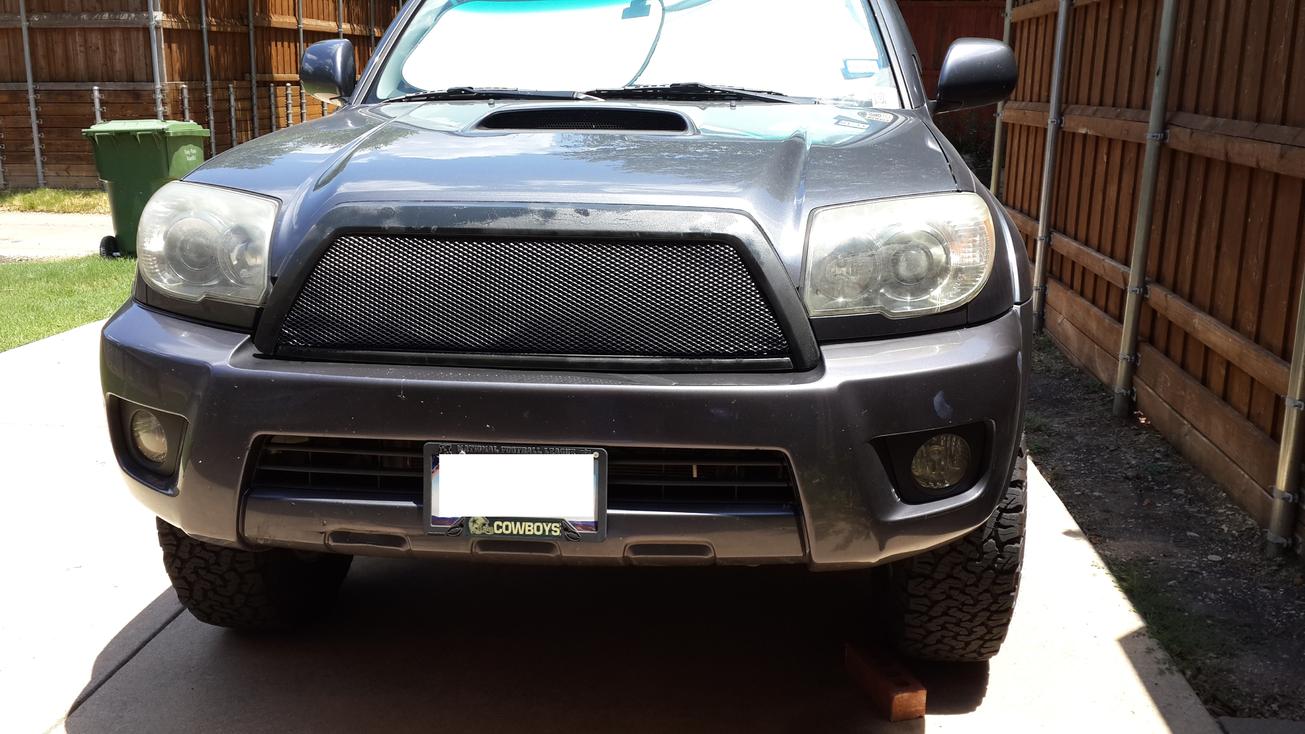

All finished up

Congrats.....it came out nice.
I picked up a grill.....I just need to order the mesh and Ill be making one as well.

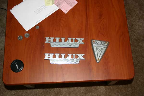

Has anyone done one of these grill mods with a hilux surf badge instead of the toyota?
I was thinking about one of these hilux badges if I can get my hands on one. What do yall think?

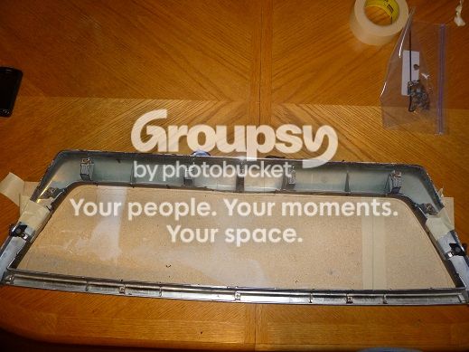

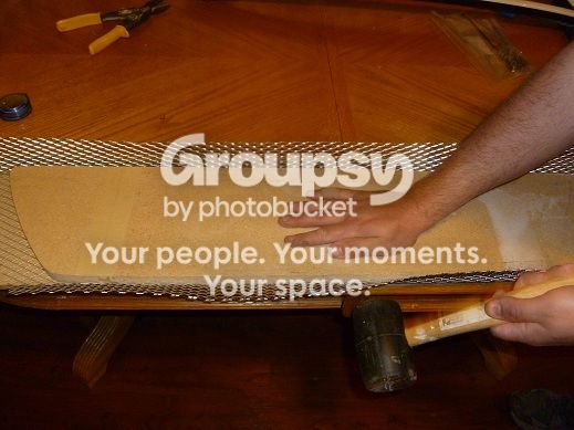

It would be nice if someone did, for sure. It would be a piece of cake (relatively speaking) if the plastic inner grid was removable without cutting. The only way it would make sense to make and sell these would be to do the flush style (like the OP did). I did the "deep" version and there's little chance IMO of anyone doing the filling, sanding, and painting efficiently enough to make one for a reasonable cost. (For more on deep vs. flush, see my thread.)
Check out @Mytoy4's thread. What she did was genius IMO. She used the grill opening as a template to cut a wood form for shaping the mesh before installation.

Makes great sense and if someone had one of those to use with every grill they made, it just might be worth their while to make and sell them. I asked Terri and unfortunately, she discarded the form after doing her grill.
