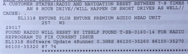

Hi all! I have read more than a couple of threads on this topic. Mine is on 2014 Limited. Last occurrence was probably 8-11 times in my 10 hour drive from VA to Boston. Worst was I hangs right when I was crossing the Nj-NY through George Washington bridge where there's like 12 different directions to exit! Good thing I had my phone nav to back me up.
Anyway, I took the 4Runner to local Toyota service and although they said they don't have an official TSB that addresses the problem they uploaded a new software update. When I look at the receipt, it has the "T-SB" designation on it. Ill post the picture of the software update receipt so everyone can see and maybe use it when you talk to your local service centers for fix.
So far I used the Nav/Radio today after the update on my 60 mie roundtrip to work and no problems. I will update this threads if theres any re occurrence of the problem.

Took it to dealer she bought it from today and showed them a printed copy of T-SB-0160-14. Service adviser said this was common. I was glad to not hear "we've never heard of this problem before".
Afterwards I read the invoice. Text said "Needs software update-TSB0006-14". Operation Code EL1318. According to T-SB-0160-14 - T-SB-0006-14 is obsolete and replaced by T-SB-0160-14.
I called the service dept. and spoke with the service adviser. He said that the text brought up by the OPCode had not been changed.
I'll let it go for now as I have no reason to disbelieve him. Seems like Techstream would provide a superseding patch if one were available.
The radio worked during the 30+ mile drive home. Too early to tell as this has been a sporadic issue.
