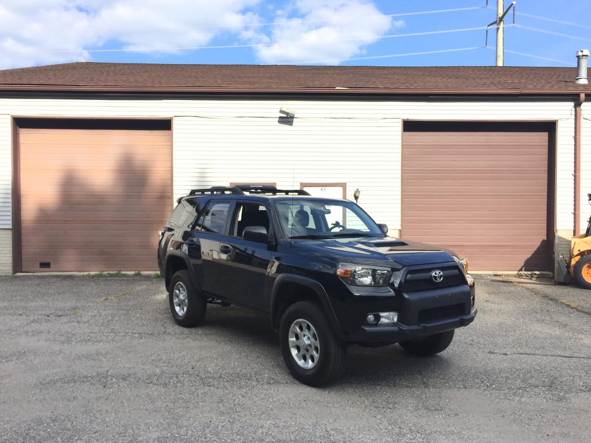

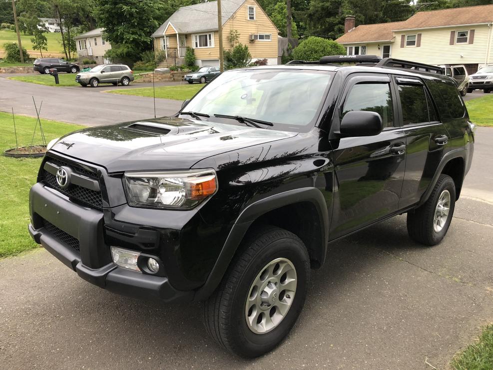

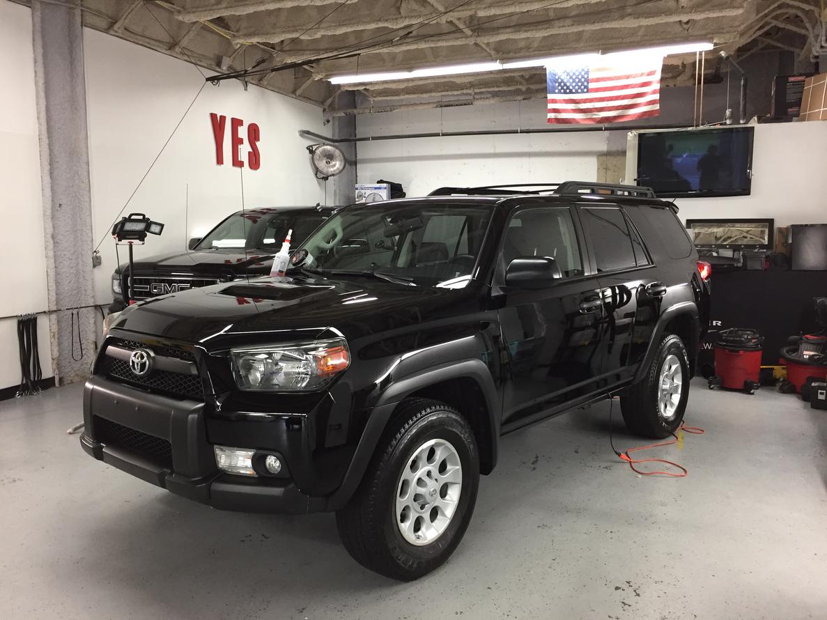

Here she is the day I found her (next to my old tacoma)

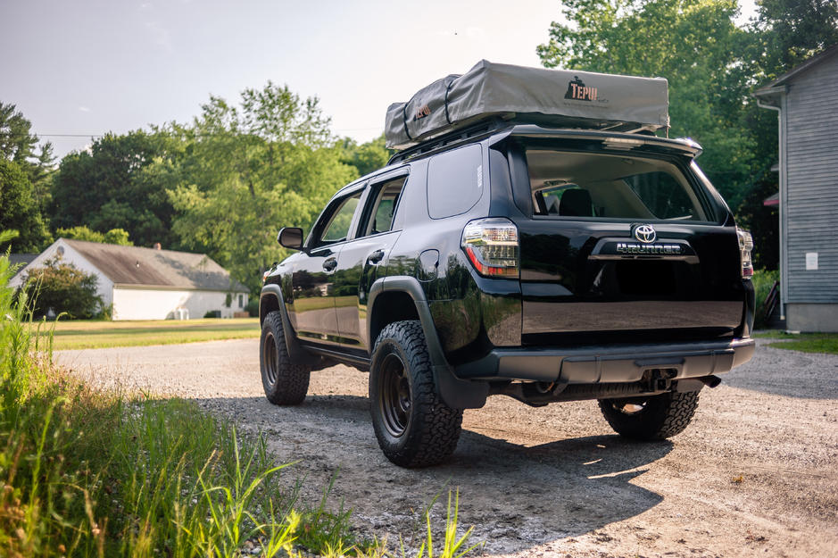

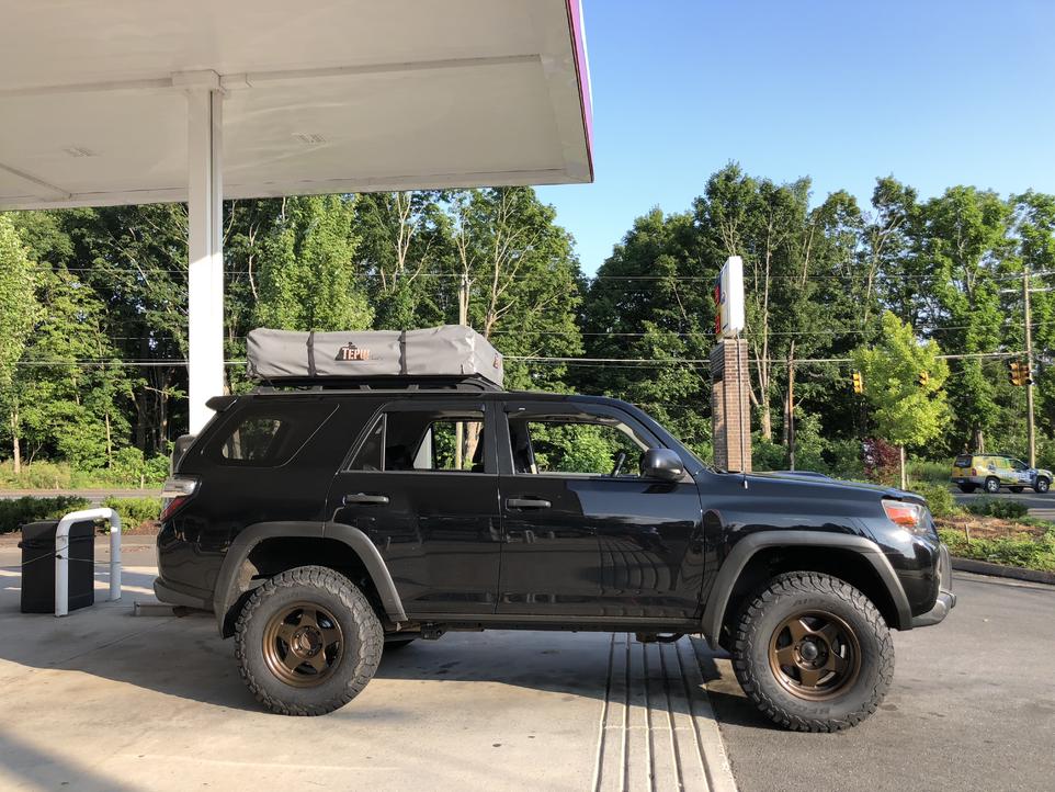

This truck is hopefully going to see a lot of long adventuring. Three days after taking her home I took her on a 3,000 mile road trip to FL. Here she is at one of our stops with my Tepui Kukenam roof-top tent!

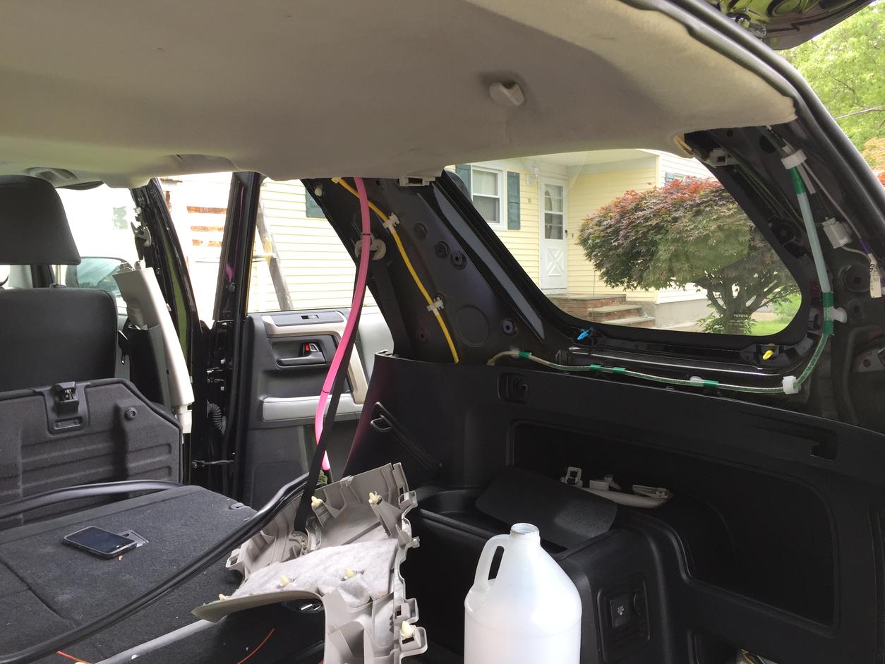

On our way back from the trip I noticed water dripping down from the rear seatbelt slots and a slightly wet headliner (where the C-Pillar meets the headliner). I decided to take apart some of the interior pieces to find out what was leaking. As it turns out the REAR sunroof drain tubes were completely disconnected.. I was only able to verify this by closing the sunroof completely then pouring water on the roof. While I was there I checked the front drains of which the driver side needed a little cleaning.
I managed to reconnect the rear tubes and clamped them down to prevent them from sliding off in the future.
Love the roof top tent. Good thing you caught the leak right away. What was involved in pulling off that interior panel?
Thank you! It really wasn't bad especially with two people involved. Lower trunk side panels come off first (one 10mm bolt hidden behind a small cover) then the top panels come off. Then the front and rear door seals need to get pulled back (top half). Then the lower and upper B pillar side panels come off (another 10mm bolt on the lower B pillar side panel). From there you may want to lower the center ceiling light in order to pull the headliner down a little. From THERE you have access to both side drain tubes!
Like I said it's a lot easier then it sounds. Have a buddy help in case you get stuck! Took us 45mins-1hr to take apart, fix, and reassemble!

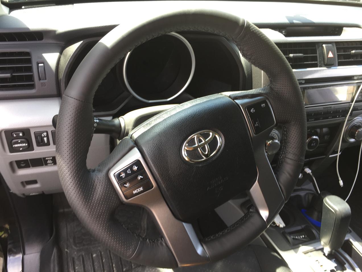

Finished up the leather steering wheel cover/wrap install. Took me about 7-8 hours :doh: :faint:
Also performed an oil & filter change at 76k

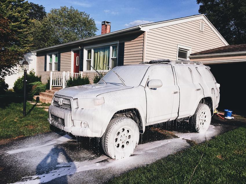

Truck got a full detail today. Still can't believe how well it came out. Interior, exterior, and engine bay.

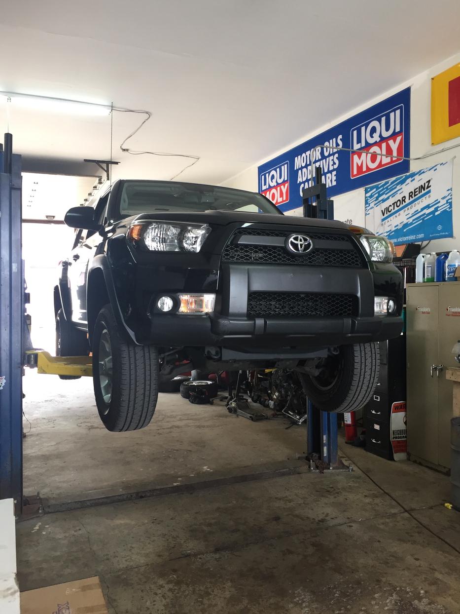

Service day @81k!
-Mobil 1 0-20w
-Tire rotation
-Front & rear differential, transfercase fluid change

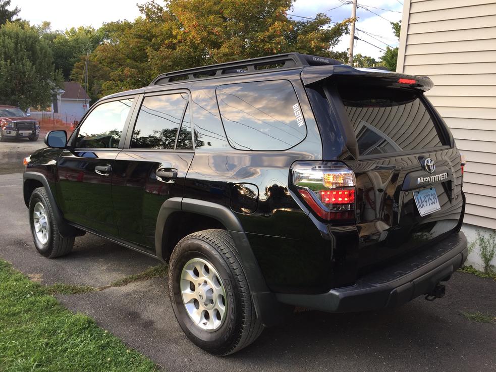

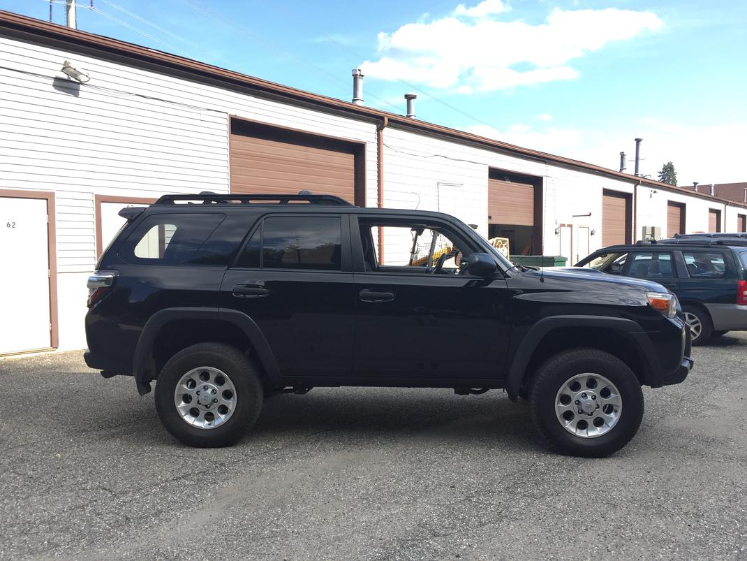

-Changed the stock tail lights for the OEM 2014+ ones
-Added remote engine start
-Bilstein 5100's. 2.5" upfront and 1.5" rear with Cornfed spacers

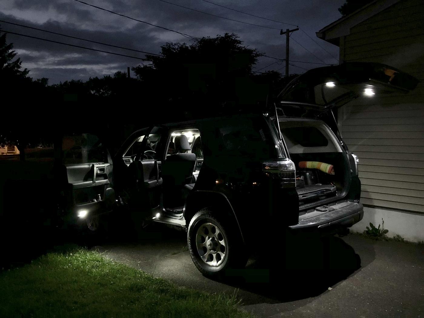

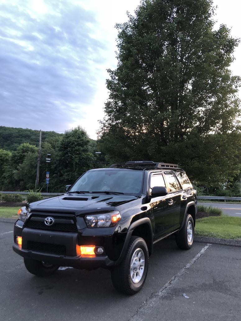

It’s been a while! Added FyreFly interior LED’s. Got a bunch of things in the works

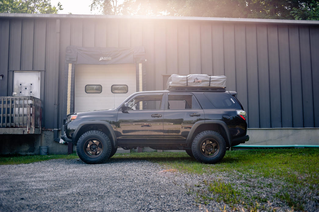

Beyond satisfied with the 285 KO2 C Load. MPG stayed just about the same while performance took a minimal hit. Handling most certainly improved. Borrowed a buddy's camera and finally captured some half decent photos:
