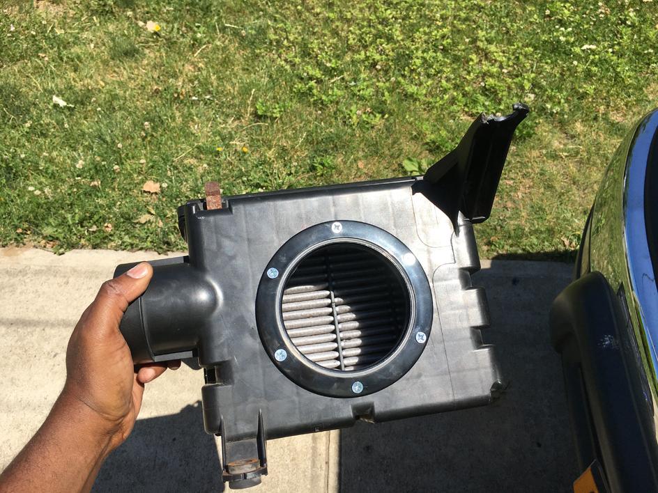

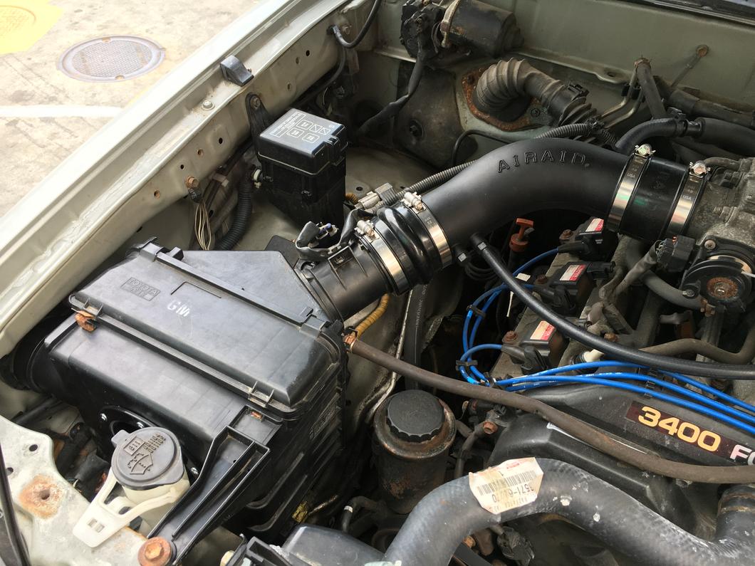

What's up guys, i'm on the market for a new muffler and need some advice. I've recently done the deck plate mod and the ISR (yay!:banana:) and from what i understand you need to add a less restrictive muffler into the mix in order to really benefit from these mods.
I know Borla is a good choice is there a specific model? I'm not interested in a loud muffler truck is my dd. Thanks in advance.
