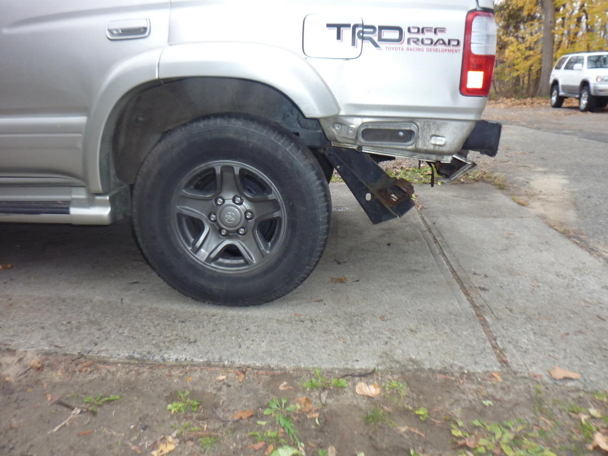

In my preparation to repaint my frame I came across a couple spots where the rust has completely eaten thru the frame rail on the passenger side. See link to photos in this post http://www.toyota-4runner.org/3rd-gen-t4rs/223645-bought-3rd-gen-strange-history-am-i-screwed-3.html#post2498595

I will say this. Your frame is rusted in other places that you cant see "yet", like on the opposing side hidden by the tank. These frames rust from the inside out. You can use that as a negotiating point. I sincerely hope you get some sort of satisfaction. I know how I felt when I found my rust. I tried to remedy it and ultimately, when that truck was rearended by a texting teen, I saw, first hand, what a rust weakened frame does when hit.

I'm about 75% complete with my inspection and rust removal after spending a couple hours under the rig with a hammer, chisel, scraper, and wire wheel. The 2x areas that I took photos of are the only places where the rust has eaten thru. The front and tank skid plates were pretty bad, but have cleaned up nicely. I figure those would get some upgraded armor some time in the future anyhow. Everything else in terms of the frame appears to be solid so far. I've felt in most every spot that I can get into and the inside seems OK, but I would like to get a camera in there to peek around and see what's really going on.

[MENTION=107674]JRZEE2000TR4LTD[/MENTION] - I know...it was a bad miss. Note that the photos of the holes were taken after chipping away that pile of rust in the other photo though. I'm figuring interior & exterior frame treatment/restoration along with the patches in terms of a ballpark number for negotiating.
