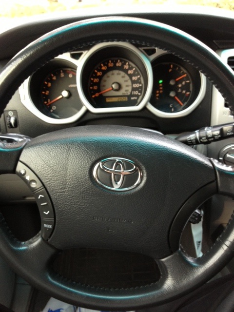

I think I have the same stock controls on the left as you guys. It now does the same functions as stock with the Pioneer, volume, change stations, and then change source modes. I didn't do the phone controls on the right side of the steering wheel, but with the Pioneer it is really easy to call someone with the touch screen.
Yeah I didn't think it was possible to get right side steering wheels controls if you didn't have it already without getting a new steering wheel, but I could be wrong.
I recall that all the wiring was there and ready to hookup. Even on the steering wheel you have (looks exactly like mine). It was just potential issues with the stereo recognizing the commands, even if you have the interface unit. I don't know but that's what I remember...I'm just hoping the OP can verify.
TRDCal - Ok that makes more sense then. So if you do get the right side steering wheel controls, then do you have to get a new plastic piece for the buttons then?
