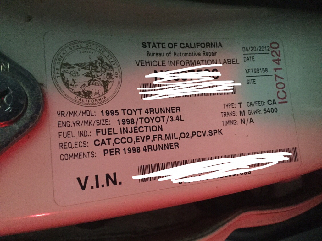

The last paragraph isn't quite true.. Mine is CA referee'd and SMOG LEGAL. That's with a 3.4 from a 98 4Runner and a Tacoma computer/ECU, Walker cat for a 98 4Runner all of it in a 95 4runner frame/body.
I almost got hung up on having the exhaust routed differently than stock for the 3.4 because the 2nd and 3rd gens route the exhaust on opposite sides of the vehicle, making custom work required. I think I caught a good Referee on a good day because after a week of waiting, he called me to come back in and said if it runs clean he would pass it. The first day I showed up in my Auto Technician uniform with Master ASE patches on it and made it clear thru body language that I knew what I was doing and that could have influenced his decision. What was the most frustrating was that this thing literally puts out right about ZERO emissions and he didn't want to pass it for some dumb technicality. I argued "isn't Smogging all about cleaner air? And my truck runs spotlessly clean soooo...."
So while the swap isn't impossible, it is incredibly difficult. And this was 10 years ago for me. Rules could very well have changed. What I would do if I were to tackle this today: go to the actual referee who would be doing the authorization of the swap and talk to him. Ask him what he needs to see to pass it. Make a list and have him agree on it. It may be a nightmare. Or it may be an old timer on the back 9 of his career who understands what people are trying to do.
And then when it's all over you get one of these and it's done forever. Although the my smogging requires a STAR station. As long as it runs clean, it won't be an issue.
