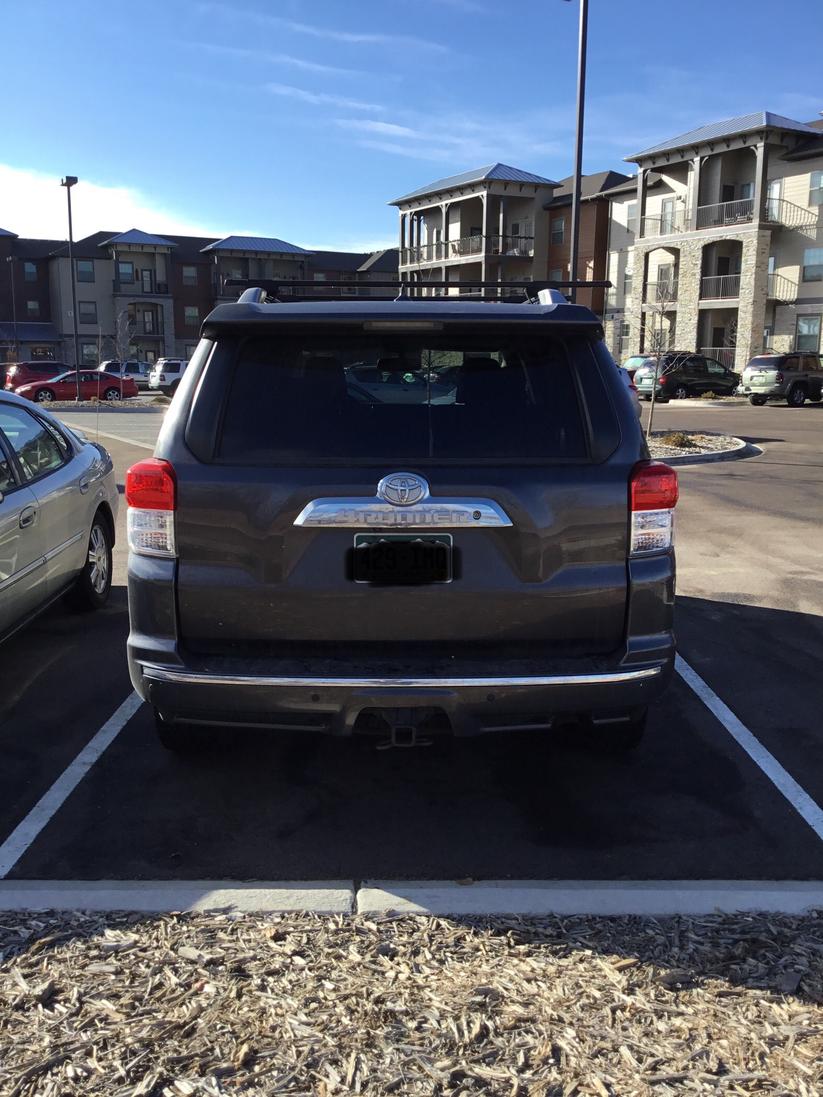

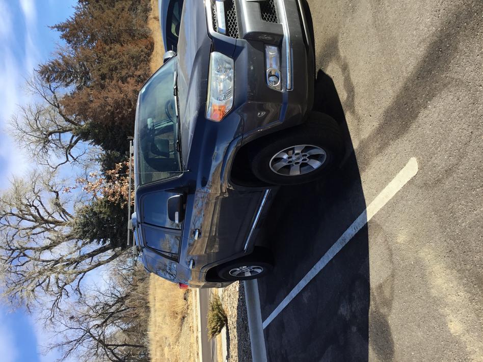

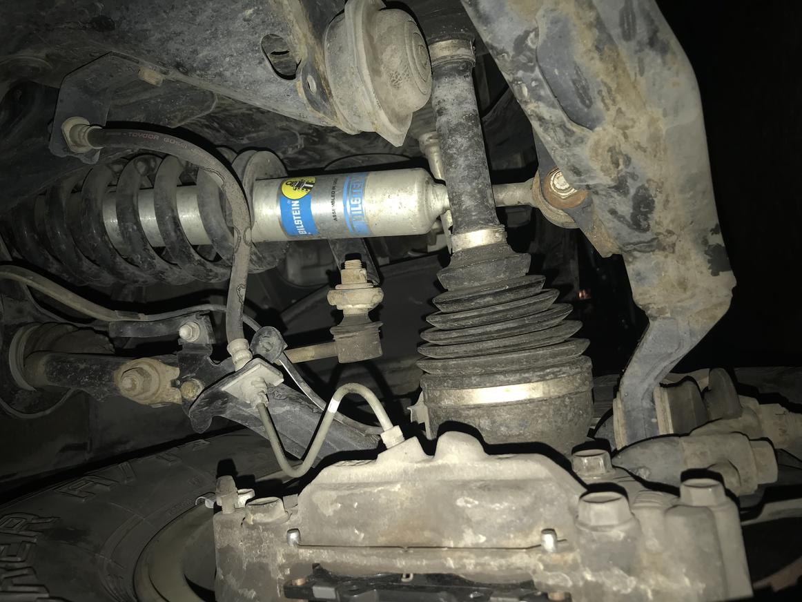

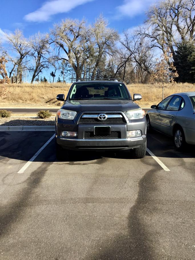

Hello everyone and thank you for always helping me out on simple questions I have from time to time. I’m new to the truck scene as this 4Runner is my first SUV. I will try to make this fast and easy and my apologies if it’s not.
I’m looking to buy this 2011 4Runner SR5 from my boss. He was the original owner and has put 90k on the odometer. I’m looking to tell you guys about some issues I feel I should address and trying to make sure I’m not over paying due to issues that might need to be addressed. I will start out with vehicle conditions and then work in to issues. The truck had wheel spacers put on when it was around 20-30k on the odometer and the truck has had a wheel shake at 60mph since according to my boss. It needs tires very very bad and a alignment. The exterior does have a dent in the front right fender, nothing that bothers me as well some small scuffs and scratches that I feel can be fixed once I get it a good detail. That’s about it as far as cosmetics.
What I’m trying to do is fix the wheel shake which happens at 60mph and then goes away as you go faster which I will start off with getting new tires, balance and alignment as well remove these wheel spacers. The truck currently has from what he told me 2inch wheel spacers with 275’s and it rubs. I love the look and stance but don’t want any rubbing and don’t want any issues with spacers if this is what actually is causing this shake. I’ve been told that these shocks on the truck are not from the factory? Please correct me if I’m wrong. The shop today told me that the shocks will probably need replacing because after they inspected the tires they said it was due to bad shocks. After feeling the guy out at the shop i don’t think he’s accurate. This truck doesn’t make any sounds from bad shocks and I know this truck has only seen pavement and never a dirt road as my boss doesn’t take it in trails. I couldn’t imagine them being bad but my concern is if I get new tires I don’t want them to get bad wear due to a bad shock. I’m looking to get KO2’s in a 275 but looking to see everyone’s opinion on performance between 265 and 275. The truck will be 99% on the highway everyday but would like to hit some trails on the weekends. So my concerns are should I fear wheel bearing wear since these spacers have been on so long as well other steering components that could’ve take a toll from this. Should I change and flush all fluids like Front and rear diff as well transfer case? I’m trying to price out things I should consider fixing or checking so I can negotiate price. Pictures below show some exterior photos and I will load more today but if you guys could help me out that would be great. Mabel a price you feel is fair because in my situation I can’t do the work at home as you can see where I live my neighbors will complain. I’ve had the dealer give me some pricing and it all seems very fair except the diff and transfer case flush but if I have to have them do it I’ll suck it up. Thank you for the help everyone as I’m super excited to get in this board and join the club.

No, those are not oem shocks. Stock suspensions are in these classifieds for a song.

Badly worn tires are probably not from bad shocks, they are probably from poor alignment and inconsistent rotations. I'd say 3 years is way too soon to be replacing shocks that most people would say are top notch quality.

And the vehicle in those pictures does NOT have 2" spacers on it. Maybe 1.25" which is most common, but not 2". Some have reported wheel shimmy on these things since they were new in 2010. With and without spacers. My 2014 has a slight shimmy some days at certain speeds, and some days it doesn't period (I do have spacers). I can't explain it and I have given up on trying. My tire wear has never been abnormal, and I just keep an eye on them.

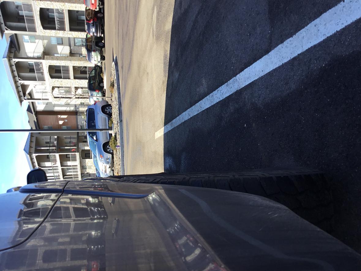

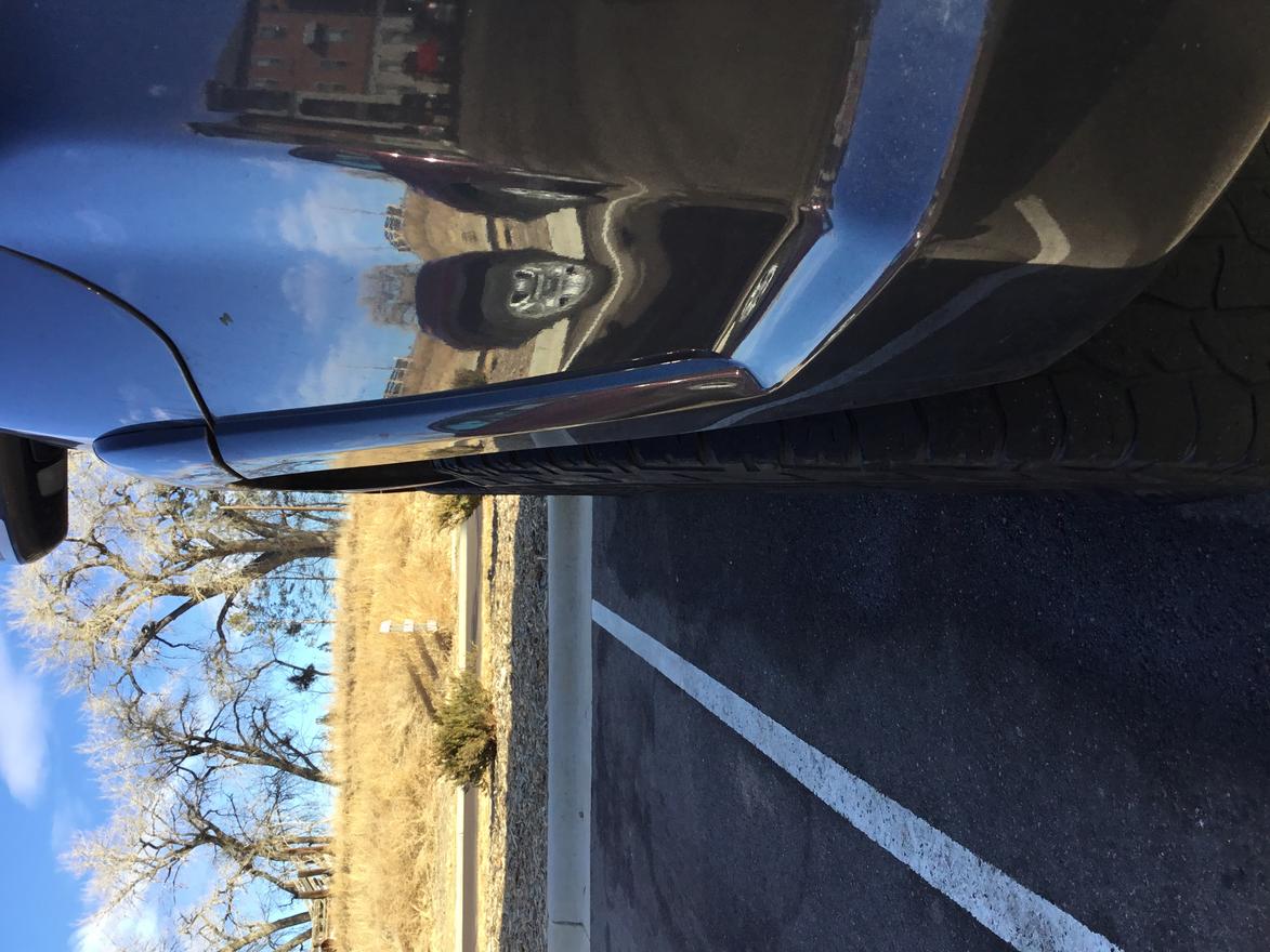

Wow thank you everyone for the very informative information. Mabel they are not 2inch I’m just going by what I was told but I did just dig up some photos I took the other day of the side angle of the truck to see how far they stick out with 275’s. I do love how it looks with spacers but not sure if I’m ok with the extra wear and tear with driving 30,000 miles a year. Sorry for the weird picture angle. In my album they are right side up not sideways

Not a fan of wheel spacers. They are a poor excuse for not doing the job right. Go with a smaller tire or install a quality lift. If you are mostly driving around town go back to stock. Something to keep in mind is bigger tires decrease braking ability.
Thank you, After talking to a local shop here by me who works on 4runners and Toyota’s I feel I’m going to eliminate the wheel spacers and as well go with a 265 and not a 275 like what’s on there now. The truck will be used on the road 90% of the time and light off road on the weekends here and there. I’m considering a small lift but I would have to see some pictures to make a decision. You guys have been great thank you!
I failed to mention using the proper offset rims to eliminate the wheel spacers. Offset rims could still cause bearing problems.
