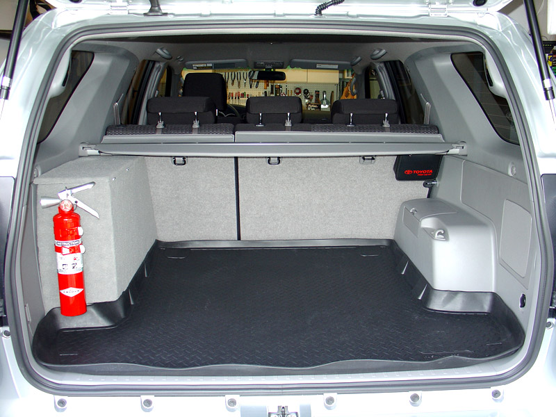

Toyota 4Runner Fire Extinguisher
Nice mounting location JA. I saw a guys brand new Cadillac sedan burn out the engine bay yesterday in my parking lot at work so it reminded me of this thread. Even with the firefighters on scene it took a while to get put out.

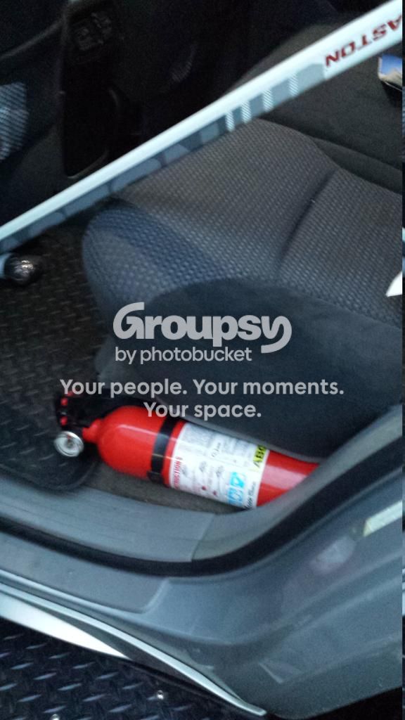

I've had mine tucked next to the rear seat since I bought the truck. It doesn't budge since it's wedged between the door and seat bottom and if I ever needed it, just open the door!
It's an ABC so it'll damage the electronics if I ever have to use it on a vehicle, but I've always carried one and they've proven useful in situations I've happened upon while driving. Putting out grass fire some a hole caused by tossing out his cigarette...those kinds of things.
I have a snatch strap stored in the same place on the passenger side.
