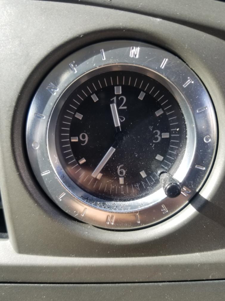

Where to mount is a problem too as there's really no good space for it on our trucks. I'm thinking on center bezel below emergency blinkers or on other side below rear hatch window switch. It's funny you mentioned Infiniti coz I just sold a 2003 Infiniti QX4 truck which had this clock right in center of dashboard. It was nice and convenient.

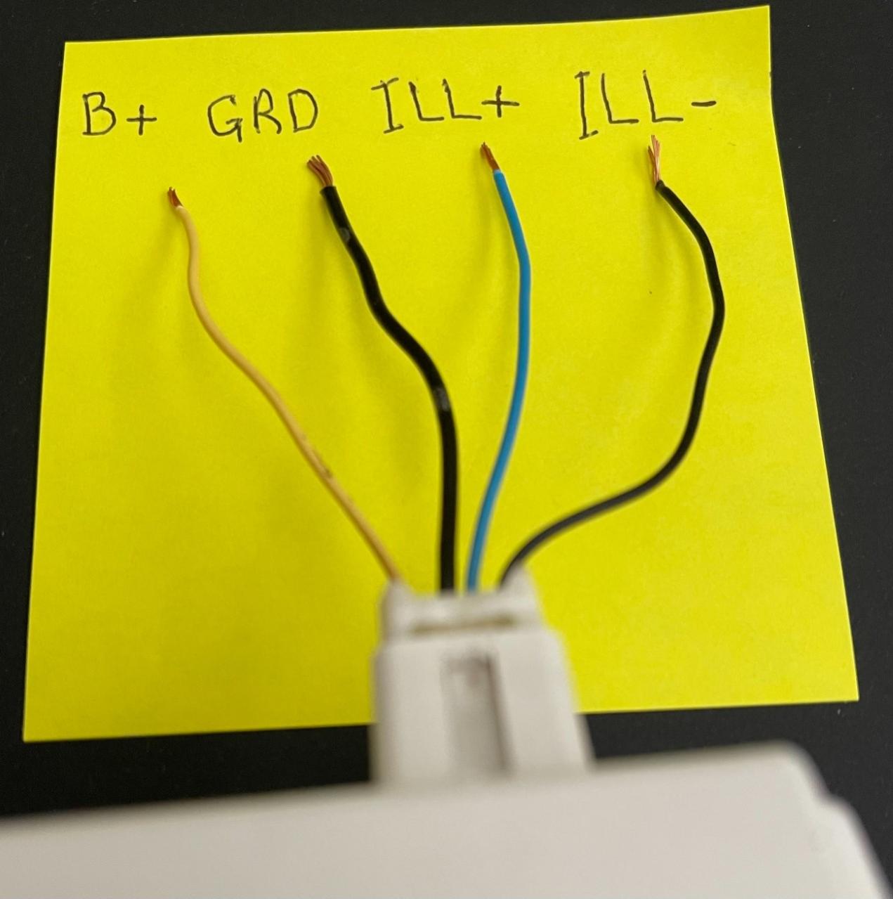

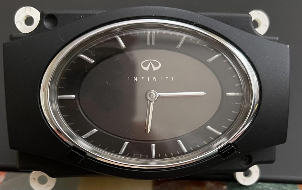

I'm reviving this thread as I recently got this Infiniti G35 clock with it's wiring connector and I'd like to install it right below the emergency lights switch. I called a shop near by that does auto electric and the guy told me he would charge me $290.00 to connect properly it. I think that quote is outrageous!
Based on what's showing on wiring label I copied from back of connector, does anyone have any idea where to start with wiring?
ILL- : Probably stands for light/negative
ILL+ : Probably stands for light/positive
GRD : Ground
B+ : ??
I agree with your interpretation of the wiring. B+ would need to go to a constant power source so the clock will continue to function even with vehicle power off. Illumination positive can go to switched power, if you want the backlight on anytime the vehicle is on, otherwise it needs to go to something downstream of the light switch to only come on with the lights.

I tested the B+ along with the GRD by attaching wires directly to battery and clock worked just fine. Now, as far as the illumination pos/neg wires, I'd like clock's backlight to come on when headlights are turned on, and I'm not sure how to hook those up. My 4R has the daytime running lights, and if I attach them there, they'll be on when car is running, day and night. I'd rather have it on only when headlights are on. I can't seem to find wiring going into low headlight beam, which seems like the logical place to splice into. Any suggestions?

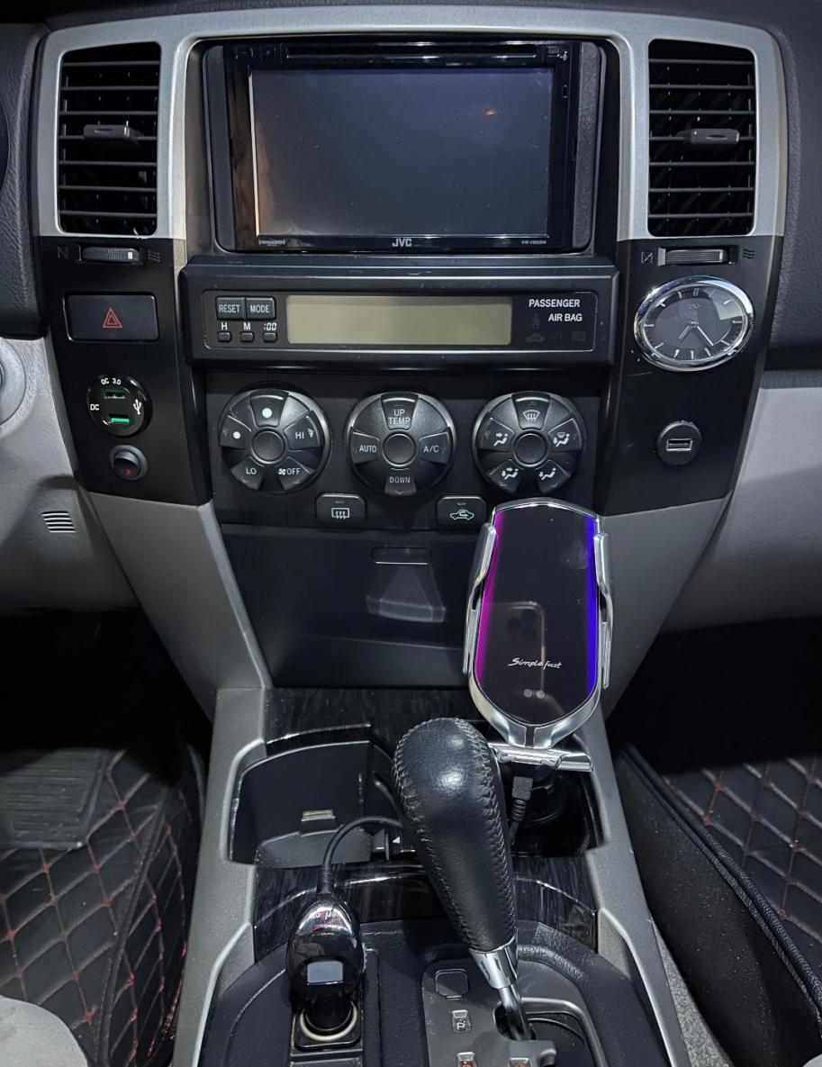

I was able to get the clock mounted in the same spot where hazard light switch sat, which I moved to the left side. It wasn't a problem since that space had a blank cover. So, both openings were resized and that's what it looks like now. I also spray painted the trim black to match climate control panel. Luckily, color of clock light matches existing lighting scheme.

It looks nice, the Infiniti logo would drive me nuts... I would have tried to see if at the very least Lexus had a similar set-up.
