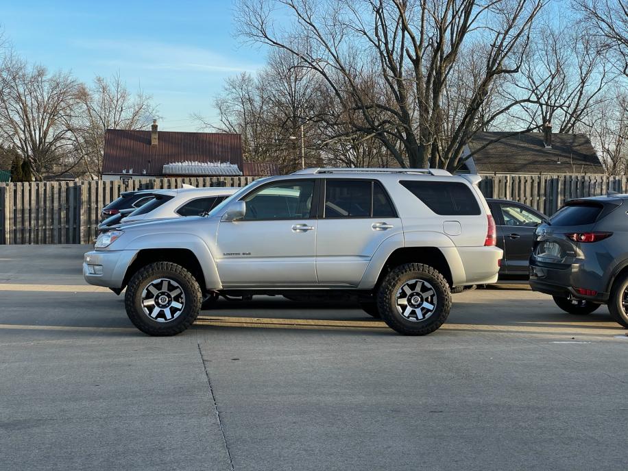

2003 V8 Limited. 5100s with OME 887 front and Toytec Superflex rear springs. 285/70/17 tires. I’d recommend this combo to anyone. I’m happy with it on road and we will see how it performs off-road in a few weeks.
Also, you don’t want “level” in terms of wheel gap. They actually means your frame is reverse raked, thus Carolina squatting while appearing “level”.
