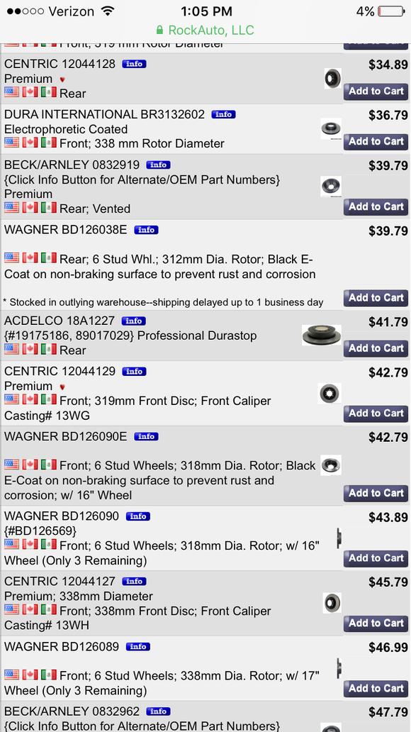

One last question. I have noticed on rock auto that there are different size rotors all listed for my truck. I can find front rotor that are 319mm to 338 mm. How do I know which one to order for my truck or does that even matter?? Same problem on the back. I have never ordered rotors by size, just by vehicle. Thanks for the help.
The easiest way to be sure is to go out to the truck and measure them.
If you go into an auto parts store, they'll ask you if you have 16 or 17 inch wheels. If you say 16 they'll sell you the 12.5 inch rotors and if you say 17 they'll sell you the 13.3 inch rotors.
In reality, it's not that simple. I have an SR5 with 17 inch wheels but it uses the 12.5 inch rotors.
I'm sure that people will chime in and tell you that all SR5s us the small ones but the Limited and Sports use the larger ones. That may be right, I don't claim to know. The best way to make sure is to just pop off the wheel and take a tape measure to your current rotors.
I went through the trouble of measuring mine at 319mm - then afterward just looked at the inner caliper face and saw 13WG stamped right there. Could've saved myself the trouble of pulling the wheel.
I went through the trouble of measuring mine at 319mm - then afterward just looked at the inner caliper face and saw 13WG stamped dright there. Could've saved myself the trouble of pulling the wheel.

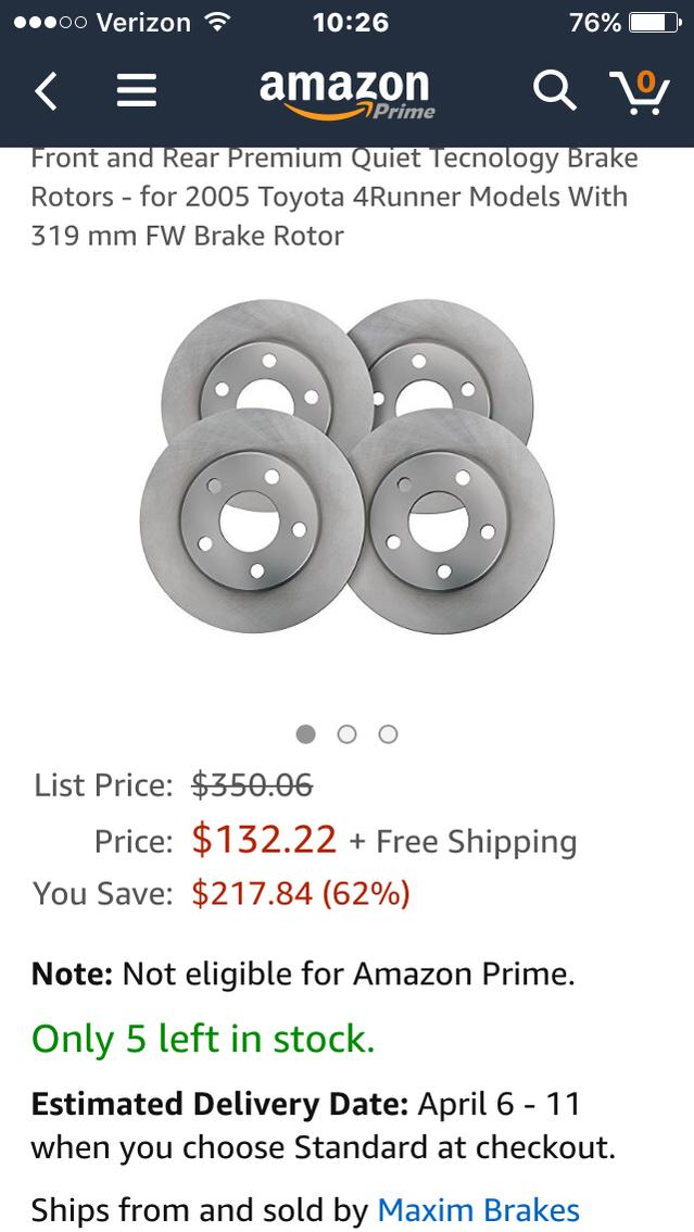

I've chimed in on this before, but I highly recommend the Centric Premium rotors which are available on Amazon. I had them on my rig prior to one of my calipers seizing and they never squeaked, never squealed, seated perfectly, and were great.
Amazon.com: Centric Parts 120.44128 Premium Brake Rotor with E-Coating: Automotive
http://www.amazon.com/Centric-Parts-120-44127-Premium-E-Coating/dp/B000BZZPRC/ref=sr_1_2?s=automotive&ie=UTF8&qid=1461243940&vehicle=2006-76-1005-13--9-6-8-8087--1-1-2550-116-2-0&sr=1-2&ymm=2006%3Atoyota%3A4runner&keywords=centric+premium+rotors (Make sure these fit your rig; not all 4Runners have the 338mm rotors up front)
