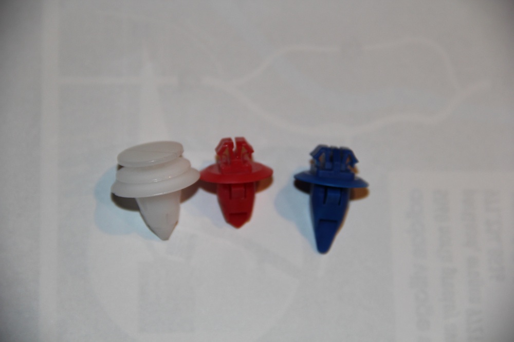

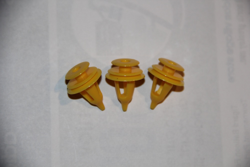

Funny you should ask. I had a real problem finding the right clips. The part number from Toyota is 90904-67037, however, they don't fit. See the photo below. They are the red and blue clips. So my next stop was NAPA and they brought out the "big book of clips". I decided the white ones would fit but the gap was too tight to slip on the flare slot. So my next stop was the Toyota body shop. They just fixed my 2010 Camry after a deer decided to jump in front of it. Told him what I needed and he handed me a bunch of the yellow ones you see in the photo. They are perfect. I have no idea what the part number is. Save the photo and hit your nearest body shop and good luck. Put a little sealant around them to prevent any moisture from getting inside.

Yea that's what I thought too. I use OEM so I went to Broadway Toyota he searched for them in the parts catalog, and brought me the red and blue ones for the 2001 SR5 but they just don't work. That part number I posted (red and blue) is directly from the dealer. I'm sure my flares might be different than the 98 flares. The problem with the OEM clips that I have is they lack the depth I needed to get them to stay secured, or they just didn't seat correctly on the flare itself. The yellow ones I picked up from the body shop were perfect. With the 98 and 2001 we might be talking apples and oranges here.

Anyone ever figure out the real part number for the clips that WORK (those yellow ones)?
based on Low Range's site, the part number 90904-67037 says its for 2001 and newer SUV/Trucks
The they say we need is 90467-11110 but I just wanted to know if that was true as they don't have their photos labeled or all of them pictured here: Toyota Fender Moulding Clips - Low Range Off Road
I had an automatic gate close on me and ripped off the cladding/fender flare on my '97 limited. I needed the white clips 90467-11099 and 3 red ones, I ordered em at amazon.
