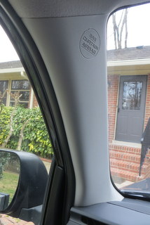

I need to remove the left A-pillar cover to run some wires from the rear view mirror to the dash. The cover snaps off, but there is a plastic, fork-shaped "catch" that holds the cover on loosely. Is there a trick to releasing that catch without damaging the airbag?

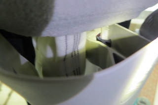

This is for reference for those who look to do this in the future. Neither of the two methods mentioned above worked on my vehicle, as the cover is attached in a different way. I got the job done, though, using the same method as [MENTION=336]03_4x4Runner[/MENTION]. I tucked the wires under the edge of the A-pillar cover, and ran them through the same hole in the top of the dash that the other harness is run through. Below is my A-pillar cover, and the black plastic "keeper" on the back of it that prevents it from coming off. There isn't enough room to get long-nose pliers or another tool on the keeper to remove it. It also appears that the air bag is attached to the back of the A-pillar cover.

Take a pair of needle nose pliers, slip them between the sheetmetal and the airbag curtain grab the black keeper and turn it until it pops out the slot.
When reassembling it, put the keeper through the hole and turn it so it's "locked" and pop it back on.

I think you need to pop off the cover that has the airbag wording stuff on it. That's where you'll find the bolt you need to remove. I removed this cover on my SR5 and don't recall any hidden "catches".

I realize this is an old thread, but wanted to say thanks because this comment was quite helpful. Early 5th gens seem to be different than later ones in this regard, so I had this keeper to deal with when running the wire for my microphone. Needlenose pliers between the airbag curtain and sheet metal worked, so I didn’t have to cut off the tab like the FSM shows! The trim is still tethered to the airbag, but it allowed me to carefully pull it away far enough to fish the wires.
