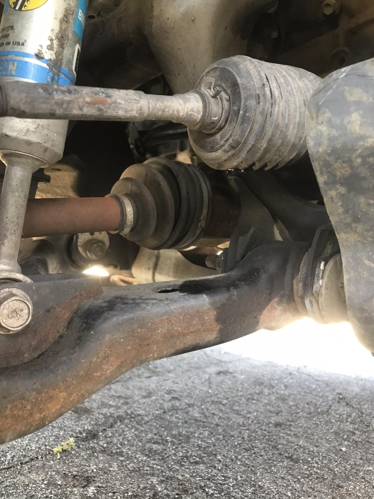

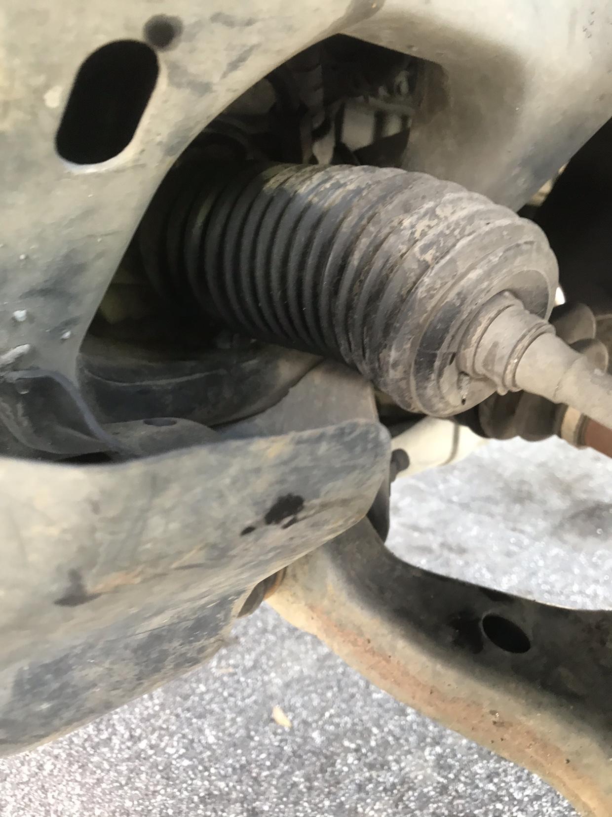

The rig steers hard right sometimes when I’m braking. I found with a wheel shimmy test that the right rear LCA bushing is shot. I also noticed a lot of flex in the rack on the right hand side where it bolts to the frame.

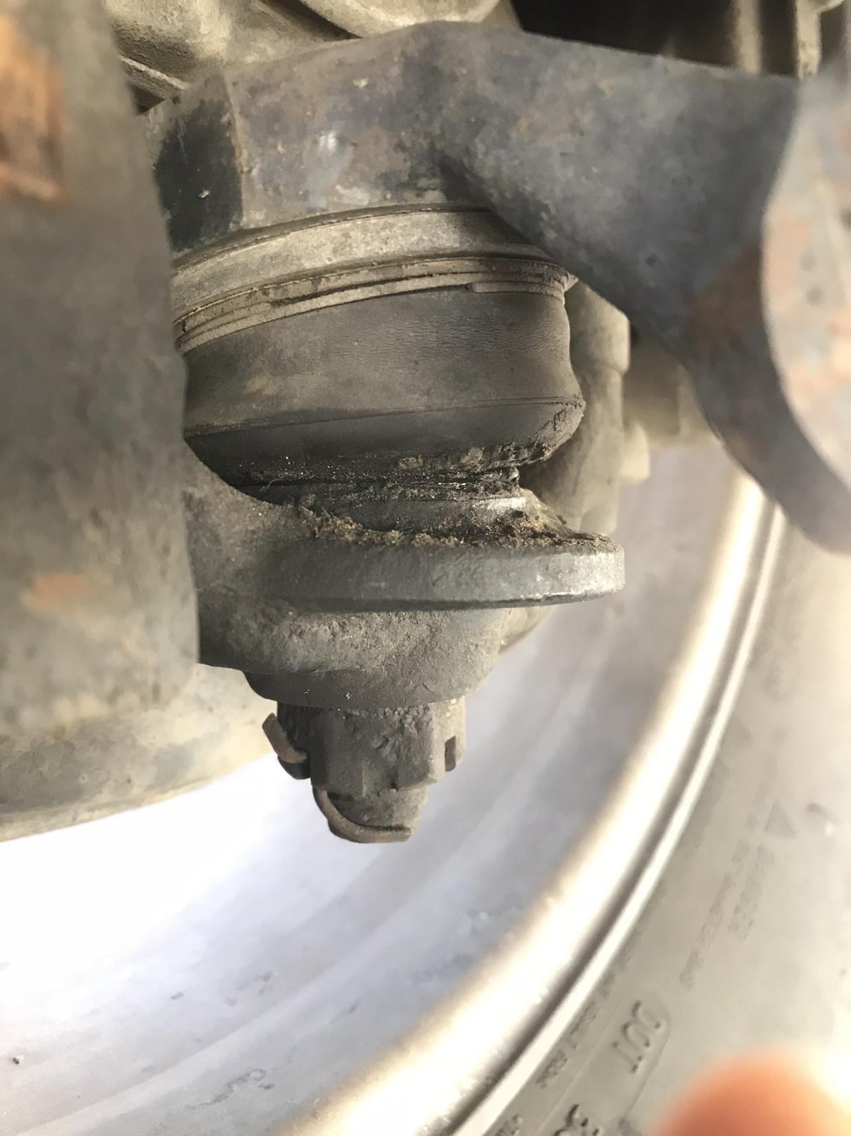

Passenger lower ball joint

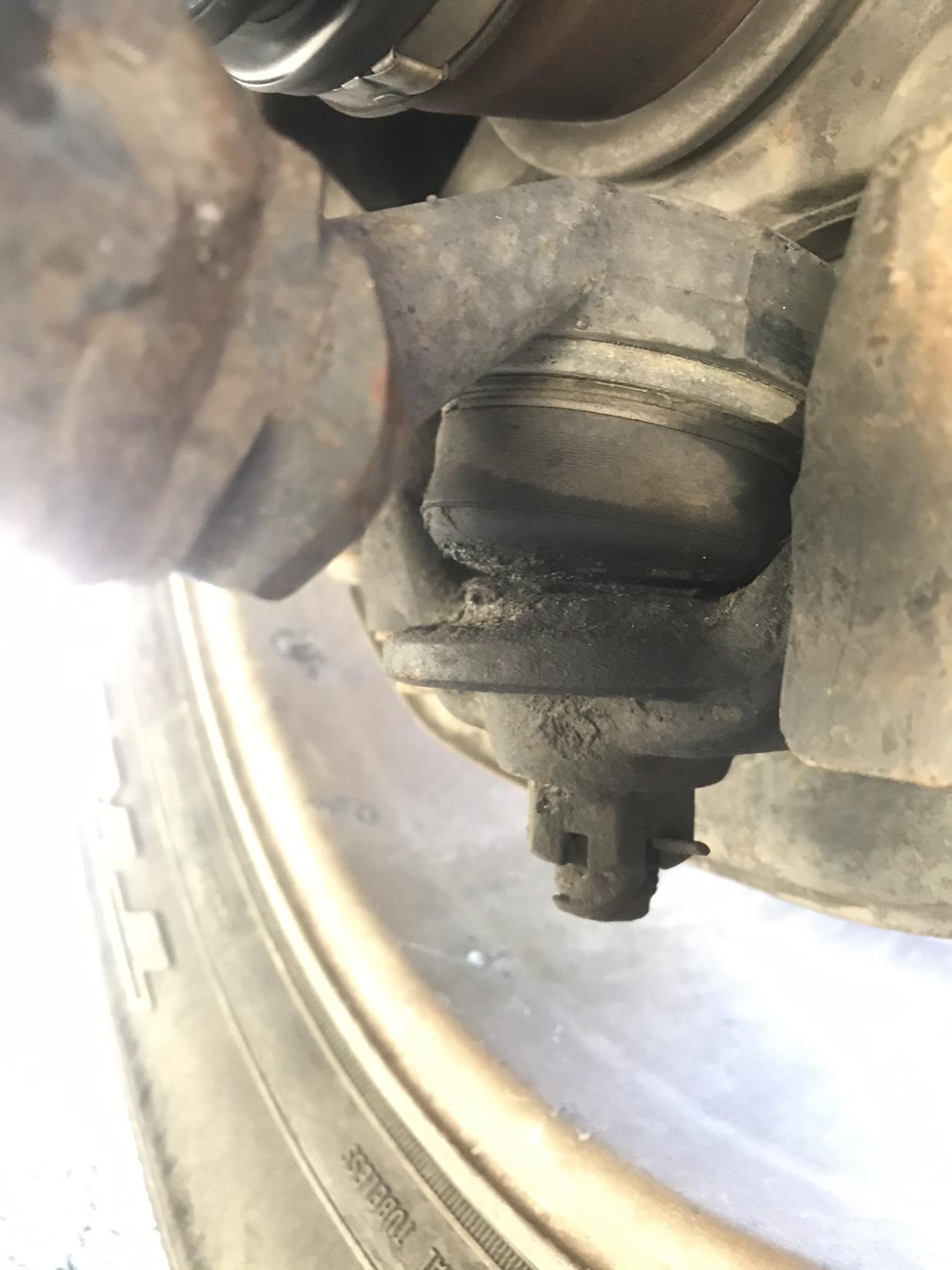

Driver lower ball joint

Caliper is fine, the front right LCA back bushing is rotted out and bends in towards the middle of the rig, I was able to turn the wheel right while having the left wheel not move at all.
