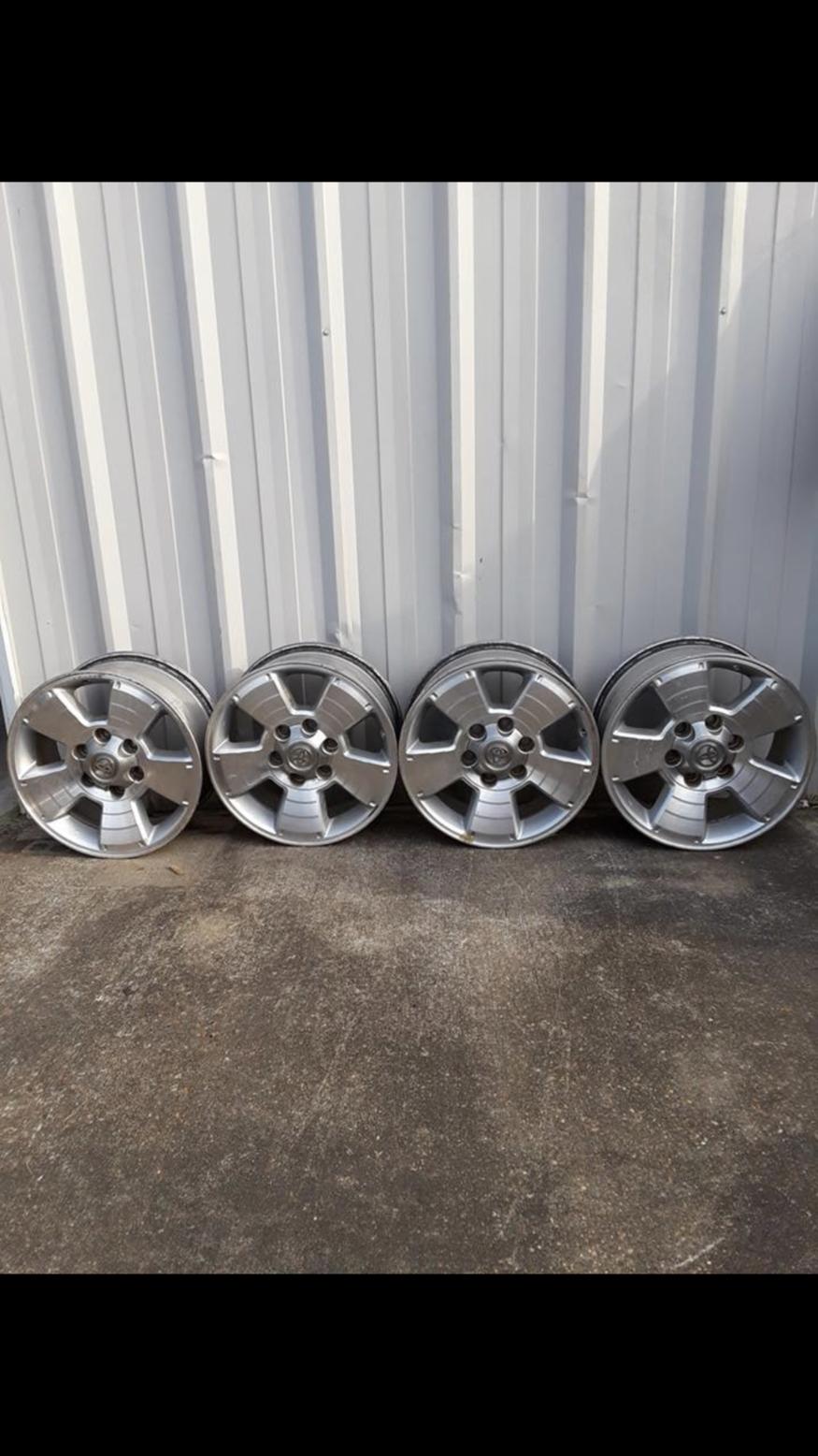

Sold my Methods today and have been looking for some stocks. A buddy offered me these wheels for free. I believe they are 17x7 2nd gen Tacoma wheels. Can anyone verify that these will fit? I am wanting to run them with 285/70/17 KO2s. Just worried about clearance issues with the control arms and or brakes. Anyone have any info? They would be going on a 2012 SR5.

Should fit fine. Those are the same wheels that came stock on my previous 2003 SR5 4runner.
they were also used on Tacoma's.
They'll fit, but the 4th gen wheels had +30mm offset vs +15 on the 5th gen. You'll probably want to run spacers.
