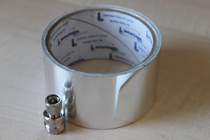

Did anyone mention metal tape? For ducting.
Might work till the heat starts to peal the tape...maybe.
