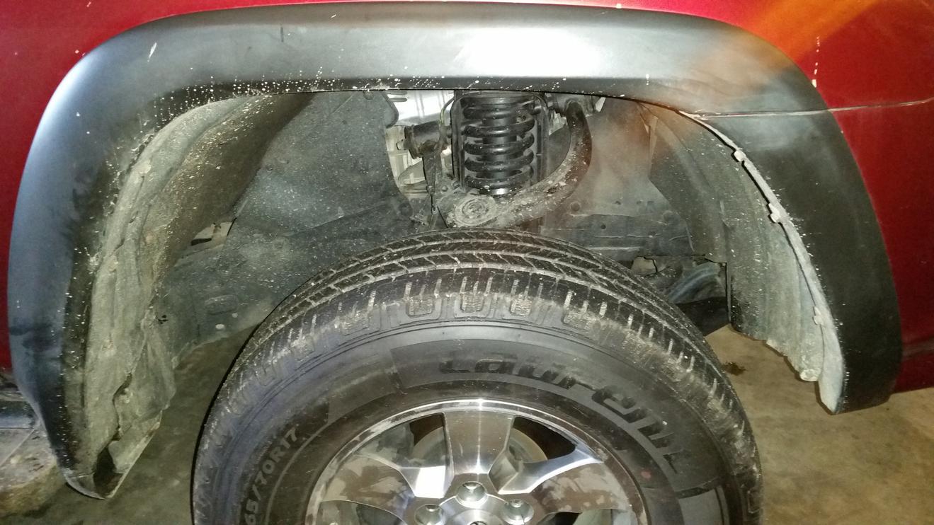

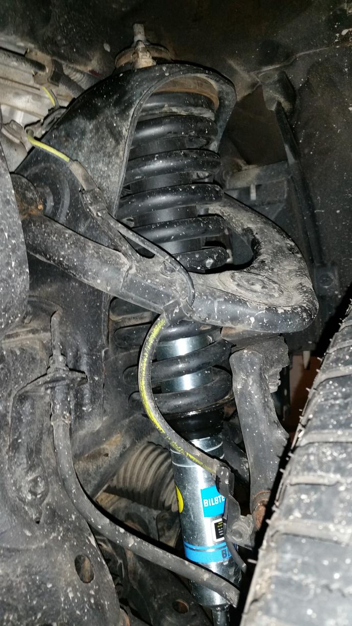

So last night I installed the front shocks with the factory springs. I consider myself very mechanically inclined and have always done my own work. Compressing those springs was no picnic, but we got it done. When we put back on the stock wheels, I now have a 5" lift on the front! I went from 19.5" center hub to base of wheel well to 25"! The upper control arm is extended fully down. It appears to have no room for downward travel.
I installed Bilstein part 24-196499 with the stock spring. Now I'm wondering if this is not a stock spring, so it is extending the shock to full downward with very little give on the upstroke. Thoughts? Help!

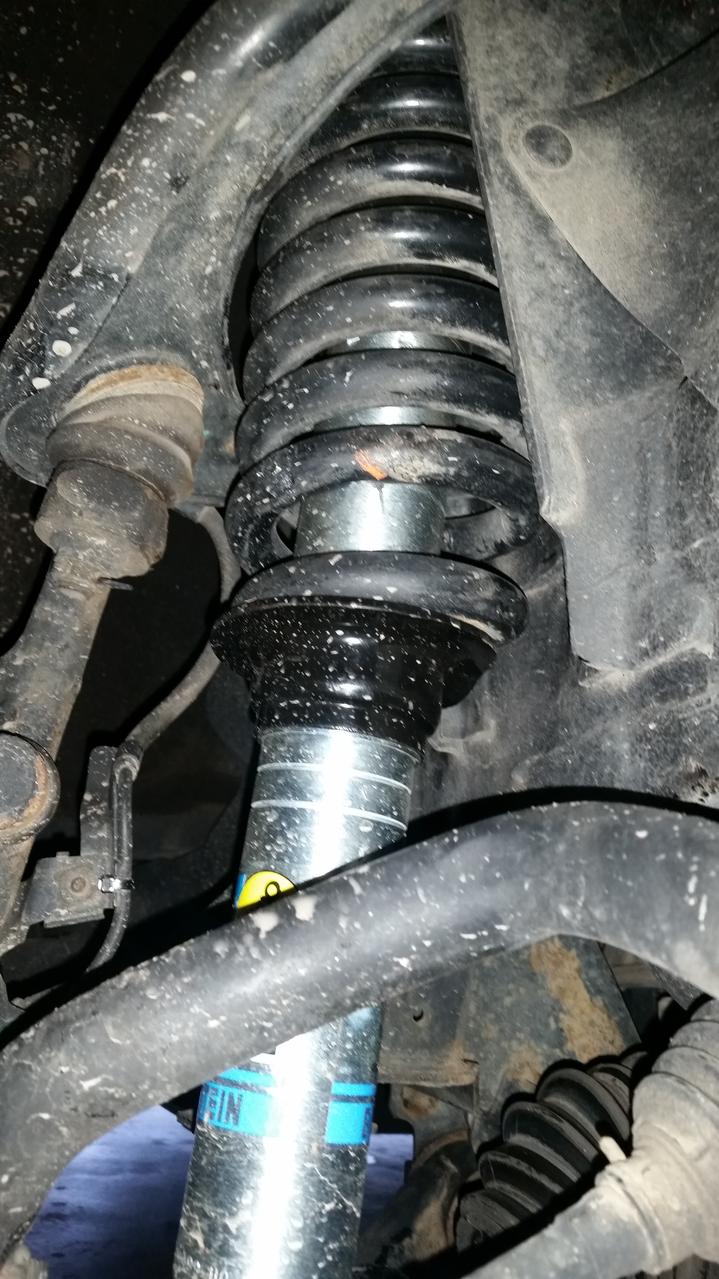

Here you can see the upper control arm being pulled down.
http://www.toyota-4runner.org/attachment.php?attachmentid=238617&stc=1&d=1486831508
Spring seat installed correctly, and shock set at 1.75" lift.
http://www.toyota-4runner.org/attachment.php?attachmentid=238618&stc=1&d=1486831508
I'm going to need some 35" tires at this rate!

Just did the 5100's on my Trail last weekend -
100%, for sure, your problem is the spring perch. Its upside down as stated above. Flip that over and everything will be back to the way its supposed to be.
Dang. That's a bummer. You'll be good at taking it apart now though. Good experience for your next shock replacement.
