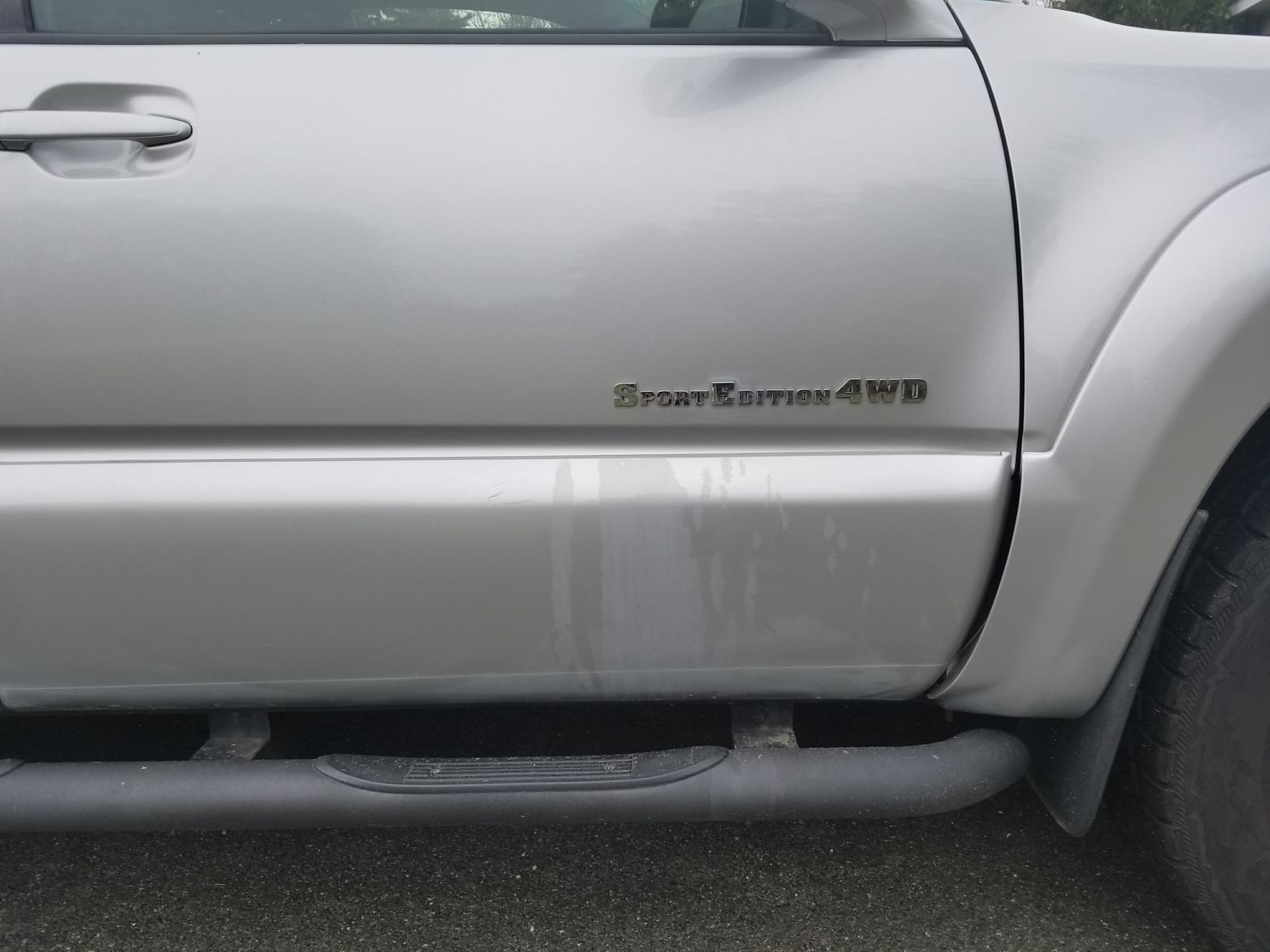

I purchased the 4runner on Saturday. Came out this morning and noticed this on the side door. We had a hard rain all day yesterday but I am trying to figure out what could cause this and what the heck is it. I would have noticed this at the dealership.
Any ideas?

Its not vandalism. My wife parks right next to me and her car is fine. The paint isn't peeling, its almost like some kind of chemical was splashed on there. I honestly cant make sense of it.
Only consolation is that it may be possible to buff out (cheaply).
If you splash water on it, does it look "fine" for a brief second?
If so, probably can buff it out.
My wife's red car had some hard water deposits dropping down her rear view side mirror, looked like shit. 30 seconds with a microfiber pad, dual-action polisher and polishing compound and it was good as new.
Maybe the waterspot stain on grey looks like bad clearcoat?
See if it feels different than the surrounding healthy paint when you run your fingers over it. If the surface of the clear coat is damaged, you may be able to use a product like Scratch-X to take off that top layer and improve this. My Dad had a similar looking discoloration on the front bumper of his 350Z and nothing worked until I hit it with some 3000 grit sandpaper, then 5000 grit sandpaper, and then Scratch-X to bring back the shine. This is safe on your clear coat (assuming you wet sand and don't sand for too long). The discoloration was still there but it was barely noticeable. Hope you get it figured out!
does it feel any different to the touch? does it react to water?
It doesnt react to water. It doesnt feel any different than the rest of the panel. Its smooth as everything else.
It doesnt feel any different at all.
It doesn't look like clear coat failure. What I would do is wash your vehicle then clay it and see if that removes it. If not maybe get some compound/polish with a da polisher and see if that takes care of it.
I would put some plastic treatment/restorer on it and see if it is still noticeable. What I am thinking is the dealership may have put something on it to give it a wet look and so that you wouldn't notice it. Then the rain came and washed it away.
its etched. Polishing wont help, that panel is done.
Perhaps the dealer rubbed some tire shire or armor all on it to cover the imperfection up. That stuff usually comes off after a rain storm. Not trying to call the dealer out but it's just a thought.
Definitely looks like something was splashed onto the paint that etched it.
I had this on an old car of mine that was black, if I polished it, it would look good for a few days but then come right back. Dealer might not of known any better as most used cars are detailed when being sold, maybe they thought they fixed the problem
I took it to a local auto body shop and they couldn't say what it was caused from but it does indeed look to below the clear coat. If you look at the running boards it seems like the white dripped down like something came off from the rain but I don't know what could do that. I called the dealership and they don't know anything about it. The salesman said he will talk to his boss about it. I've only had the car for 3 days.
Whatever cause the damage to the paint, it's strange that it's only on the plastic area and not any damage to the paint on the metal portion of the door!!
Might be a REALLY big stretch, but maybe there was some liquid wax from when they waxed the car, left in the side mirror, and the rain drained it out and got onto the panel....????
Either way... good luck.
Looks like some chemical etching- I had some "water" splash over the hood of my other car, which turned out to be some sort of chemical washoff from the nearby construction and it was on there for a couple of days (I was on the way to the airport at the time so I couldn't wipe it off) and now there's some light etching that I have to wet sand and level off. Your etching looks rather massive and deep however, I'm not sure if you can repair that with wet sanding or if you'd need to repaint it entirely. At minimum, clean it off with something like Dawn to wash off any wax and see what damage you're working with and go from there (clay bar/wet sanding/polishes/etc).
