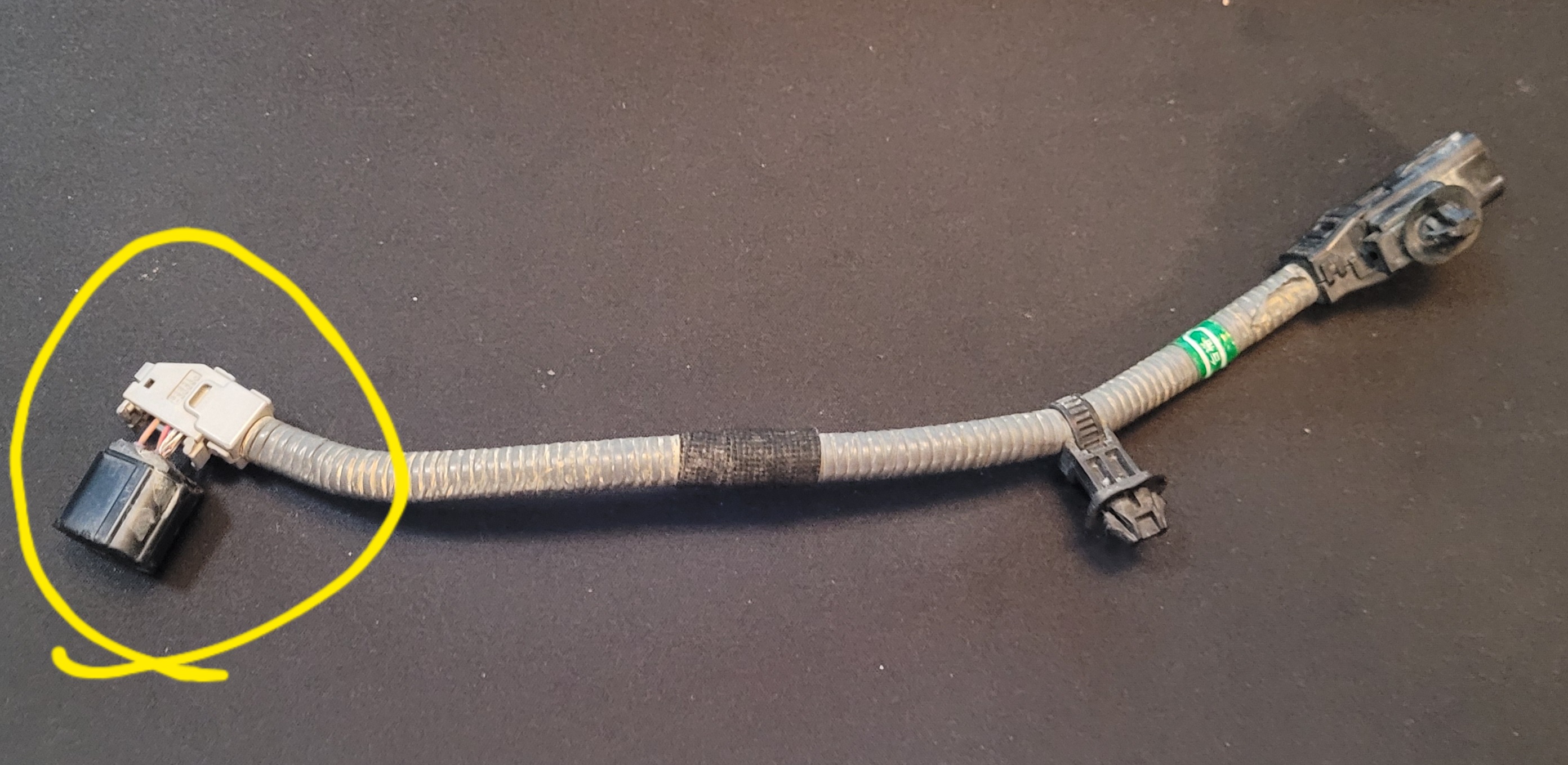

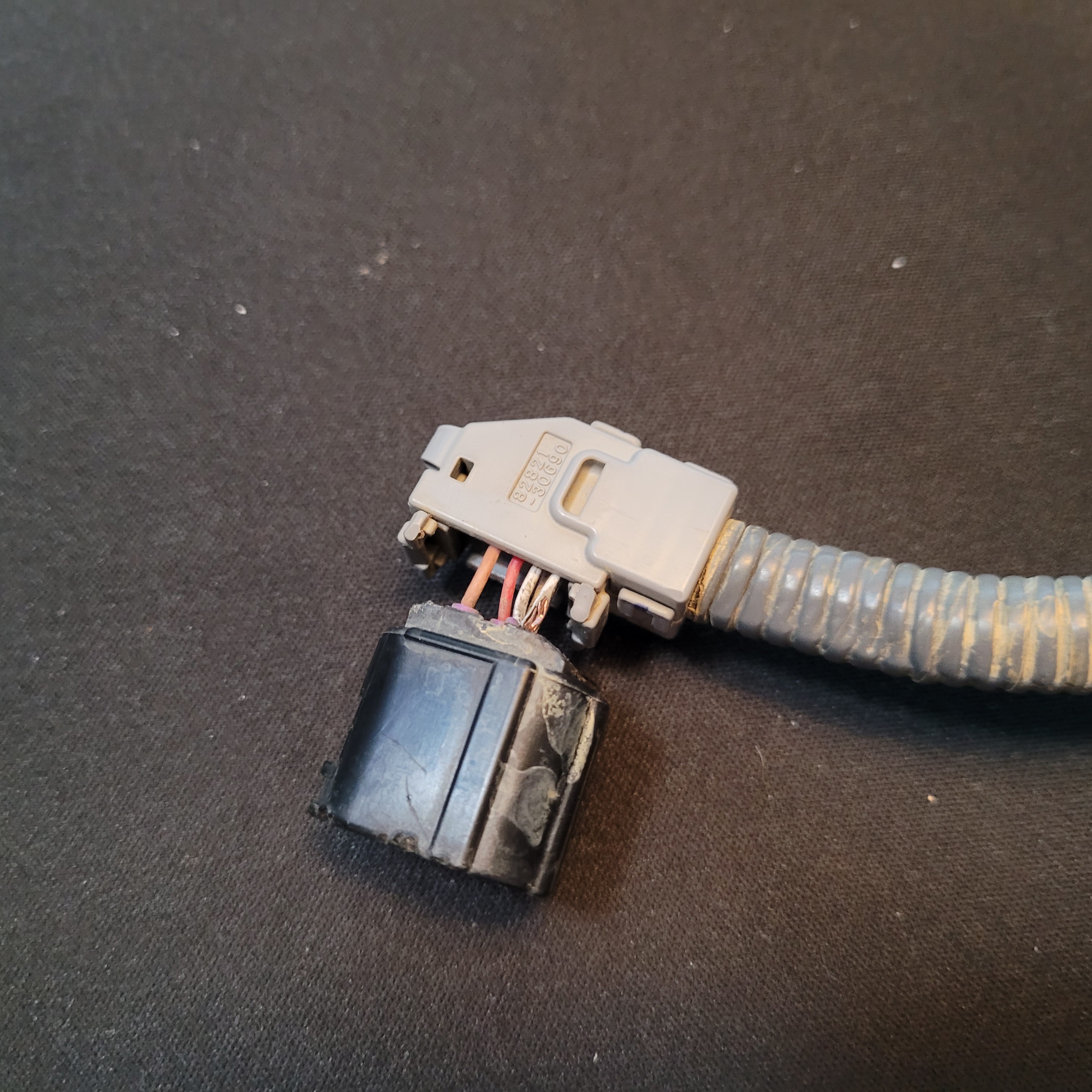

Hey folks, I need some help from the group here. I didn't leave enough clearance between the connector that goes into the TSS sensor on the grill and my winch, and the connector is now broken. As it is just one end of a 1' pigtail harness, I thought it'd be easy to replace. According to my local dealer parts department, they do not sell that separately, and I'd have to buy the $3,400 full harness to get that. !$#%!
So, I'm looking to see if anyone has any ideas on where to get just this short harness bit for a reasonable price, or knows of anyone who can replace / rebuild the connector.
Thanks,
Justin
Find a new dealer that is competent and not full of BS. Here’s the part number for the harness. It’s the full small extension.
88214-35070
Should be less that $40 out the door.
-Old Red
Easy fix. Get a pin repair kit from the dealer. Depin and fix, put it back together. Or buy the short harness.
