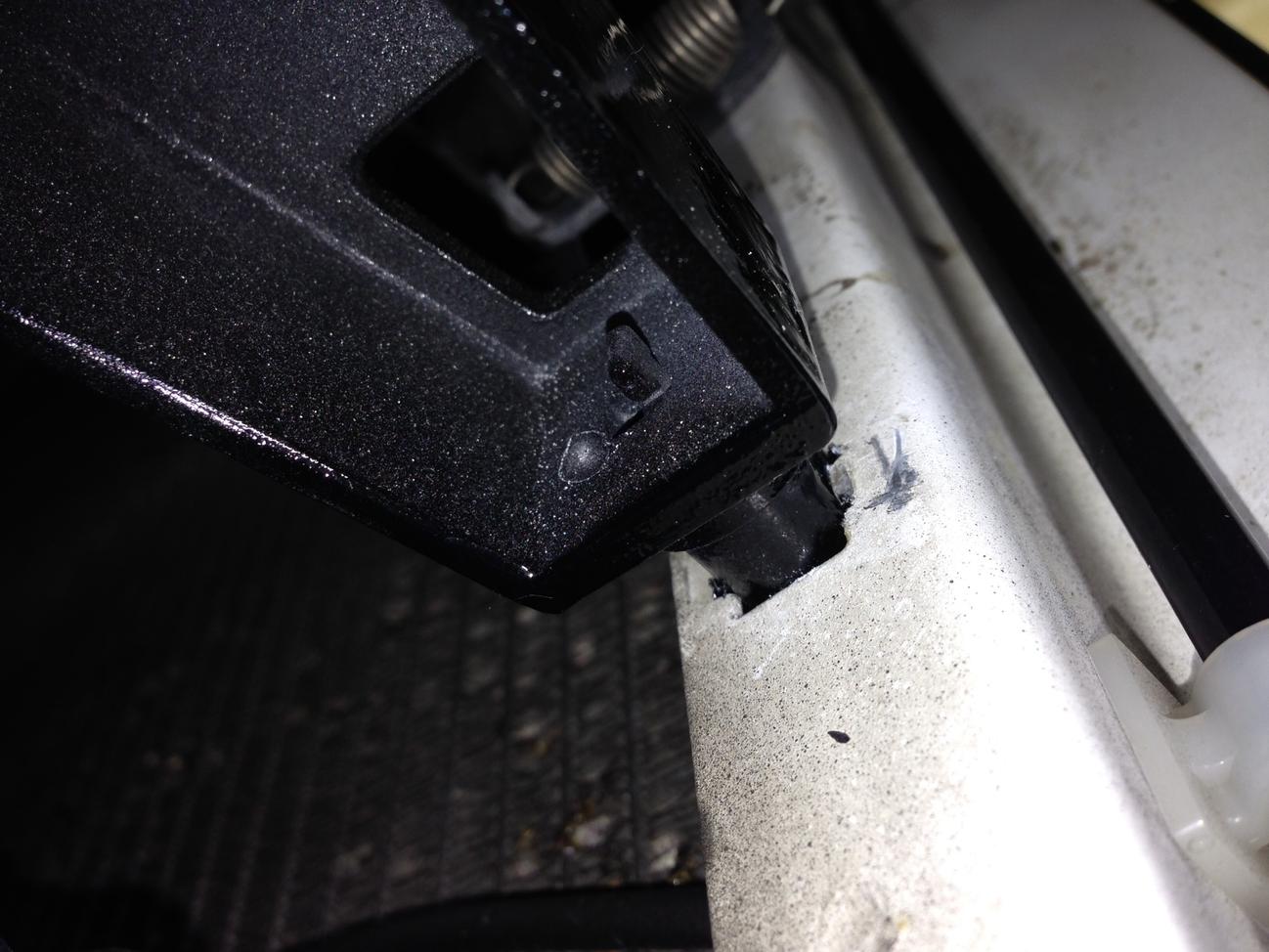

All but the bottom middle tab lines up...which might be do to what CJ80 is talking about. But that's not my biggest problem...my really problem is the tabs are too big around to fit into the mounting holes in the radiator support bracket. They only go in about an 1/8 or 1/16 of an inch. I just assumed since all the tabs were to big...that it must be due to the different year.
After hearing everyone's comments that all years are the same...I'm really thinking I just got a crappy built Chinese grill! There's no way everyone else's fits...and I have the only one on the plant that doesn't!!

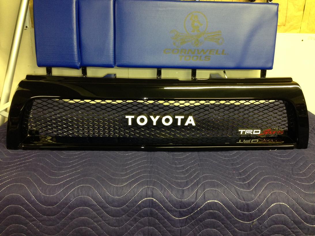

Well I guess I need to buy another grill and start over...but this time check to see how, or if it fits before I start my build. I feel like a bigger idiot then i did before! I guess I need to buy somewhere else besides eBay!
Sorry for wasting everyones time. Thanks for the help!

Looks like a lot of work put into the grille. And looks good. I wouldn't start over. Try trimming the mounts of the grille slightly or enlarge the holes on the 4runner. I couldn't imagine that if was manufactured wrong that it would be off by too much.
^^^^^ I would just shave some of the inserts off with a dremel or something.. that grill looks nice!!
Wow the grill looks great!
It would be a shame to see all that work go to waste worst case scenario if trimming doesn't work, I would try to zip tie it in place.
Yeah I guess I should try that first. I had thought about that before, but was concern on how to get it to lock in if the clips get messed up. But like Yoter said...I could use zip ties, which I had never thought of.

Man, that grill is sick, Russ! I'll bet a dremel and the patience of a surgeon would put you in the black, pun intended. Give it a shot... Better than leaving it hanging on the wall.

Yup. I can tell how much time that paint prep took, nice and shiny!
When i took my grill off the first time i tried it to be careful but the clips breaking is unevitable.. so i just ripped them off the next time and have been using zip ties every since..
Thanks for all the encouragement!! You guys have me totally stoked to give this a shot. This will definitely be on the top of the "to do" list for this weekend! This is going to look totally awesome on the Toy...better than that, it will make my wife happy not to see it on the wall anymore...lol!!
