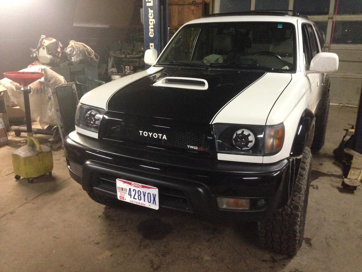

I only have one picture...which is not very good. I put the grille in at the same time I installed my new HID's. So I did it in the evening...therefore not much light in my garage. Anyway, I'll post some better pictures in a couple of days.

Looks very nice. I've never seen your truck before, very interesting. I was thinking about painting the shrouds white when I do my retro...gives me an idea.
Did you have the hood painted that black? I used plasti dip, so mine isn't glossy like yours...kinda like it.
