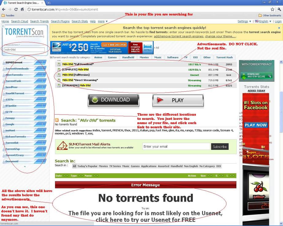

To everyone who has sent me an email looking for the .rar file for this nav system. It is no longer on any of the torrents I have searched. Now, I still have the procedure on how to get it done so you can search for yourself. You can even use this to try and find the 2010 file. I also have a copy of the .rar file but am not willing to host it on a torrent. If anyone is willing host it, tell me how we can get this done and I will do it.
  • Eclipse Nav Instructions.doc
