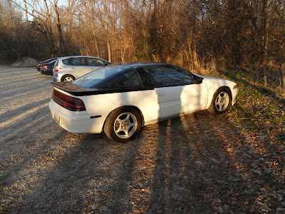

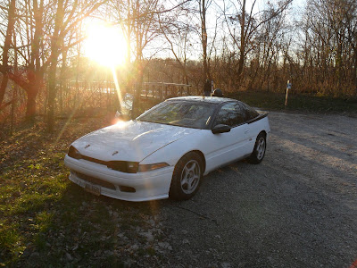

91 Talon fwd
Caged, 1 3/4 DOM mild steel, no door bars but has 2 rocker bars one inside one outside tied together, think ladder...
Delrin bushings
Baer brakes
Recaros
Custom Konis with Ground Control sleeves and billet adj upper mounts
AEM EMS
Shep Stg 3 AWD trans converted to FWD with a quaife
ACT 2100 w/SS disc
The Driveshaft Shop axles
2.0L, 122cubic inches
Evo 3 16G, exhaust manifold and o2 housing
3" Custom turbo back
HKS 272's
Lots of hard shiny bits with special coatings inside
9.2:1 compression
18psi on 93 Octane = 385whp
I normally run 21pounds or so, mainly because it boost creeps like a mother. It'll creep to 20 in August with the heat, cool fall nights gets me 22-23pounds, my fuel cut is at 25.
I can list all the mods if'd you like.
This is right after break-in, no boost control, just boost creep:lookout:
I don't have any runs with a boost controller, I can tell you I have 20psi by 3500rpm and guestimate torque in the 375ish rage @4500rpm from experience with other DSM's. I guess I know it's fast and don't care anymore what the piece of paper says. My goal was 325whp, with broad, usable power... mission accomplished lol
