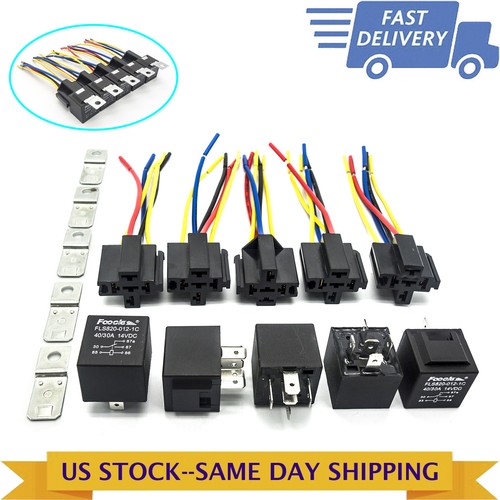

Why not use an spst "AOB Switch" and TWO 12V SPDT relays?? It'll accomplish what you want it to, cost about $10 bucks for a pk of five on ebay ( 5Pcs DC 12V Car SPDT Automotive Relay 5 Pin 5 Wires w/Harness Socket 30/40 Amp | eBay ), and very easy to connect right near the switch or under the hood(?)!
So you'll use two relays... just connect both coils; terminals #85 & 86 together (in parallel) NEG to NEG and POS to POS. And you'll have 4 poles; load circuits (2 extras), which you won't need... really simple to do, and the AOB switch will fit perfectly in the dash like a factory switch; even the back lighting will match your other dash switches!

Thanks Rigtec. I already have my wiring done though and don't want to have to re-do it to add more relays. I just want to pop a switch in ideally.
