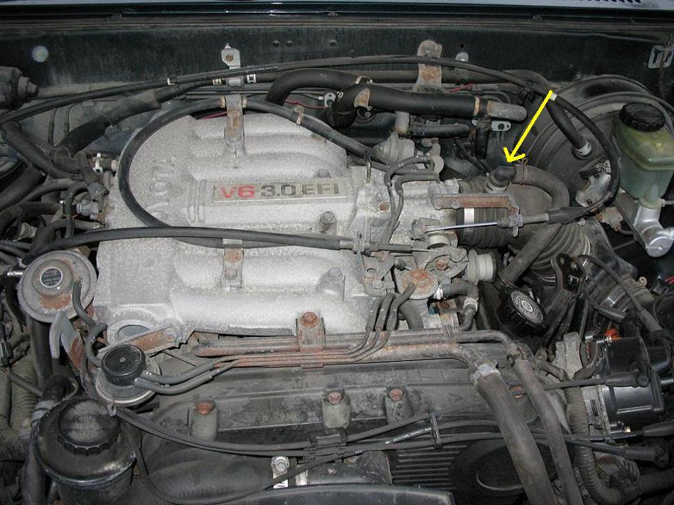

Does the one i'm pointing to with the yellow arrow work?

you can use the brake booster line going to the plenum... it feeds the manifold and thus all runners.
its located on the big plastic thing behind the brake fluid resivoir.

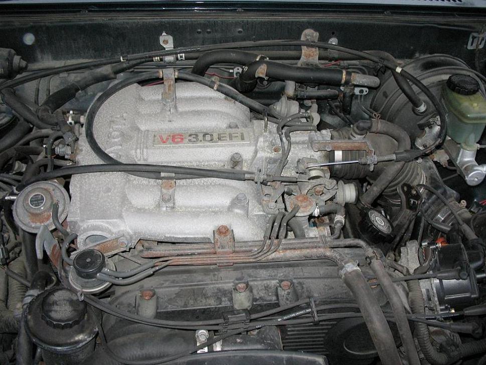

Oh, okay, so it would be where the red arrow is pointing then right? Sorry, for being so slow, I just want to make sure I get this right. Thanks for all your help
Sorry about missing this thread...it kinda fell of the map.
Yes, you can use that hose, but do it at the other end, where it connects to the intake plenum.

Thanks for all your help guys. I did as advised and followed that hose to the other end and sprayed in the Deep Creep. This last pic shows the exact location where I sprayed it. I only used half the can and the rough idle problem has definitely improved but has not been completely eliminated. I'm going to use the other half can tomorrow and if anyone else knows anything else I should try, I'm all ears. Thanks again guys.
