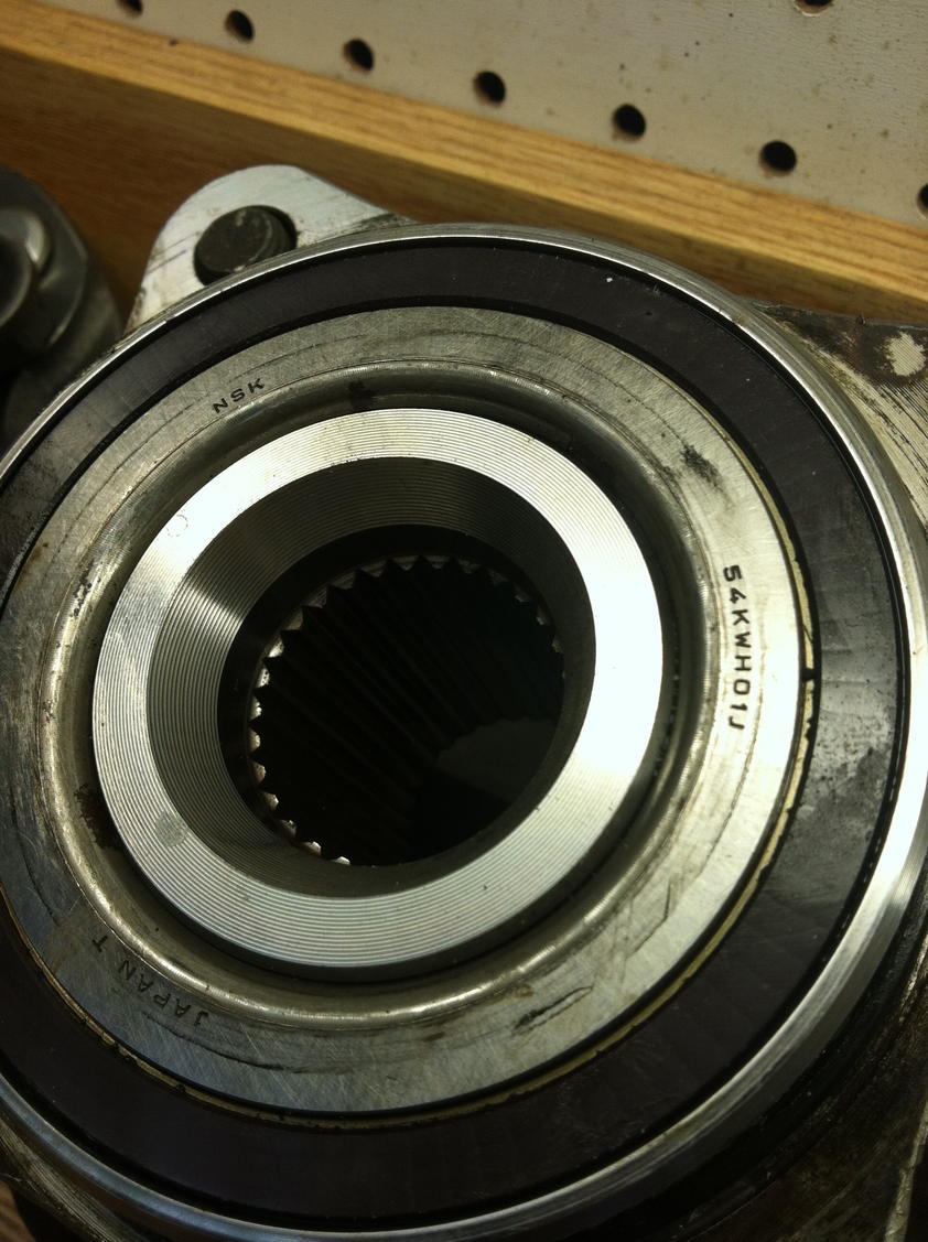

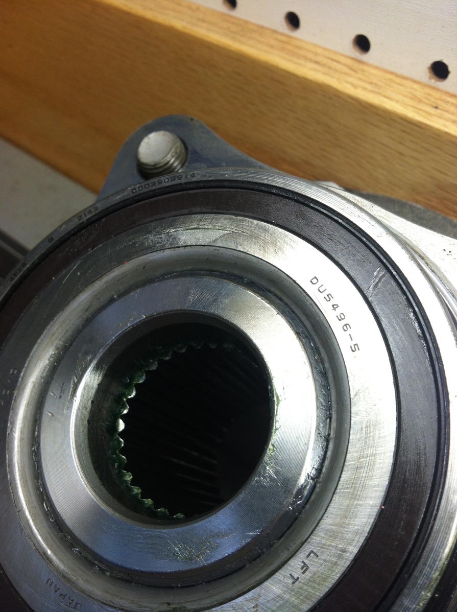

Meanwhile, I noticed that the flanges inside the inner bearings are different. Andy says this is not a problem. Again, what do you guys think? Factory bearing is top pic.

Looks to me that the OEM bearing is tapered up to the splines vs. the other bearing that has more of a corner edge to it. Does the CV shaft have a taper to it as well? That could be the issue right there.
That is correct. The factory flange is easily twice as long before going vertical into the splines. New bearing has a small taper and twice as much vertical space into the splines.

I bought the Dorman hub, it's the exact one Antman purchased that's shown in his pics. I've been E-mailing BPB and Andy said the difference in the flange that's inserted first vs factory shouldn't make a difference on fitment. I e-mailed him again today asking if I should have gone with the all OEM one or if that would've made a difference. The splines on the OEM one definitely are longer and have more surface area, if that makes sense. They look shaped the same.
