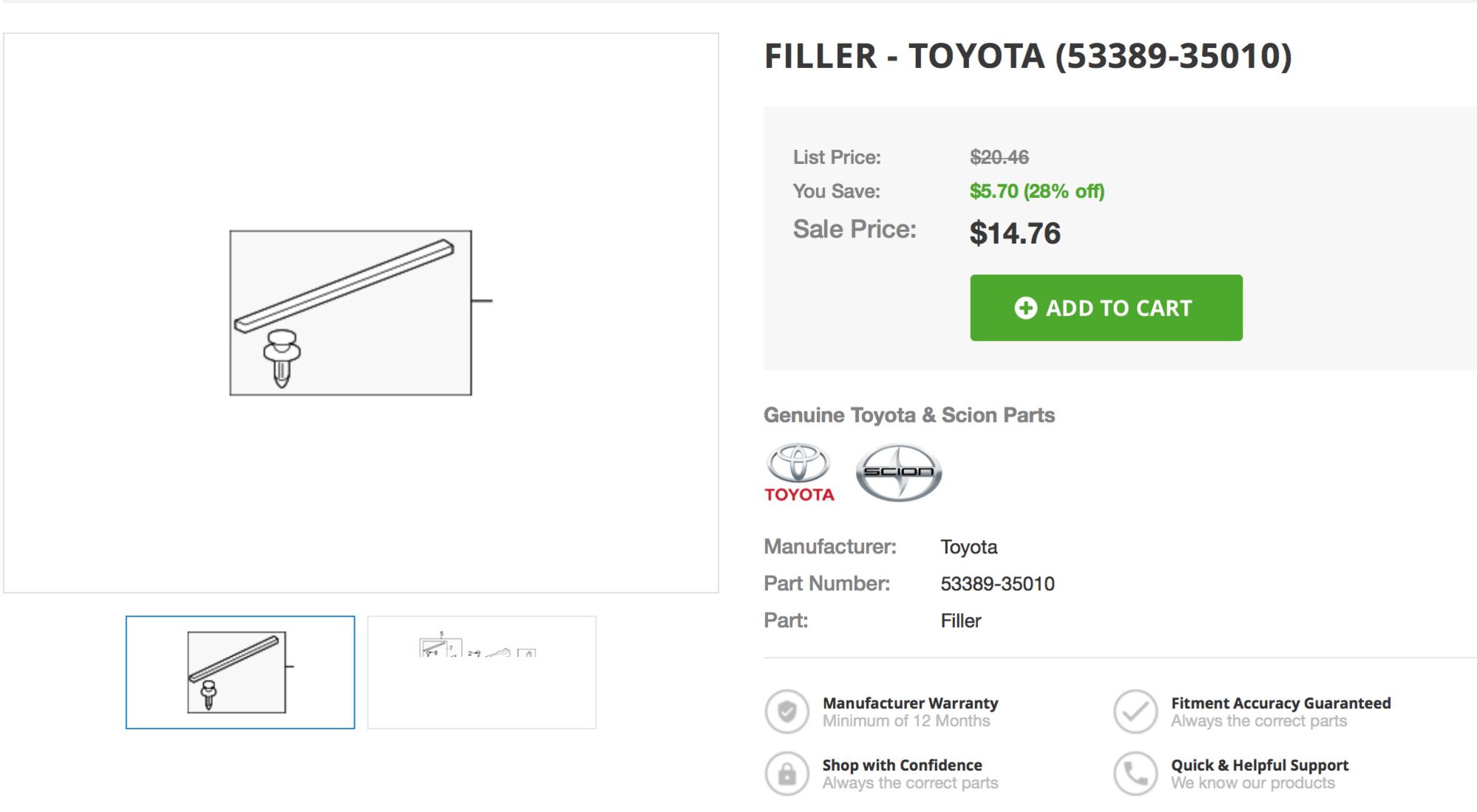

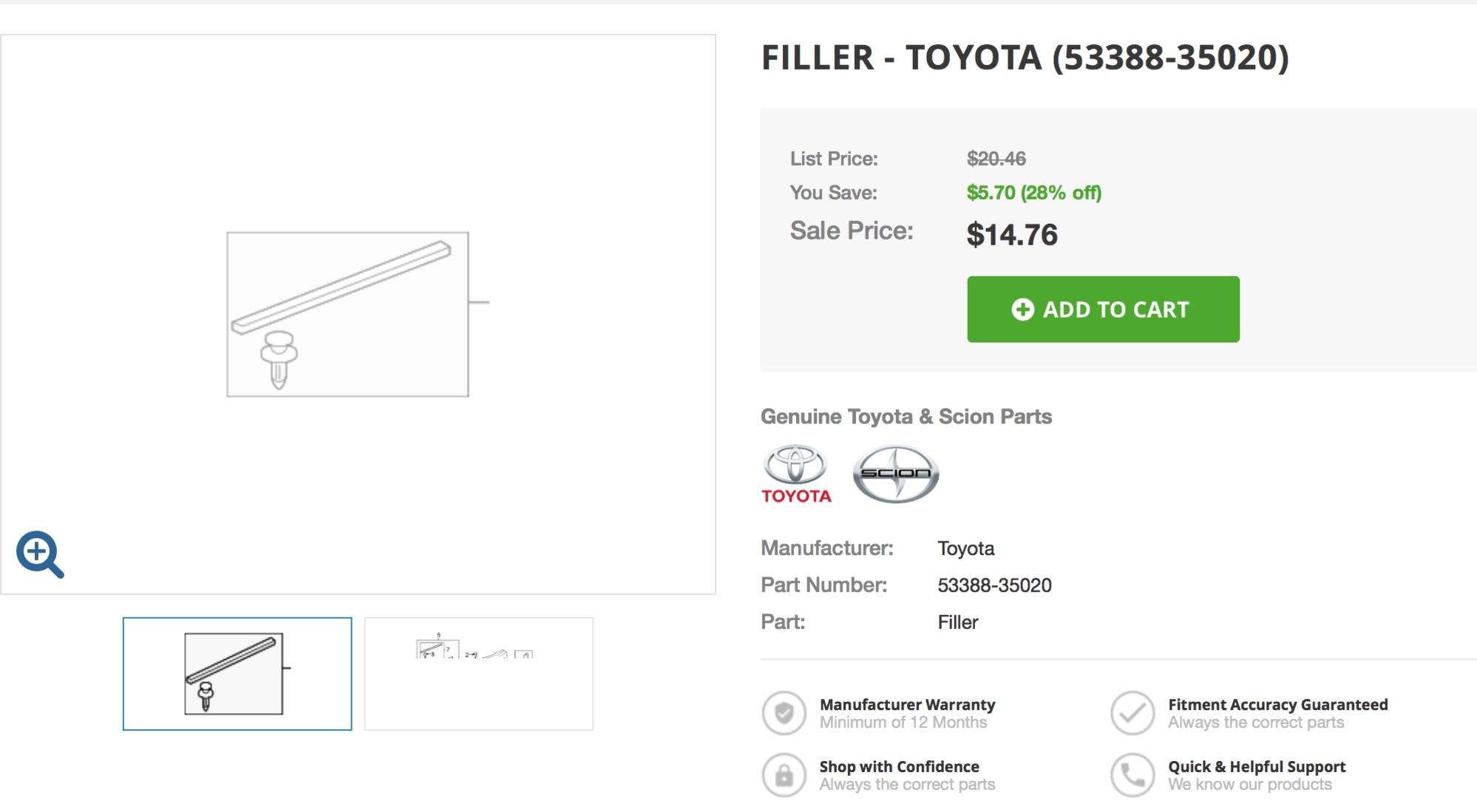

From your photo, it looks like you need the drivers side. I'll list the P/N's and applicable quantities anyways.
*The plastic and weather striping is considered to be one piece from Toyota*
Driver side: 53389-35010

Passenger side: 53388-35020

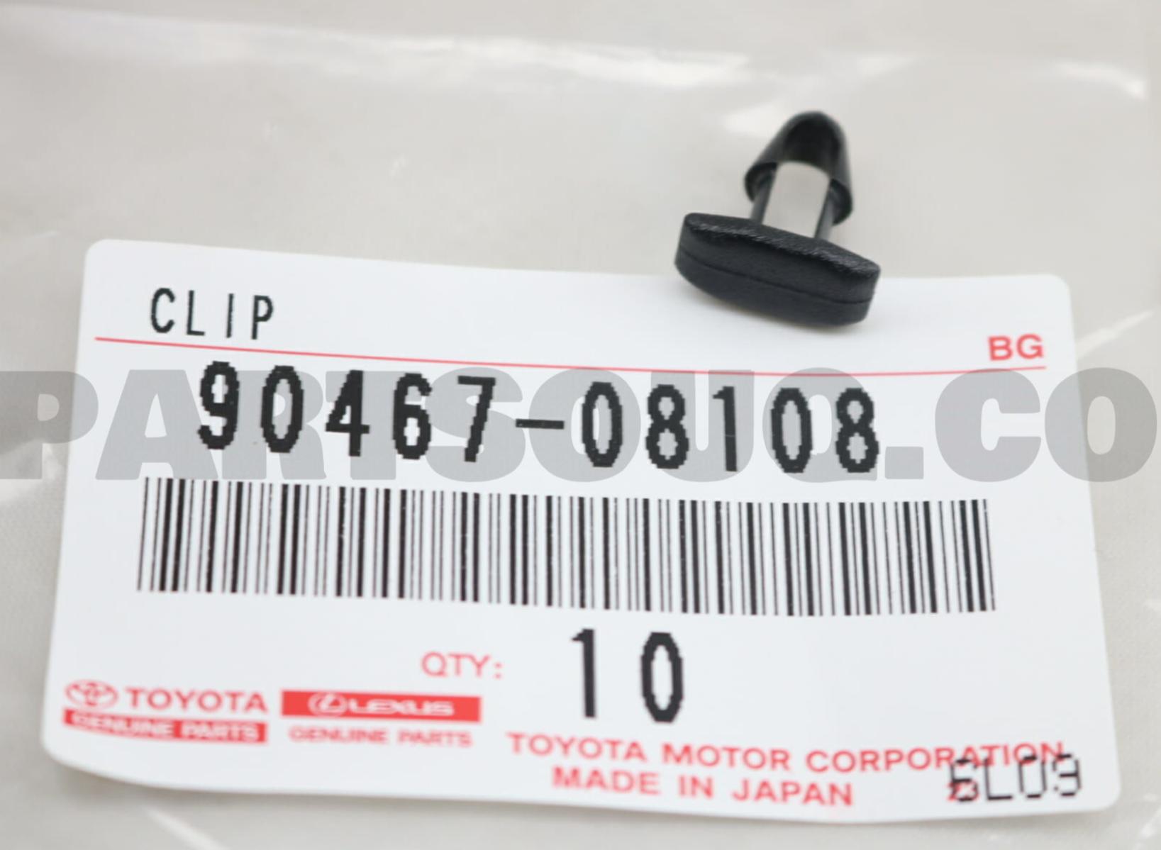

Clips for weather striping to plastic (4 per side): 90467-08108

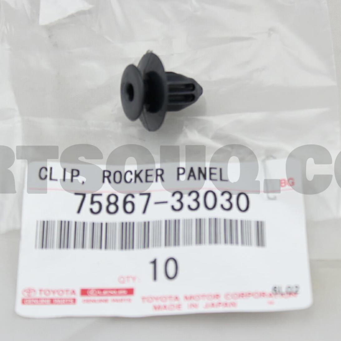

Clips to attach plastic to fender (3 per side): 75867-33030
