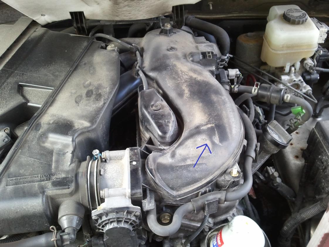

I took a picture of the following engine part that i need help identifying, it's located under the plastic engine cover. I've noticed a loud ticking sound coming from here after I drive the vehicle (doesn't tick when I initially start the car). seems to go away once I turn off the car and restart it again, but comes back after driving a short distance. The blue arrow points to the part.

That is not the intake manifold. That bolts to the intake manifold.
Toyota calls that the inlet surge tank. Most of us call it the intake plenum.
The ticking noise is likely the EVAP control valve on the side of it with the big hoses connected to it.

^correct. The fix I posted is to isolate that valve and [theoretically] reduce the tick-tap noise it causes.

Your intake manifold should be fine, it serves to draw air into the engine and doesn't have any parts that would cause a the tick-tap noise. The ticking caused by the EVAP control valve is normal and I'm afraid that if the fix didn't work, there's not much you can do about it.
How is the car running otherwise? Is the noise constant? Can you hear it from the cabin? The only other ticking I can think of would be some valve noise or possibly piston slap.
Valve noise can sometimes be remedied by using an oil with a higher zinc content (high mileage engine oils) and piston slap is apparently normal during cold starts (at least for the V8).
