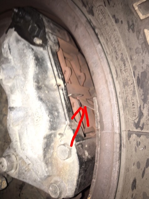

Alright I finally lifted the runner and found the source before heading out to work today. (I haven't messed with front brakes at all so forgive for not knowing what it is called). But i found out it was this metal tab thing that is loose and flopping around on the lower end, I think it has something to do with the anti rattle spring? Anyways it seems pretty simple and I'm glad it isnt going to cost an arm and a leg to fix. I'm at work so I can't really look into it but does anyone know what I need to do to get it secured again?
