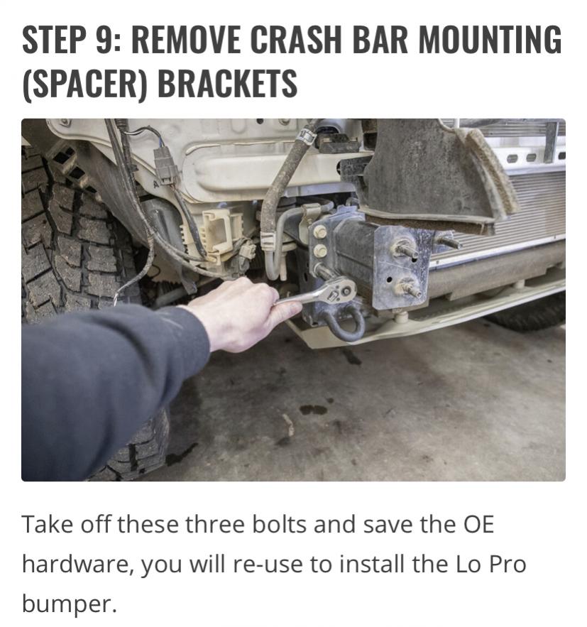

Need help in finding a bolt size (front bumper)

M10 flange head I believe, not sure on the length. But if you overshoot the length a bit it shouldn't matter, the end will pass through.
FYI, I had a hell of a time trying to get one of those bolts out when removing the original crash bar. I broke a wrench, stripped the bolt... Blow torch is your friend there, using that from the start would have saved me a couple hours of tinkering.
Good to know! Thanks for the advice!
Update here as well. I was able to locate these at a nearby Toyota dealership. It was $14 for all 6, and I figured $14 was low enough to save my time on trial and error in the Home Depot parking lot.
That was smart because, IIRC, those bolts have a different pitch from your "normal" 10mm bolts... I want to say 1.25, maybe? I had to make a few trips.
