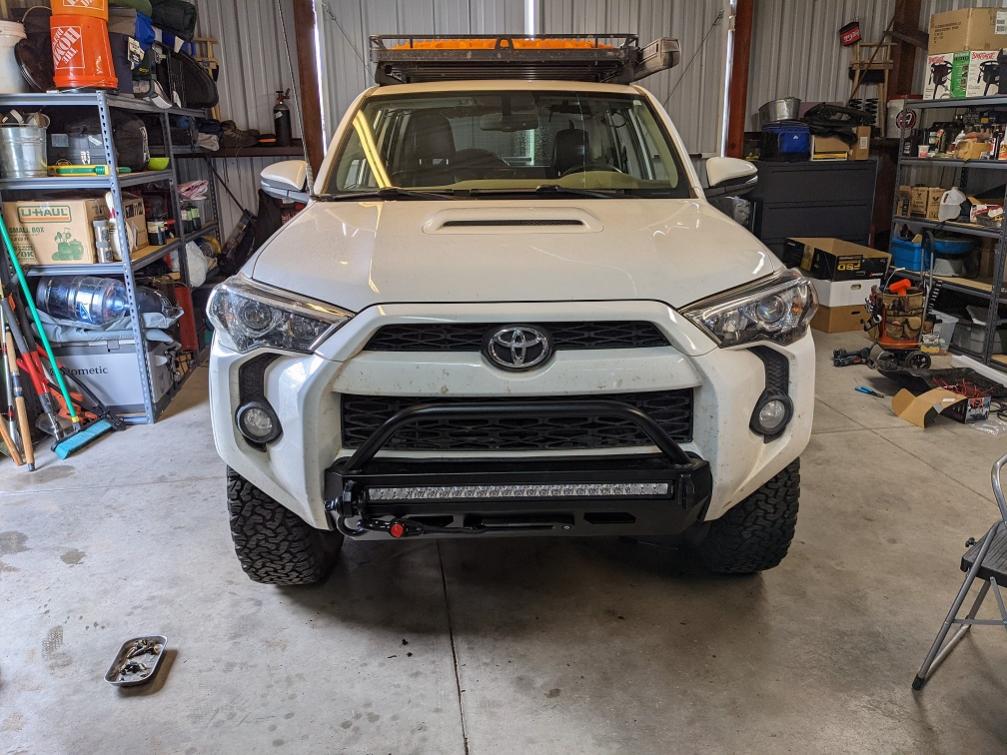

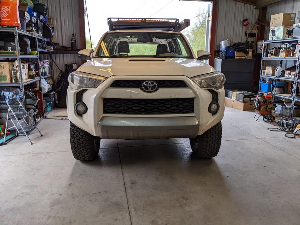

Thought I would share some details on the SSO Hybrid install with Warn M8000. Overall the bumper fit very well and was easy to cut/install the plastic off the stock bumper to make it fit. A friend more capable than I was required =).

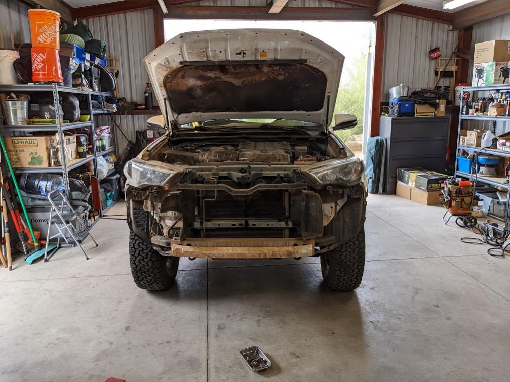

Removing the bumper was pretty simple and we just followed overland wanderlusts's directions on their video How To Install Slimline Steel Front Bumper on 5th Gen 4Runner - YouTube

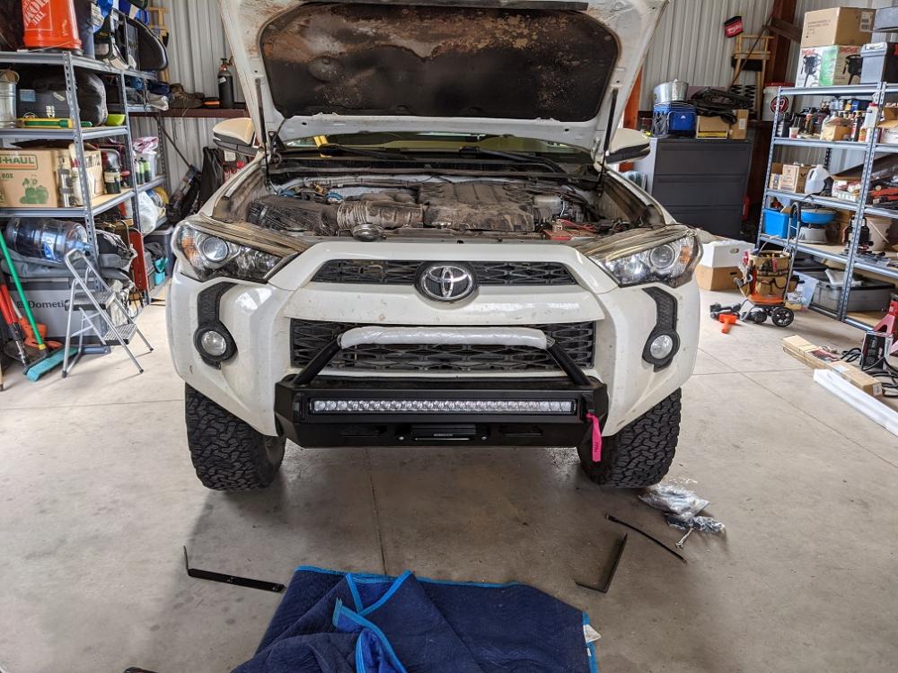

Next step was to test fit the bumper in place and to get an idea of how much space was available for the Warn M8000 winch. Once in place the AC line was clearly in the way and the control pack needed to be located. I'd seen pictures of people doing a metal plate over the radiator, but it would be hard to reach to plug the controller

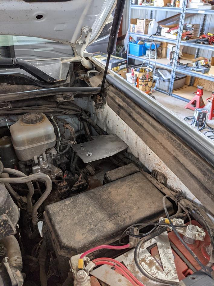

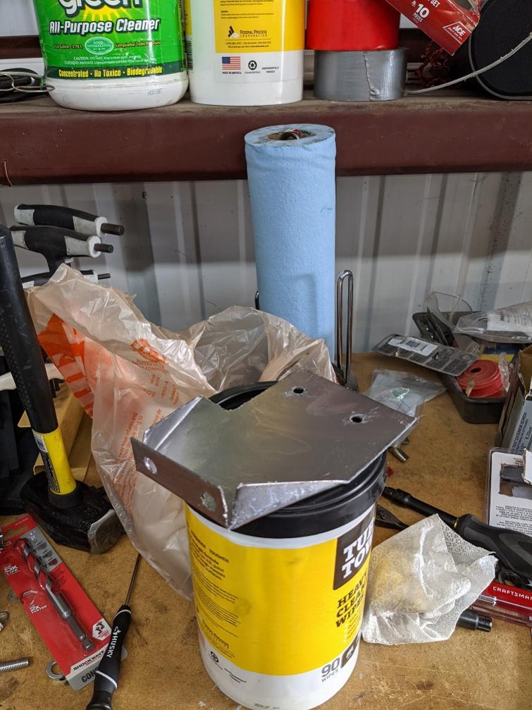

Looking around the engine bay we decided to place it behind the fuse box . My friend was able to fab (cut and bend) a metal plate from Ace hardware to specs and use two existing threaded holes in the side panel. We also painted this with a hammer finish spray paint. The plate does give but the cables coming down give some support as well. The fuse panel lid can still come off but takes some careful persuasion to clamp back on but still does. May need to change this but it holds pretty well. The controller is in a much more reachable place vs feeling around in the dark where the winch is.

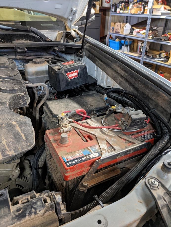

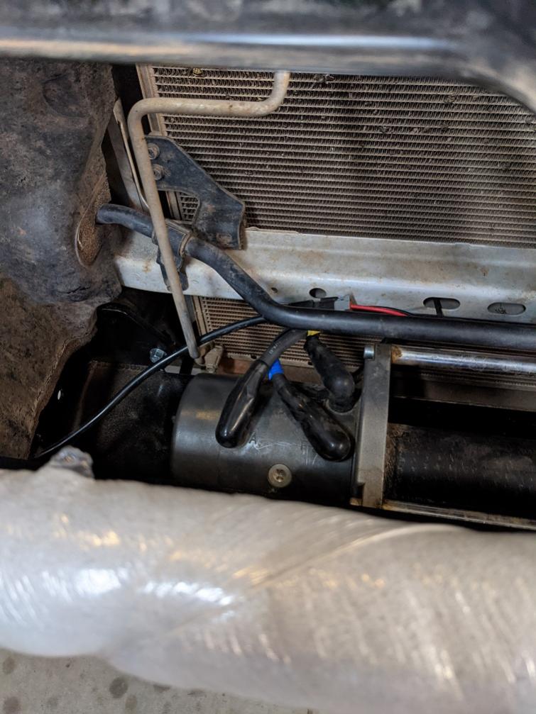

We had to replace the existing wires with 2 gauge wire and terminals at about 5-6' for each of the three lines. The control pack disassembled pretty easily. We had a specific crimper for larger copper terminals that was very helpful. Finding 2 gauge wire and then the terminals required 5 stores in the greater phoenix area. Three of which were just for the terminal size gauge and post fitment. Got some color coded vinyl tap to ensure we didn't get the wires crossed. The wires come down from the battery and then across to the winch connectors with some wire loom in two places to keep things from rubbing on metal edges.
When putting back the plastic bumper the air dams for the radiator did not want to fit with the new bumper on the driver side. So we cut away until they did. The directions from wanderlust overland you tube video took them off altogether but we didn't like that idea.
The Heise light bar (30") install with rigid wiring harness was mostly straight forwards except the skinny nut for the bolt required some low profile box wrenches. The space between the metal bracket and side of the bumper is very narrow. Luckily cheaper Ace hardware ones did the trick as you aren't going to find those in a box store. Of course I had to get a set of those vs just the 13mm I needed. I almost returned them after the job.

The install was likely 8 hours with 2 more hours driving around looking for parts. Not really difficult save the bracket which I knew I would need help with and then just time and patience.
