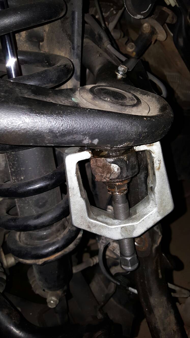

Advance auto loaner kit #3 front end service kit. Contains a ball joint separator.
Pickle forks weren't working. They aren't thick enough. Trying a ball joint separator now still not coming lose.

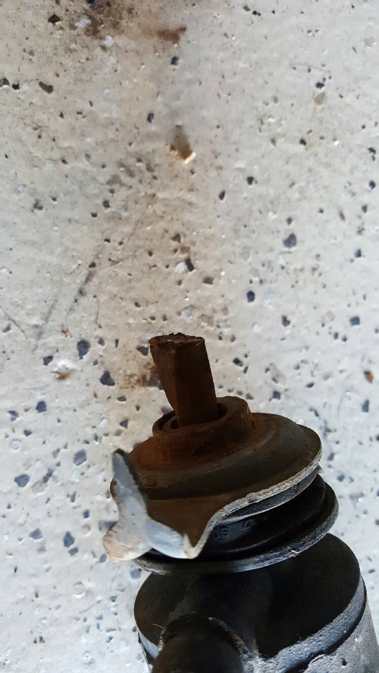

My next issue is removing the rear XREAS shocks. The upper nuts won't break. I'm holding the housing with a pipe wrench and the bolt and threads are moving separate from the body.
I've seen some guys end up just cutting them off.

Cut the dust boot and hold the shock stem with channel locks. Should work to break loose the nut.

Yeah that's what I'm trying now, hasn't come lose yet...my pattern is tighten, hit with mini sledgehammer a few times, tighten some more and repeat. No luck yet.

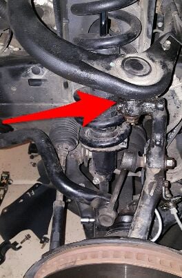

Hmm..maybe try jacking up under the LCA, to put the balljoint at a better angle.
The castle nut for the ball joint is removed right?
Thanks, yeah tried jacking up the LCA too. And yeah, castle nut is free. I still have it on so when it all breaks free it catches the steering knuckle. There's 1/4-1/2" between the nut and the knuckle now. Picture just doesn't show that cause the angle.
Just spoke to a Toyota tech that works on lifts all the time, he says a heavy hammer always works just have to hit it hard enough just right.....so I guess I'm going to hammer away. He said to hit it towards the front on a little machined flat area.

The rear shocks had to be cut off. I was twisting the whole shaft so those bolts weren't coming loose

I had a heck of a time getting the ball joint to separate on one of my UCAs. The good thing for me was I was replacing with the UCA so the upper ball joint condition on the old one didn't matter too much. I soaked it in PB blaster several times. Pickle fork and whaled on it with a hammer did the trick. It did take a while. I tried the 2 jaw puller, and also an air hammer with the pickle fork attachment around the spindle area as well. I think the air hammer may have loosened it a little.
Edit; the air hammer pickle fork kit I have is similar to this; https://www.amazon.com/Lisle-41500-Fork-Kit/dp/B0002SRG4S
Don't be shy with the PB blaster, spray it up from the bottom and down from the top, soak it. Hopefully letting it soak in overnight helped loosen it up some. Blast that nut tight and loose a few times with an impact gun, might have the hammer effect and break it loose. The only other things you have left at this point are heat applied to the spindle (also helps to heat and quench with PB blaster, it'll suck it back into the crevice between the two parts) WARNING be careful of catching the boot and/or grease on fire. Or go to cutting it off/drilling out the center of the ball joint stud to weaken the press fit.
