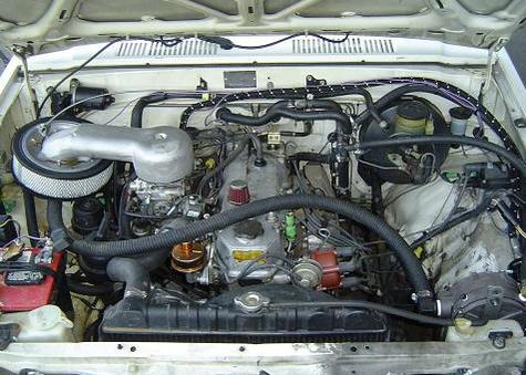

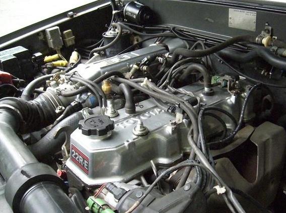

Yeah the 22RE will have "EFI" on the throttle body, all the EFI attachments on the throttle body and a "22RE" plate on the front. The head on the 22R will look a lot different and have the carb off to the side.
Woah :wow: Huge difference. I wouldn't think there's any way to really mix that up if she even looked at the new engine, once...briefly. I'm really curious now.
