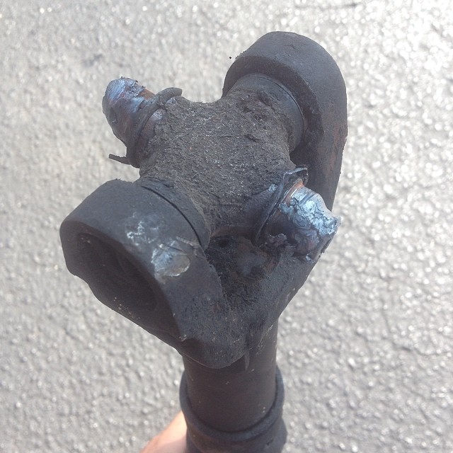

A little example of what can happen when you ignore a ujoint thats been chirping the whole offroad trip. It can blow up on your drive back home going down the highway. Basically all grease was evacuated over time from water and mud. This was on a jeep tho.
