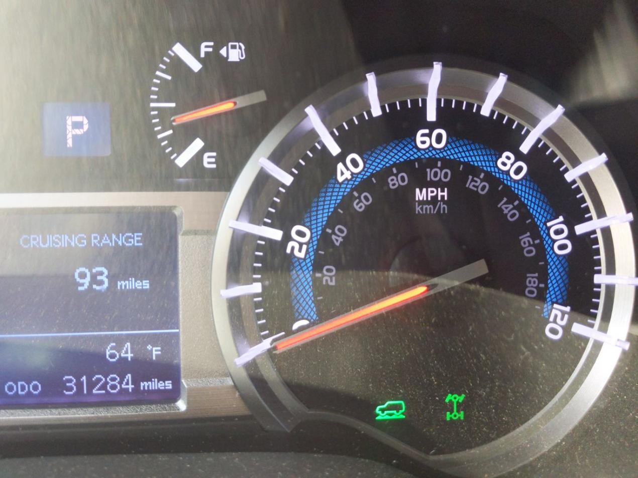

The Multi-terrain Select Indicator and Four-wheel drive indicator lights are flashing. The first slower than the second, but both flashing. :frog: :frog:
I have a 2016 4Runner Trail Premium.
Here's what I've tried so far:
  • Put the 4wd mode selector to 4Lo. Drove in Reverse for 100+ ft. Also drove forward for 100+ ft Did the same for 4Hi. Tried this a few times over. No luck.
  • Checked the fuses, both in the car cabin and in the engine bay.
  • Scanned and cleared any and all codes a few times using a BlueDriver Bluetooth OBD2 scan tool.

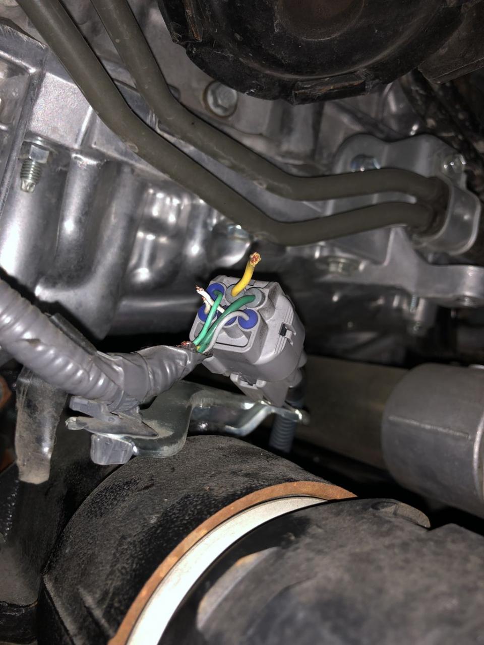

Thanks for the tip! Just dropped it off to the dealership in Sunnyvale, CA. I've had them work on stuff before, so let's see how it goes. Good time for that airbag recall too.
Dealer chased down the wiring and signals and found some of the wires for the front differential actuator cut somehow. Wtf?!?!? They're going to solder and reconnect them again and check again.
