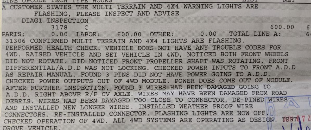

Circling back with the group. I'm $600 lighter in the wallet, but the problem seems to be fixed. Here's a summary from the dealer...
nice update!
well Toyota Surprise just called me
They told me that my issue is actually the front differential actuator and it has gone bad.
The told me that it is also covered under the powertrain warranty.
The part will not be in until Thursday so we will find out more then but if that is the case, then Autonation Toyota did 100% misdiagnose the issue to be the master solenoid and also was going to charge me $2000 to not fix the issue.

picked up the truck last night.
it was a breath of fresh air (even though it was 112 degrees outside) to have no lights on my dash!!
4 high and low work as well as all my MTS features!
and it didnt cost a dime!! whoooop! toyota of surprise!
so long store, my issue was my front diff actuator had failed.
Sorry to resurrect an old thread but I wanted to chime in since this thread helped me. I have a 11 TE with 90K miles. Putting it into 4x4 High/Lo did not work/would not engage, and the lights flashed on the dash as mentioned in this thread. I wanted to say that it was also my A.D.D (Part # 41400 35032) which had failed.
