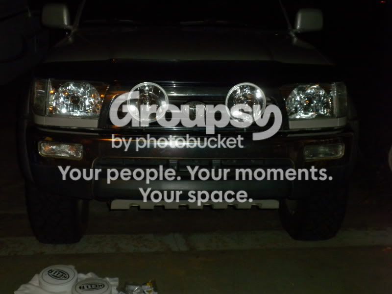

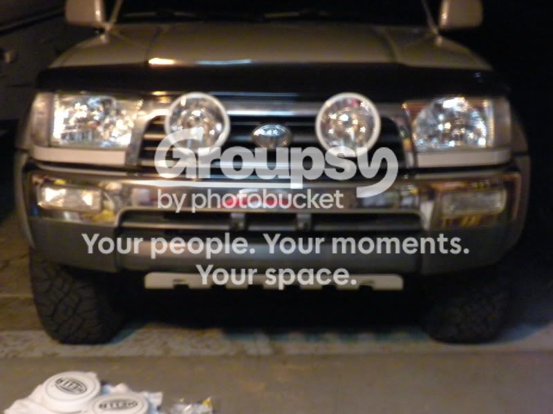

Alright. I was able to take some pictures tonight. Some of them didn't come out very well (lighting, etc...), but I think you'll get the idea.
Finished product:

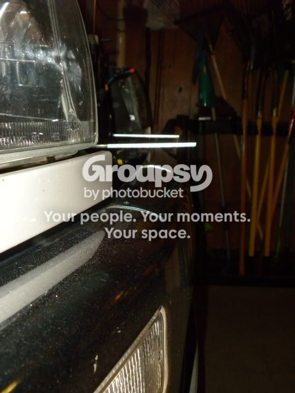

Showing how close the lights sit to the grill:

Showing how far the brackets stick out (they are the same length):

It's probably not the cleanest install, but it gets the job done. Considering what I have to work with, it will do.
Let me know if y'all have any questions.
