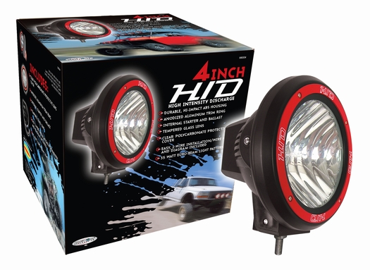

Clemson, haven't heard from you in a long while! how much are you looking to spend? cause the thought crossed my mind too to get HID's too but i kinda wanna keep my DRL's (kinda not) but i came across these HID driving lights you can mount in your lower grill area?
I have the PIAA 520's and from what i remember the lights arn't too hard to install, one conncetion goes to your battery one to a ground and one to an electrical source (i just hooked to one of the bults in the fuse box) but there are some smarter people that know their stuff that just hook it to a source that turns off when the truck is off but yeah check out these on amazon there about 2 bills and some change i think

Thanks for the link Niles. That helped a lot. Still not sure if I want to drill into my bumper, but it's looking like that's the only option.
