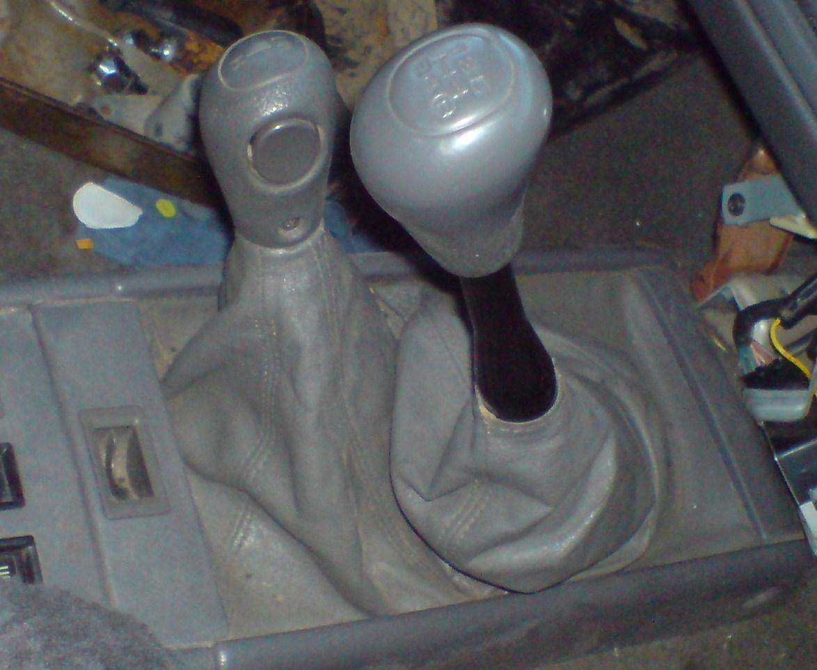

Hey Guys thanks for the help i had a look and i believe that i have found the problem as there is power to and from the switch but there is no power coming out of the "computer 4wd control" so i think it is broken.
I have included a picture of my button which engages 4wd for refferrence.

It has ADD (Automatic Driveshaft Disconnect).
The front left drive shaft is connected/disconnected from the diff via vacuum.
If the drive shaft does not connect the light wont come on.
It could be a vacuum problem,
