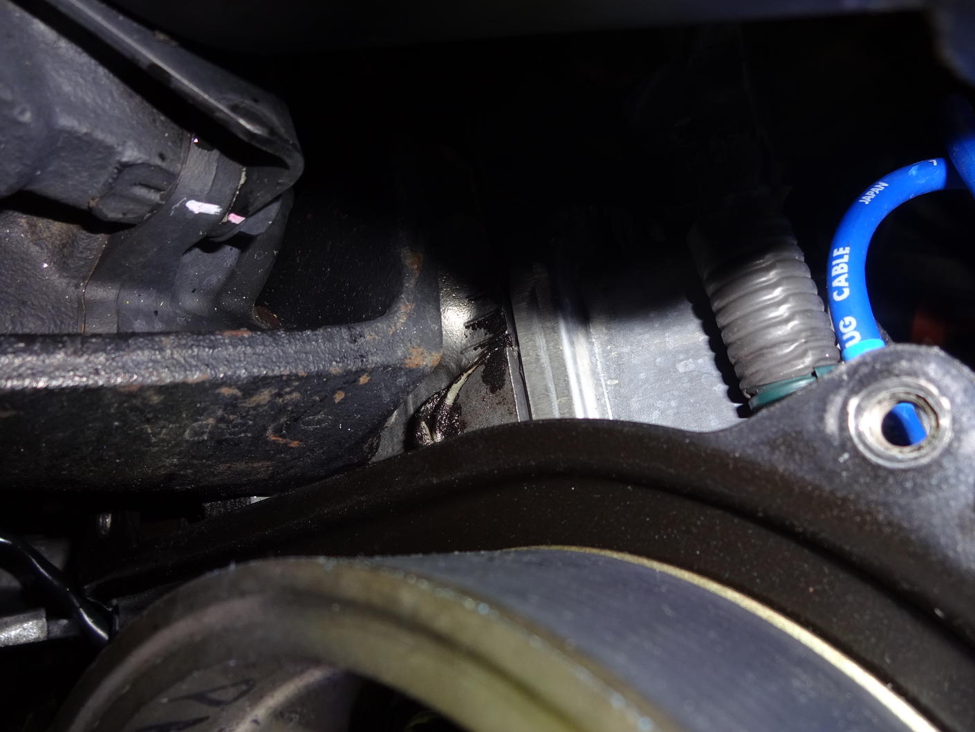

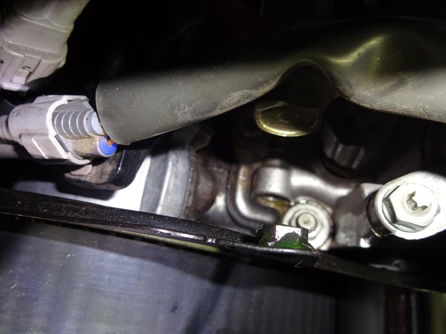

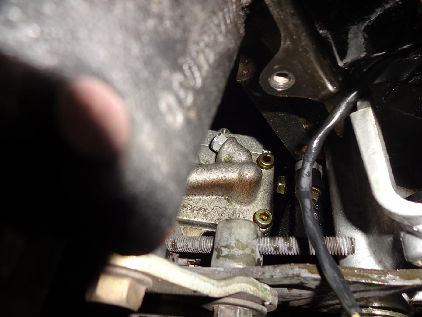

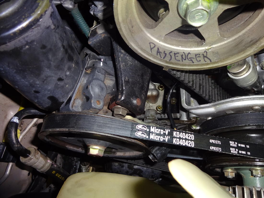

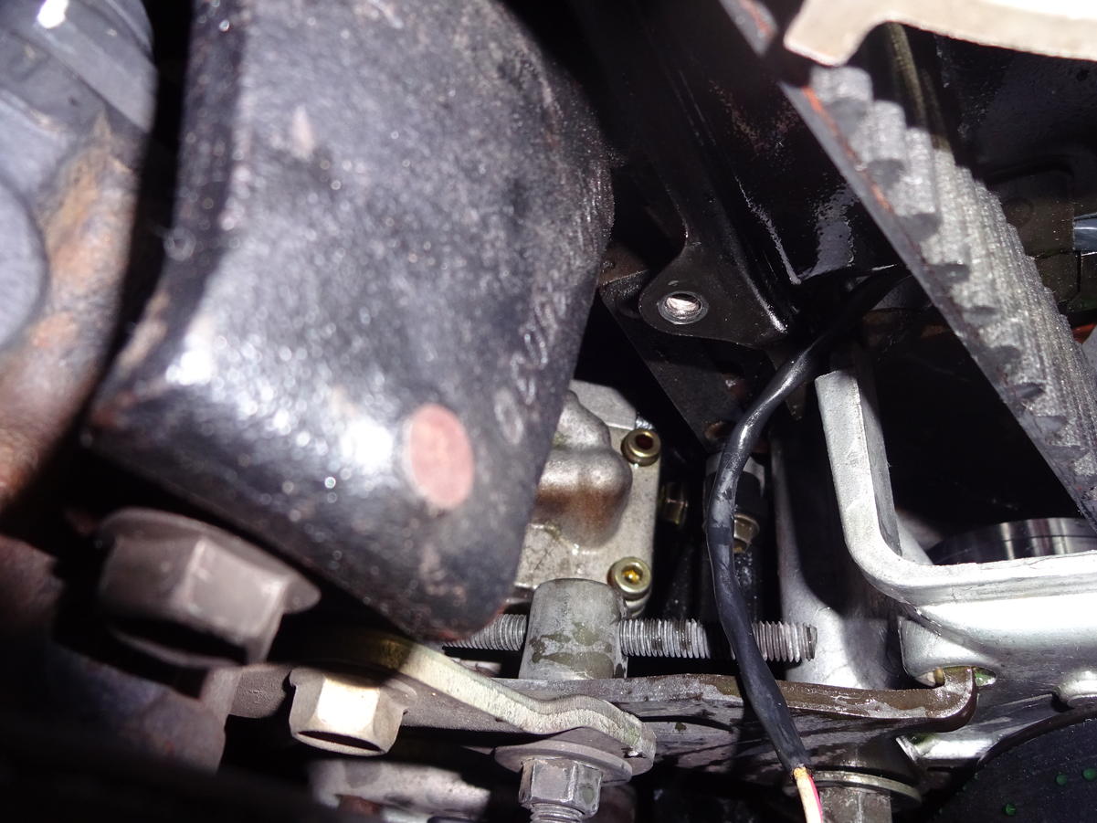

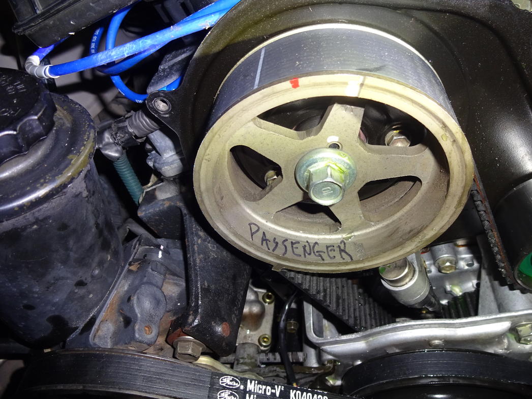

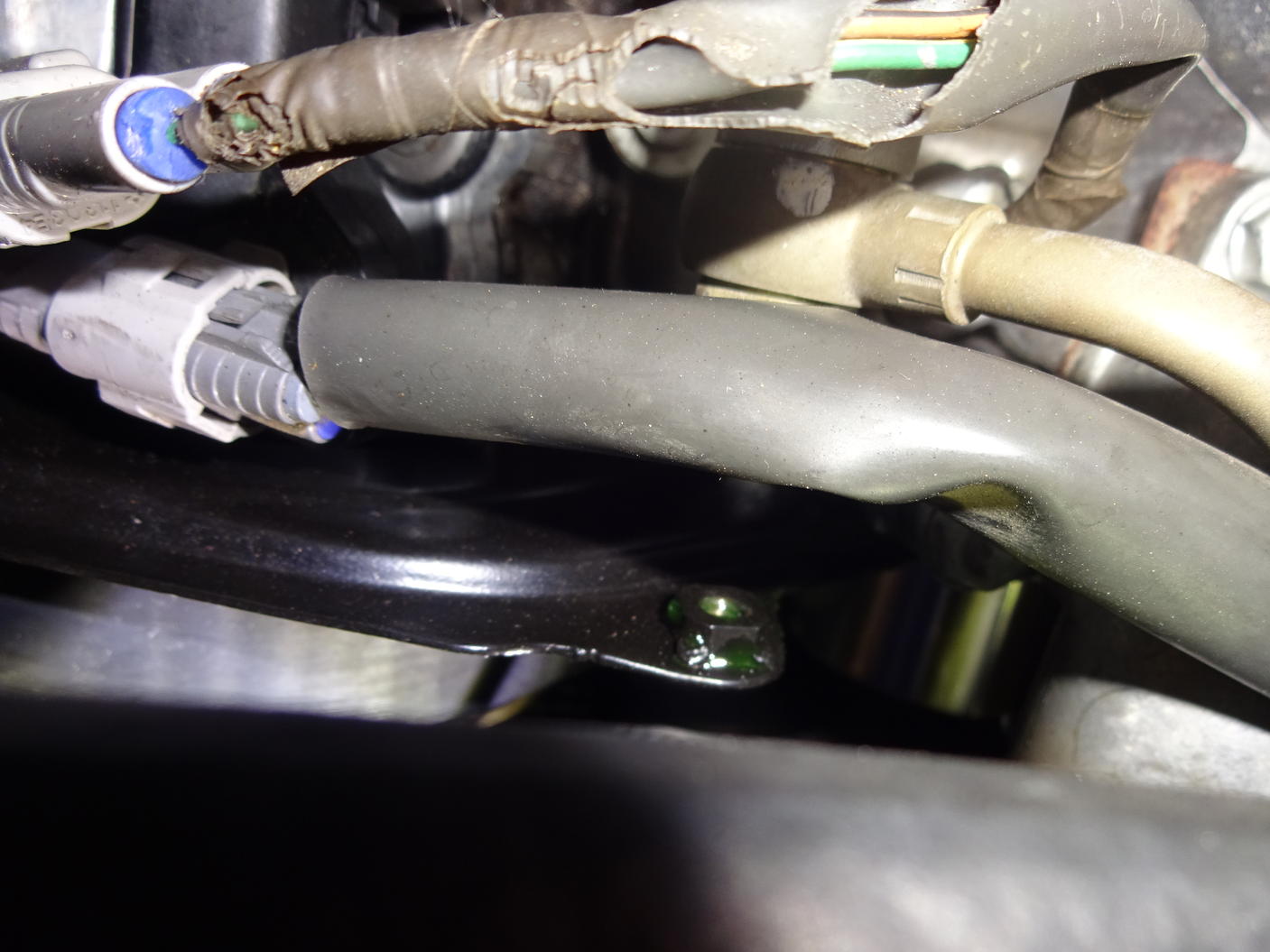

Another update. I see some fresh oil inside the socket head bolts on the top of the a/c compressor. That is under the center front of the passenger side VC. Perhaps I have a leak there, although I don't see any oil around the front of that VC, to either side, where it is visible. If that is the leak, it is covered by the rear metal timing belt cover, but I would have to remove the timing belt and cam pulleys to remove that cover and verify completely.
The problem is that when I removed the upper radiator hose so that I could remove the upper TB cover, some coolant ran down, even though I drained about a quart of coolant prior to removing the hose. Some of that coolant ran down inside the lower TV cover (grrrrrrrrr - not good, and I will pump some air down there with a fan to dry it out), but also that coolant ran down onto where I was trying to look for fresh oil, so now when I see wetness, I have to determine if it is oil or coolant. Not always easy to do.
Another quesiton: If the front crank seal is leaking, it seem that some oil would be on the outside face of the timing belt. Am I thinking correctly? Especially if I am losing a significant amount of oil. It isn't just a little drip.
Here are pictures of what I just uncovered. You can see oil in the sockets of the socket head bolts on top of the compressor in the top 4 pictures. The other pictures were my attempt at showing other aread that were dry of oil. Bad camera angles in some of them. My T4R is up on ramps and I am on a step ladder with a flashlight.

My guess is the front crankshaft seal. A few months back I blew the one out of my '96 and when replacing it with an oem seal it went in way too easy. Removed the new oem seal and went with Napa seal. This one fit a lot tighter.
I've noticed this when I did the front crank seal on the 96 and also installed a napa seal.
Here are pictures of what I just uncovered. You can see oil in the sockets of the socket head bolts on top of the compressor.

Also, looks like you are running green coolant from the photos. Our rigs tend to dislike the green stuff. If you have the time and money (now or eventually) I would recommend a coolant flush (Thermocure is great) with distilled water and replace with Toyota RED and distilled water. Good luck man and stay positive. If there is an answer to be had, it will probably be on this forum!
Ok, get about 5 cans a brake cleen spray it everywhere you see wetness.
Even spary it down where the CS is. Even though it is somwhat sealed there it should find a way out. Might be able to just loosen the bolts that hold that cover on and back it off against the dampener. Not sure though as maybe the dampener will be in the way of some of the bolts which I think it is. If you had some compressed air that would be the way to go.
No need to take off the inner timing belt cover. It really looks like it might be running down the back side of that inner cover from the VC cover. There's a gap there where some wiring runs. Spray that whole area down with Brake Kleen and get it nice and dry then start up the truck and watch that area on top of the AC compressor. My money is on your Passenger side VC gasket (or cover if it's cracked) by looking at the pictures
If you can't see oil under the cam pulley running down the block I doubt it's the cam seal. When the 97 crank seal leaked it just filled the skid plate with oil. Didn't blow all over the place.
When I do valve cover gaskets I retorque them multiple times. Until their all tight and stay that way. I'd pull the passenger VC and seal the half moons properly and buy new grommets for the VC bolts and do it again following the torque sequence in the manual.

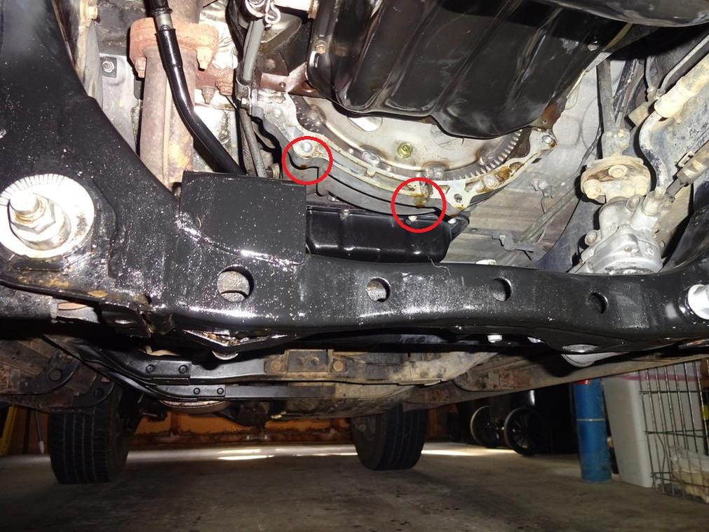

Looking at the photo the OP took of the inspection plate being off, it looks like there is oil running down the back somewhere. (See pic with red circles)
I will study that more closely, but I think that is just oil that ran or was blown back from gravity/airflow. I think it is only on the bottom, and not on the now-exposed aluminum face under the inspection plate. But I will study it more.
Yes but it's also in the front. If the oil leak were solely the cam plugs it would not be in the front on his AC compressor. The plugs could be leaking too though but it's definitely not the main source of his leak now.

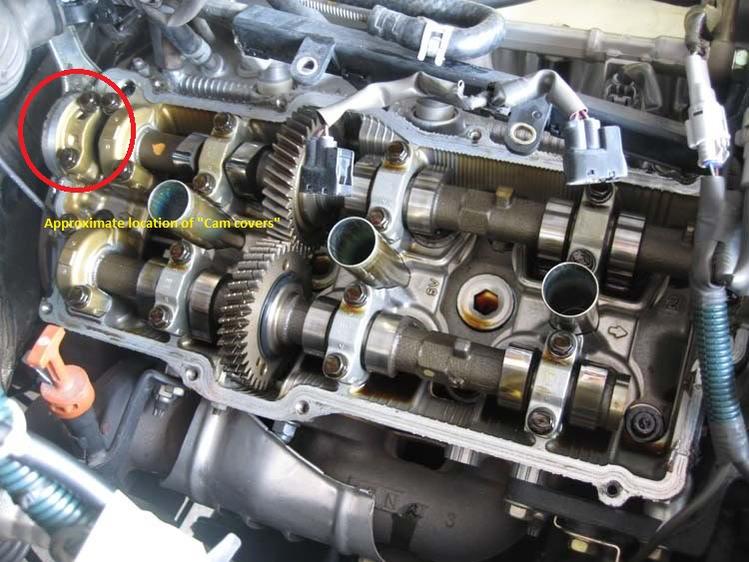

I will replace the cam covers, once I identify them.
The cam covers are at the rear of each valve body. They are held in with a "bridge" with two bolts. You have to remove the two bolts, remove the "bridge" and you can reach in and grab the covers and pull them out. Clean up the grooves they sit in and clean them up as well. Use FIPG to reseal and torque to factory specs.
