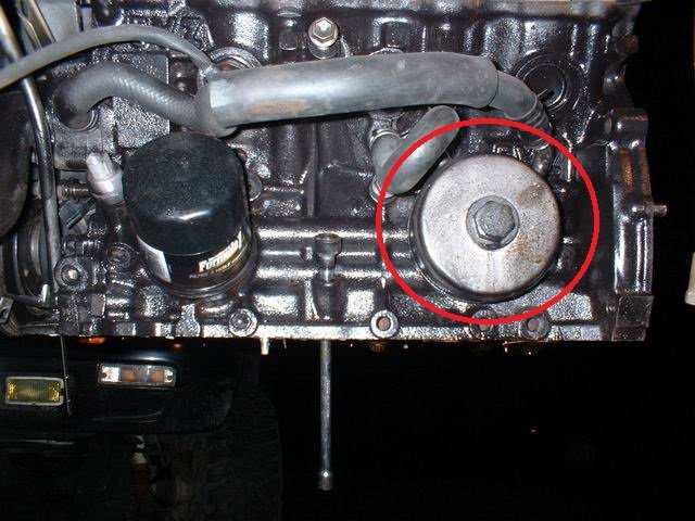

These rigs have an oil cooler on the driver side of the engine. There is a hose that runs off the thermostat housing to that cooler. You might want to just look and see if the oil cooler gasket has failed.......
BamaDrewski, I removed the skid plates again this morning. I didn't recall seeing any type of oil cooler down there, and didn't see one when I looked again this morning. Could you describe where this oil cooler is located?

So this is the oil cooler. I can see part of it some of your pictures and it looked dry. Not to mention, this is the drivers side and your leak is the passenger side.

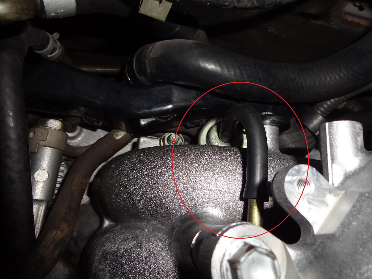

Ok - I just found this. A vacuum line I had disconnected to remove the intake manifold, and since it is way at the back, I didn't see it. It was loose. Inside the red oval in the picture. I am hoping that it being loose screwed up the vacuum system and caused oil to be blown or drawn into the intake manifold.
Does anyone think that one tiny hose being loose could cause that?
