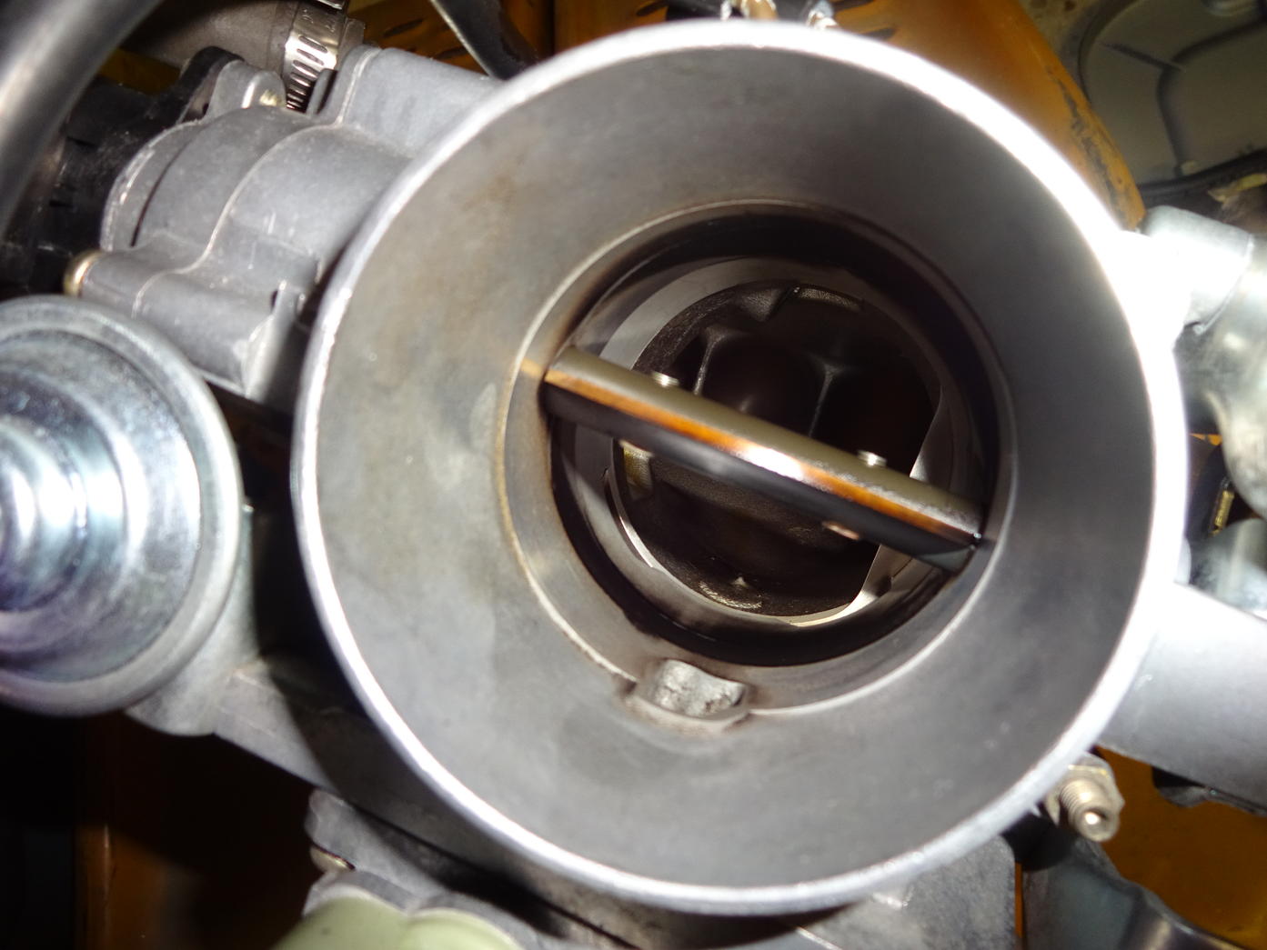

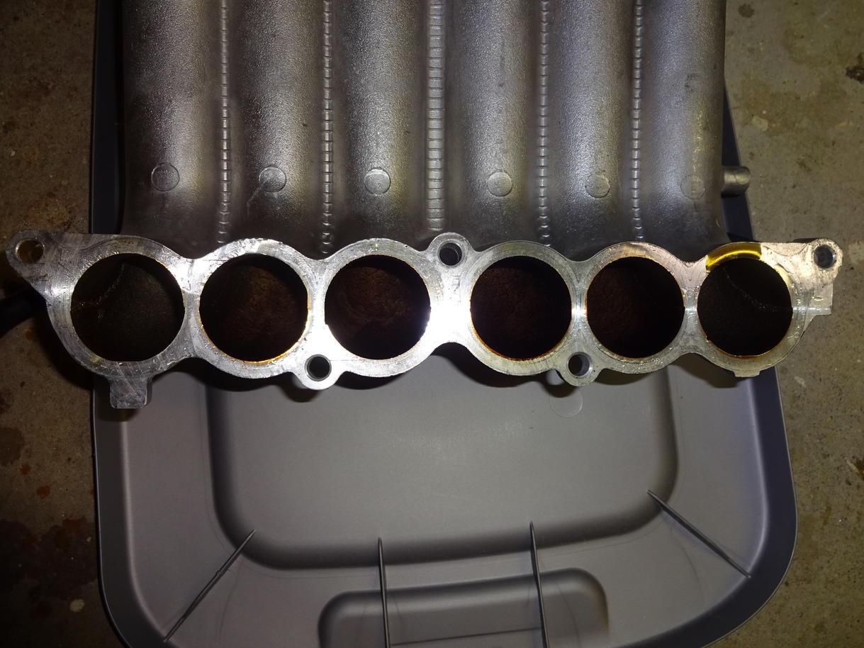

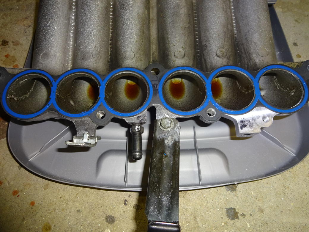

I discovered the cause of the massive white cloud this thing farted after my timing belt replacement: Upon removing the intake manifold, there is a significant amount of oil in all 6 tubes. This was not there during my timing belt replacement. I am rattled now and not thinking too clearly.
What, during a timing belt change, could cause oil to go into the intake manifold?
There is no fresh oil in the tube from the PCV valve to the manifold. No fresh oil in any of the other rubber tubes I disconnected to remove the manifold. How could a large amount of oil get in the manifold?

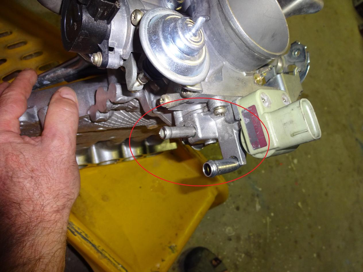

Could it possibly be that I mixed up the 2 hoses that go into the back of the throttle body (shown in the red oval)? They are different sizes, so I don't really think I mixed them up. I don't see any other way for oil to get in there. The most downstream one of the openings from those 2 holes into the throttle body has some oil right behind it, as if the oil came in through there. It's hard to see that in my picture of the throttle body opening.

Regarding my post above, is there any chance this was just a fluke, and my PCV valve happened to fart a bunch of oil into my manifold, coincidentally at a really odd time like this? As you can see, there is probably a teaspoon of oil in each of the 6 intake tubes. I realize it's normal for a little to go in there, but this seems excessive, plus I had that huge plume of white smoke on startup a little while back.
