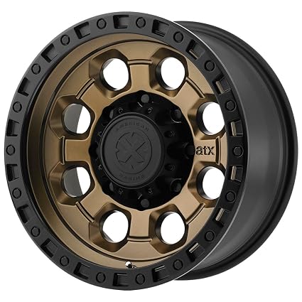

That said, I really like the ATX AX201 but I see that the one that most closely matches the factory specs is the 17x9 6x5.5 -12 offset
will I have any issues with that rim? planning on keeping same size of tire and just adding a leveling kit to the truck.

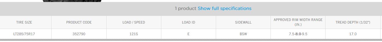

The specific tire you buy should show an approved rim width (see mine below). A 9" wide wheel is right on the outer limit for the stock tire size and might not work with the tires you want. Not to mention additional weight / rolling resistance.
