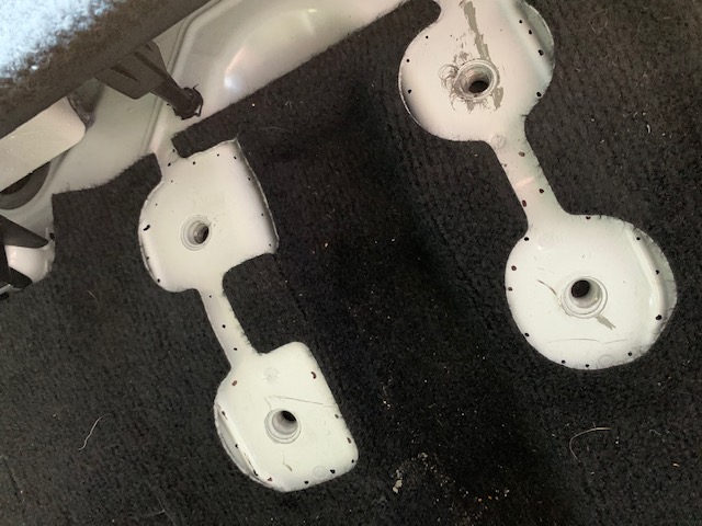

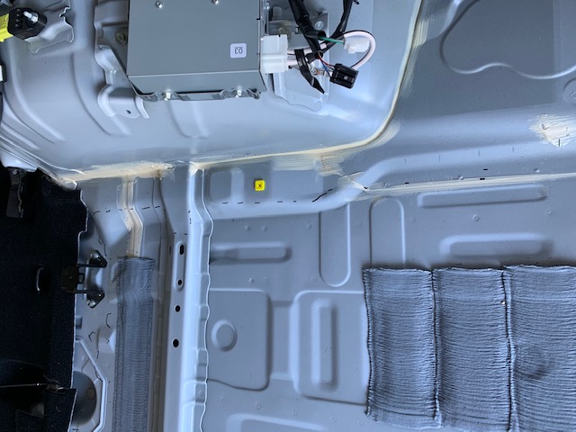

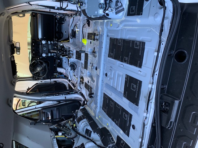

I'm in the process of laying out the CDL and have that covered. My question is around MLV. Through various threads I've seen several people comment that the Luxury Liner Pro MLV (the product I'm using) is very thick and can make getting the carpet and panels on tricky. Additionally, it's also my understanding that the goal is 100% coverage on MLV. I'm contemplating doing nearly 100% but cutting out gaps that match the carpet. In other words, cutting gaps in circles around the places where the seats bolt to the floor and I'll probably also not go quite all the way to the edges to allow side panels in the cargo area to go on more easily. When the carpet was still in I marked the openings and also the edge of the styrofoam base in the cargo area. See pics below. Does anyone who has installed sound dampening, especially this product, have thoughts on this approach.

The sounds dampening is in and front / large carpet piece is installed. Hopefully the rear cargo panels go back on tonight without a massive amount of rework.

You'll be fine with reinstallation. I used Dynamat, which I believe is thicker than your CDL and everything reinstalled without hassle.
personally i'd cut things like that so the seats still sat against the chassis. you're never going to notice that small section of MLV missing in a few areas
Yes, I agree - that's the route I ended up taking. The carpet fits back into all the clips. I'm working on reattaching the rear cargo panels now. The only questions left are torque for bolts and how it sounds. Hopefully the remaining panels that need to go on behave.

I'm super happy with the results. My family noticed the difference as well. One thing I had to do was to shave off 1/4th" around the perimeter of the rear seat mount covers due to the thickness of the CCF and MLV. If I were to do it over, I'd use 1/16" CCF instead.
I'd also budget more for MLV tape. That stuff is awesome. I used it in the hard areas in the end. It was so much nicer than the HH-66 vinyl cement. It is faster and pliable, and not toxic like the cement. The downside is it goes fast and is expensive.
