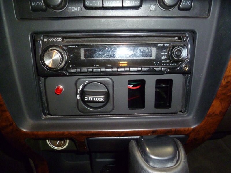

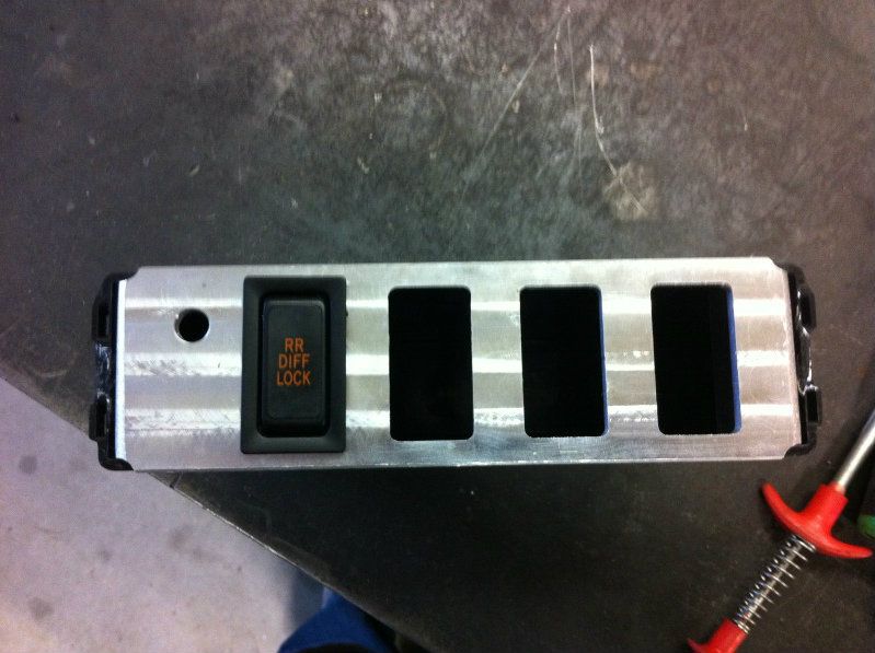

If you have single DIN headunit and no CB below just make a plate for some switches theres rooms for about 3-5 switches depending on what switches you use.
This is my take on it.
IMG_0949.jpg~original
(Take the hole out for the light and you could probable fit a 5th)
P1060668.jpg~original
